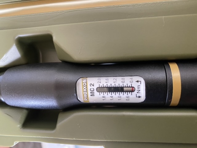

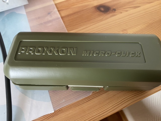

Yes, very fast. Ordered yesterday afternoon… will be using Keratherm, and my used ones have obvious signs of too much torque. This will be a step up for sure.
