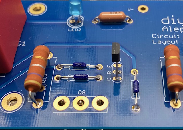

I'm starting to dry fit things, I bought 10mm standoffs, and now I'm worried I don't have enough of the leads from the power transistors coming through the boards. Am I okay, or do I need to order 5mm standoffs? There's enough there to make the connection but....
1. That's fine, just solder the leads properly
2. The leads do not have to bend at 90deg; you could try to feed more of the legs through the eyelets if you bend the leads with some radius.
3. IMPORTANT: tighten the transistors firs, BEFORE you solder them.
