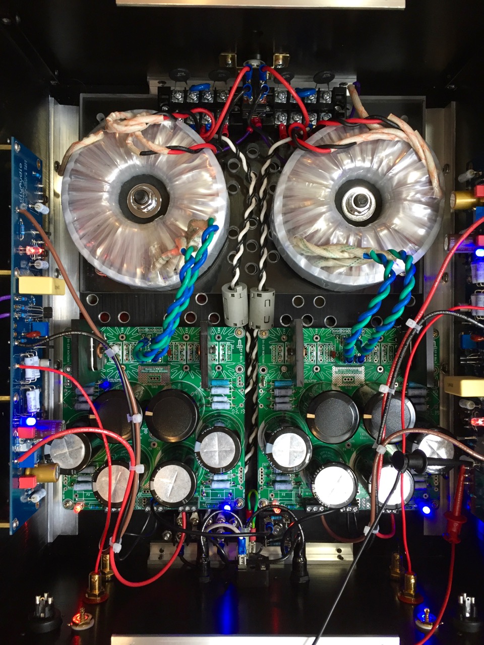

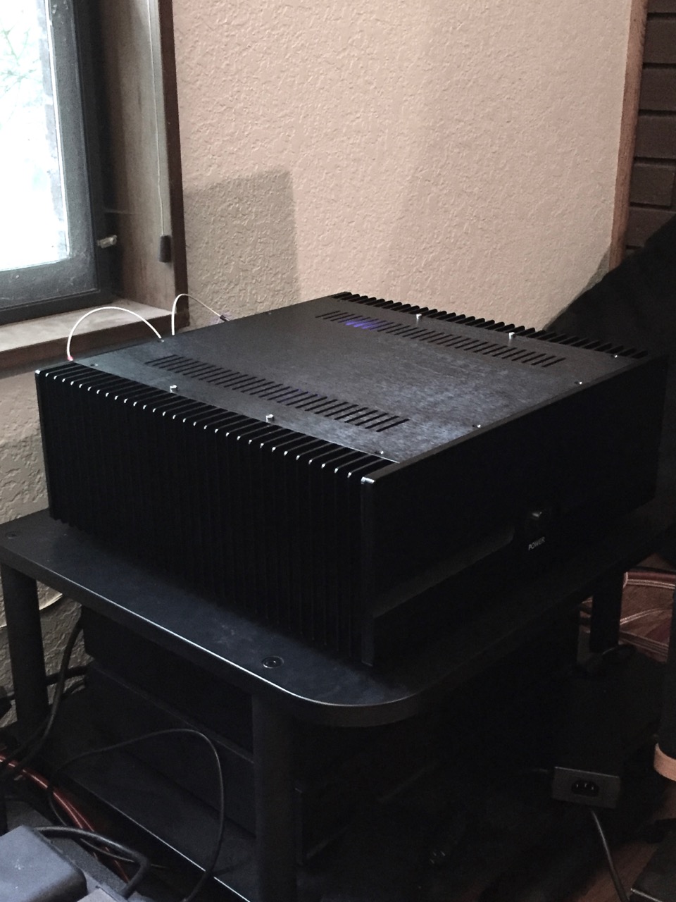

A pair of 300VA, 20V Antek transformers are doing a fine job in my Aleph J. I built dual-mono CRCRC power supply boards, so the higher secondary voltage was put to good use. Bias is around 1.8A per rail. My chassis is 3.5U, 400mm deep and I leave the amp on 24/7. Bias could be set a little higher according to the heatsink temperature, but the amp sounds so good that I'm not messing with it anymore.
Wow a dual mono fits in a 3.5U chassis and you get enough cooling? What chassis are you using?
