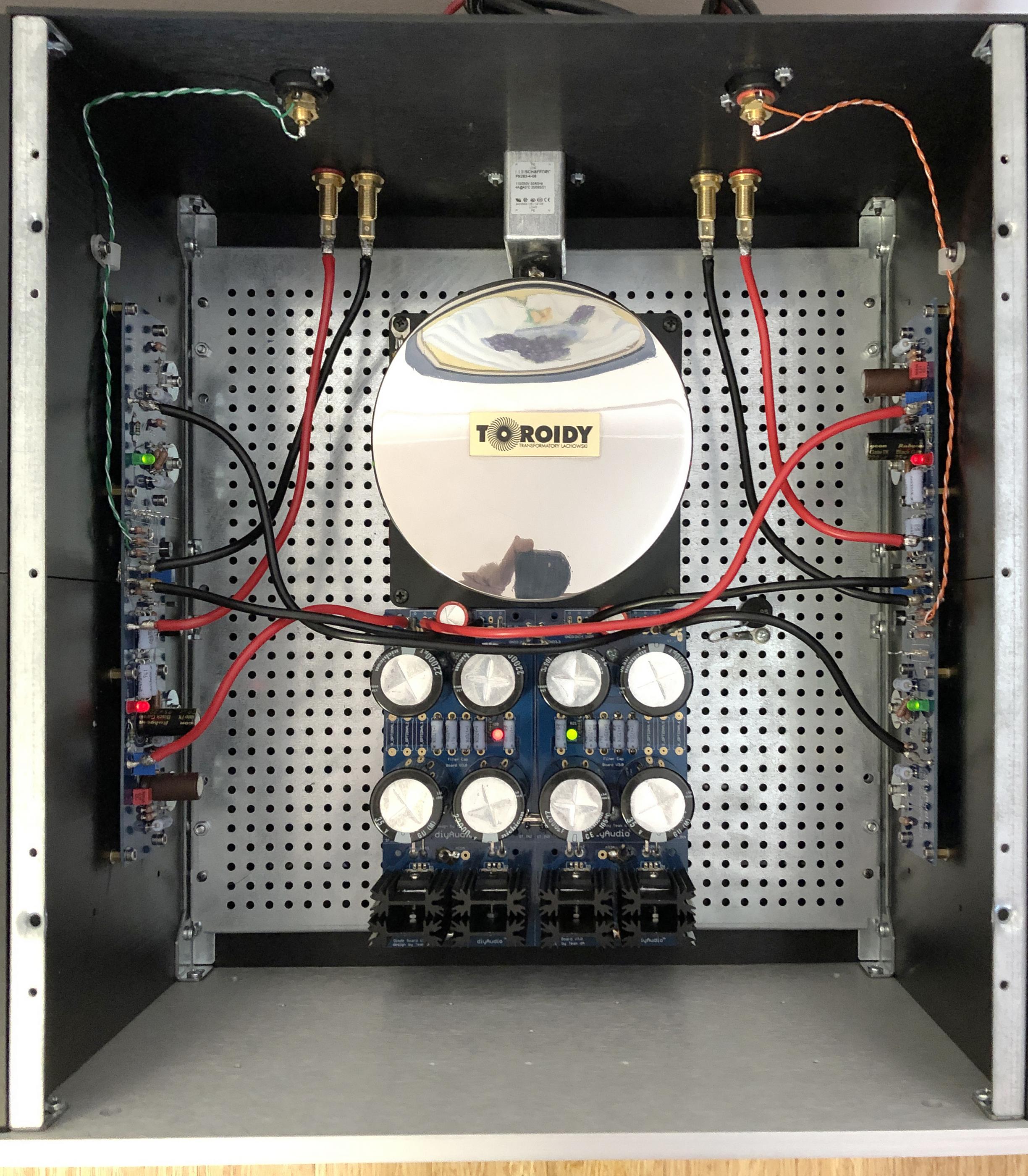

I've ordered most of my parts for the amp boards, and am moving on to the power supply. I'm building a dual mono set up with 400VA 20V transformers. These are the caps I think I am going to use: link
27000UF 20% 35V, 105C, 5.3A ripple.
Am I on the right track?
They seem really nice. A lot of capacitance in 35mm X 52mm package.
Make sure you go big in chassis size with 2 X 400VA transformers.
Try to position the transformers and the PS PCB in such a way to minimise the AC wiring length, as well as DC hook-up wiring length.

I was thinking along these lines for power supply caps, Nichicon 15,000 uf, 30mm, 105C, 35V. This would be for our more plain vanilla build with a single transformer, rather than dual mono, good for transformers with either 18v or 20v secondaries.
Any thoughts on pro/con on going for 30mm vs. 35mm caps (crowded on the board, harder to solder?), and whether extra capacitance (27k vs. 15k) would really make a difference (First Watt used 15k uf caps, no?)?
As between 30/35 I don’t think there’s a difference in available room or soldering. Will more cap make a difference? I don’t know. From what I’ve read it might so...cost isn’t huge to use more and I’ve not heard of any downside. I’m sure there’s a point of diminishing returns and as you said the stock 15k is probably perfectly fine. Of course stock is built to a price point and so as a DIY you *might* have an opportunity to improve.
Generally speaking, rated ripple is directionally proportional to the can size.
27K vs 15K is almost twice the capacitance, there will be a noise difference that's measurable. Wether or not that makes an audible difference is debatable.
