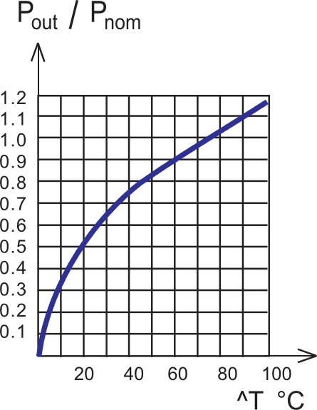

pico, where did you find this curve?

I got the graph from one of the good transformer manufacturers found in a technical document.
Might have been Plitron, Avel Lindberg, or Nuvotem Talema.
My Avel Lindberg transformers run around 4 degrees above ambient. (500 va per channel)
