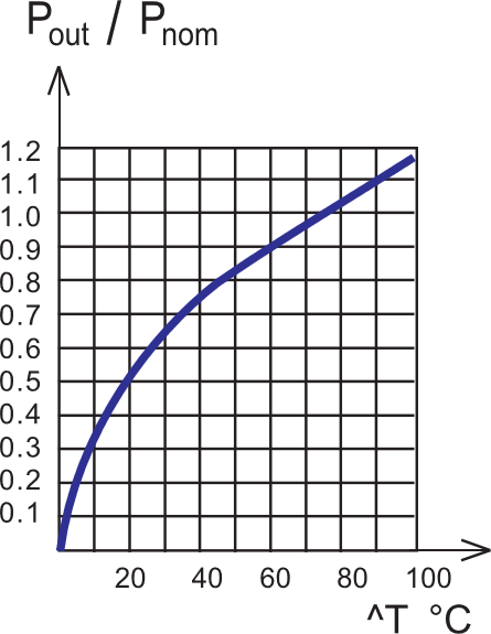

Just to illustrate my previous point I thought adding this graph might be helpful.
From the graph you can see running a transformer at around 65% of it's rated VA (Power) leads to a rise of 30 degrees above ambient.
If the case temperature is 40C the transformer will be at 70C. That is bloody hot.
This will also affect the cooling efficiency of your heatsinks etc.
Best keeping the transformer operating at 50% or less of it's rated output.
I generally go with a VA rating 3x greater than the amp circuit draws (operating at 1/3 for 10C rise above ambient).

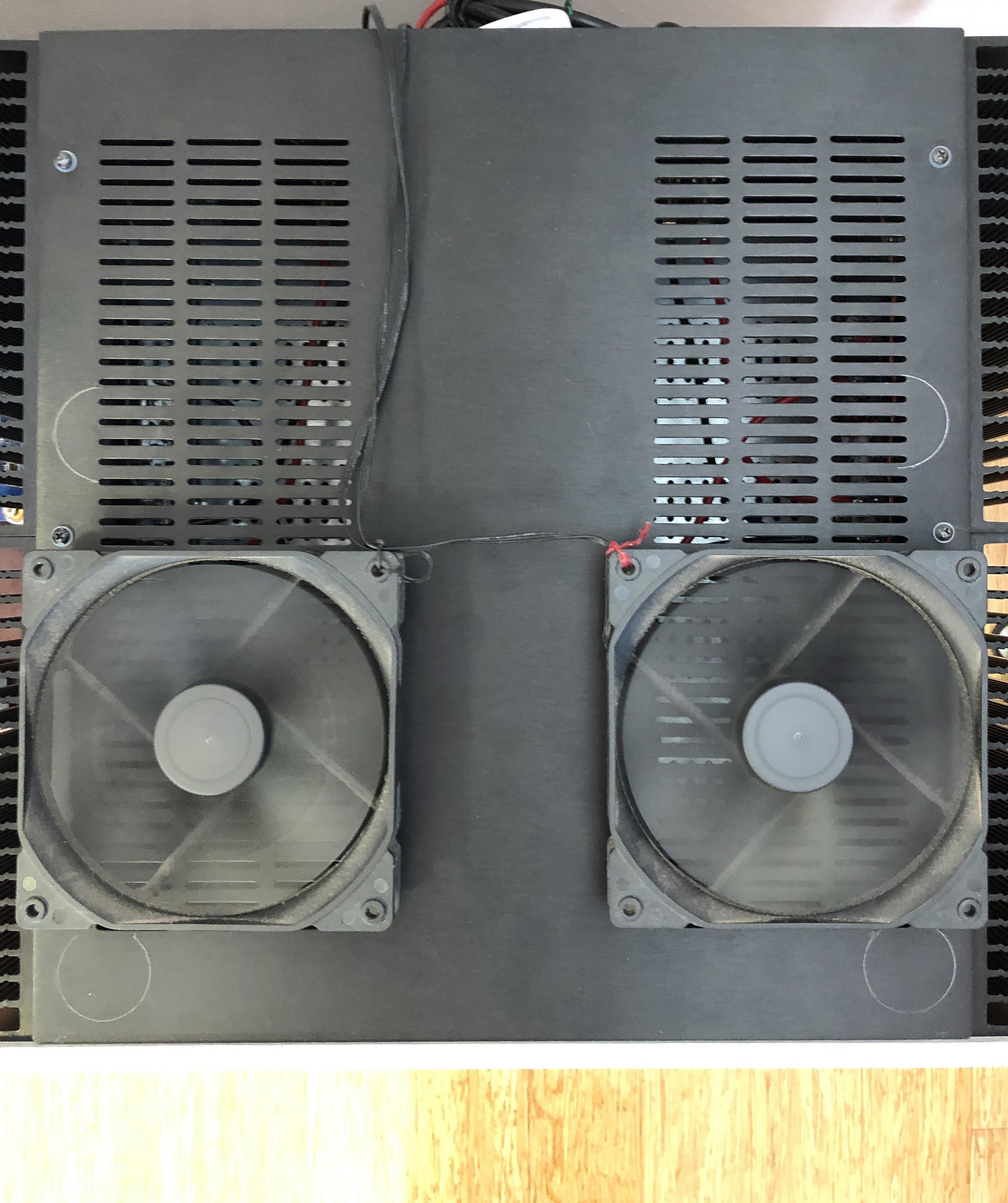

For additional peace of mind, I use two Fractal Design Dynamic X2 GP-14 fans. I run them at 10V DC (instead of 12) - they are completely quiet. Most of the airflow goes inside to cool the interior; a portion of the total airflow is "refracted" from the top plate and cools the heatsinks from the outside.
I leave the fans on at all times during the summer period. No need to run them during winter.

Oops, I already ordered the 300VA/20v Antec. Sigh. I believe @alanhuth has the 400VA/18v Antec, so when we two are finished, we will be able to empirically test your advice in the 4U Deluxe. I suppose I could rig a fan if it gets too hot in there, like @Extreme_Boky.

Fans should be a last resort. You could certainly use a fan temporarily though.
