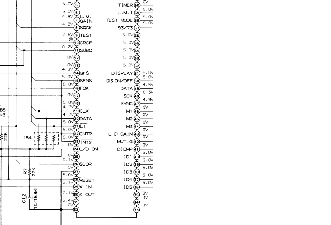

Very hard to say as it looks like it's been cut and scraped away between the pins with something sharp.
I'm surprised I didn't notice this before when I removed the MCU from it's DIL socket and soldered it directly into the board.
It's now linked to pin 22 as shown in the schematic but I can't be sure what is correct.

MCU pins 22 and 23 are also connected to MCU pin 15. These 3 pins share a 100k pullup resistor. They also connect to a pin on the CXD1135 labeled "SENSE." The service manual says this pin is an output from the CXD1135Very hard to say as it looks like it's been cut and scraped away between the pins with something sharp.
What is the purpose of this signal?
There's a section in the service manual describing all the pin functions for the MCU. It's page 38 of the .pdf file I have. It states MCU pin 23 (\INT2) is "not used."
The logic state of MCU pin 23 might have no effect on the oscillation problem. But it's wise to consider the signals on every pin of the MCU just in case there is something really odd happening. One way to check would be to see if any other MCU pins are following the state of of the "tray oscillation mode" signals(e.g. synchronized with them).

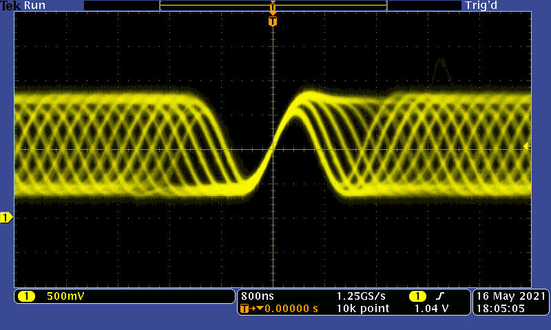

With that excellent DSO you should get some images of the eye pattern from the RF test point.
I hooked my works DSO up to the relevant test point before I reluctantly take it back tomorrow.
I 'persuaded' the CD73 to play a disc by cycling the power until it loaded. Screen capture attached.

Switching the power quickly sometimes keeps the cd loaded and start spinning but it doesn't appear to be playing. It doesn't read the TOC. So it is possible my unit also have a pickup issue 🙁 Haven't checked if laser fires up yet.
And the reason I haven't checked "the laser" is this. I thought that maybe if one of the motors is too stiff - it may cause issues pulling too much current and possibly causing voltage to drop. So I tried to add a drop of oil to both loading and clamp motor shafts and run them off 9V for a bit of time to let the oil get in.
Here is where I possibly killed my motor driver IC8... rookie mistake. With unit powered off I connected 9V lab power supply directly to clamp motor without checking the polarity. and BOTH loading motor and clamp started to spin. Not sure if it's normal, haven't analyzed the internal schematic of the IC8. I then unplugged the motors from the PCB and let them separately run off 9V for about 30-45 seconds each. Also added some silicone lube to the clamp gear.
After assembly, the issue was of course still there (would be too easy, after reading 18 pages of this thread), the sound clamp motor +gear make gotten much quieter due to lubrication. However, I now got myself the same problem as Andy had with wrong motors (only I did not change motors) - a smoking R71. I've powered off the unit when noticed the smoke. Did try one more time to identify where the smoke is coming from. The motors still operate but R71 (and probably IC8) are getting very hot very fast so I cut the power after ~5-7 seconds.
So yes, there are people out there who read every single post in this thread, and yes, AKAI CD-93 is also cursed. I will try my best to help Andy (and myself 🙂 ) to resolve the problem. Of course Andy has been dealing with this literally for months (years?) , huge respect for your perseverance. Not sure how long will I last, but will try.
Things like that are easily done. It's quite likely applying voltage has zapped the drive chip and tbh worst case scenario is that it allow a reverse polarity to appear across the rail that the drive chip runs on. That said you would be unlucky if that caused further issue beside the drive chip. I bet there are diodes in the chip output across the motor feed to suppress back spikes and so with luck they protected everything, even they themselves fail short.
Something I just thought of... did I mention it earlier, not re-reading it all though... is to look with a scope of the output ports of any uP or syscon chips that are not changing state as expected and look closely to see if there is a minute change in level indicating a failed output stage on the port.
I remember once a VCR that had something like that. A port was stuck but did shift a few hundred millivolts. It was a one off but we fixed it by using a couple of transistors to restore the levels. It was a bodge and the customer knew and was happy for us to do it. There were never any comebacks from it.
