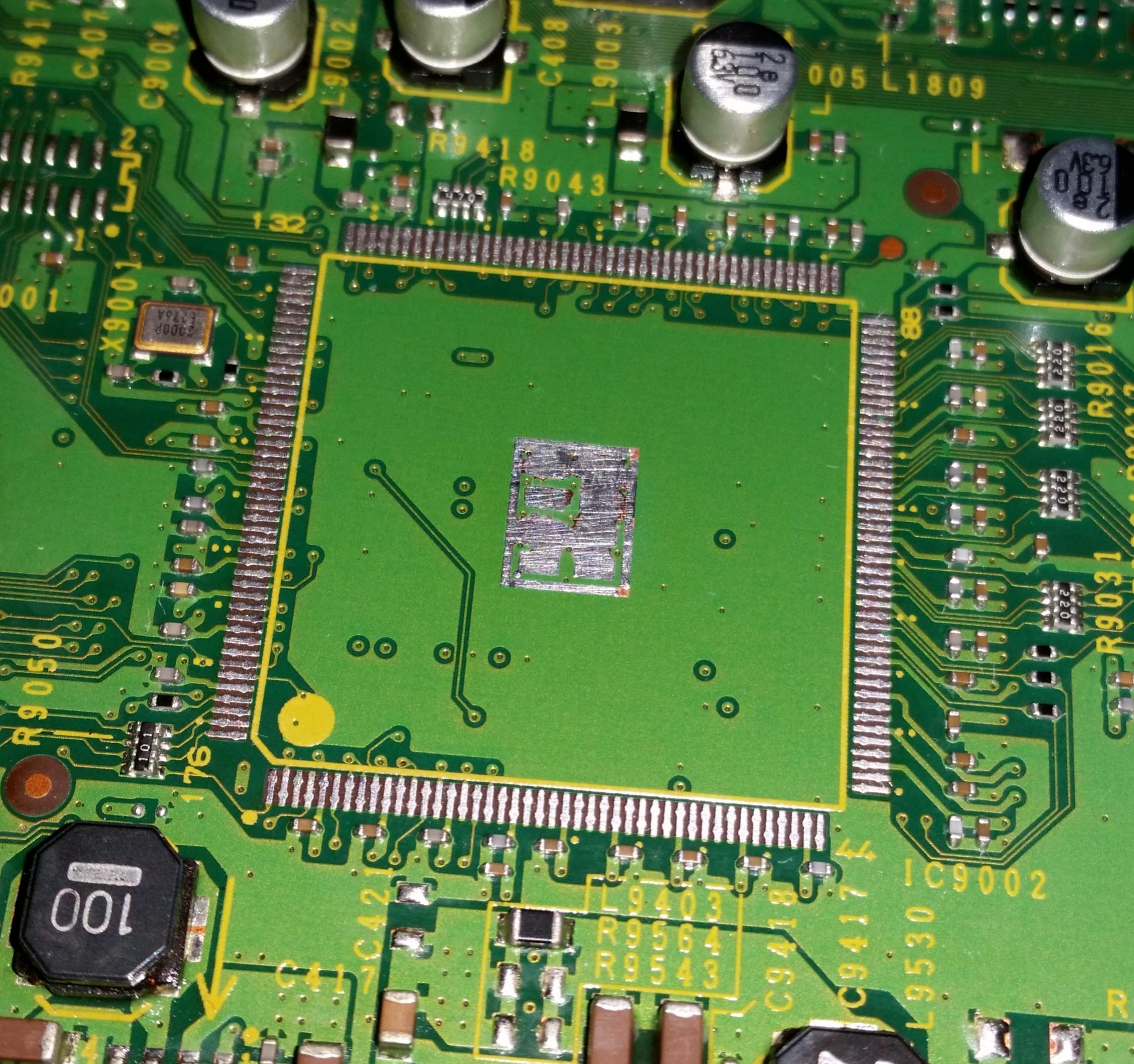

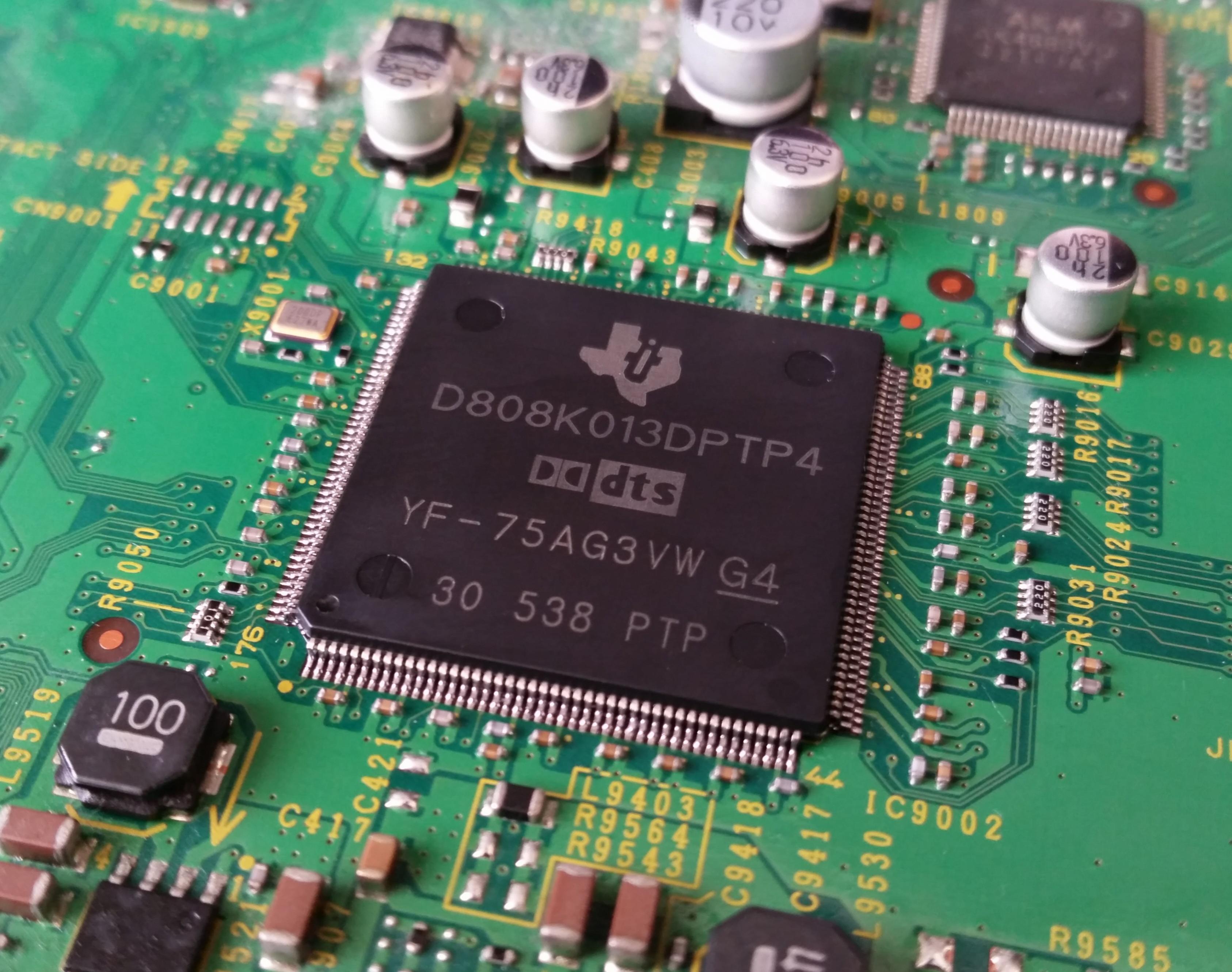

Removing BGAs is easy enough but fitting a new one is more of a challenge. I have an 858 heat gun too but the air flow needs to be reduced to stop it blowing the chip around. Liquid flux isn't great either as it bubbles and again the chip moves. I now use tacky flux in a syringe which is much better and helps hold the chip in place. I bought a reballing kit but although I have managed to physically place the new solder balls you need an IR oven to melt them so they're attached properly without moving.
With the larger QFP devices that have a ground tab underneath, I don't try and remove them in one go. I use a scalpel to gently cut all the legs close to the chip body and remove them with some flux and a fine solder tip. Then I heat the middle of the chip with the hot air gun and pry it away as the ground pad solder melts. That saves any pad or track damage.

I also bought a faulty old truck sized Onkyo - the TX-NR807, as one of my first repair projects. Unfortunately it used the earlier 300Mhz D830K013BZKB3 chip, which is obsolete and can't be replaced with the later 400Mhz ones.
I reflowed it - luckily it works again and the service menu shows it has only 4500 hours logged on it. I decided not to sell it on as it will probably fail again at some point and it's impossible to say when. I'll probably wait til that happens and maybe have a go at reballing it with leaded balls.
The QFP DSP in my photo is one I fitted this week to a VSX-922 and was sourced from a seller on eBay called e-best_trade. I've bought lots of semiconductors from him and all have been good quality at low prices. I inspected this one under a microscope and it isn't a fake or remarked device and works well now its fitted. The 'D' suffix chip can be used to replace the earlier 'B' or 'C' ones that suffer premature failure, although you're probably aware of that.
