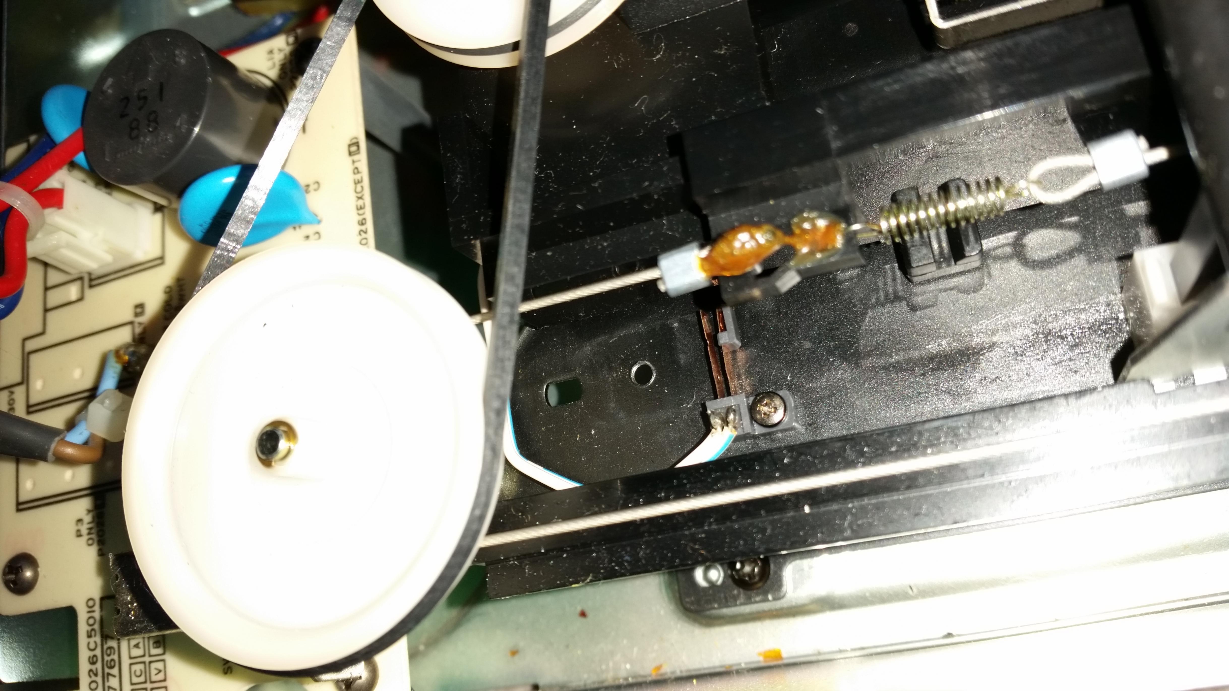

I had a close look at the tray closed switch and took some photos. It has no option for adjustment other than bending the leaf switch tabs. It is triggered by a lug on the side of the tray which again isn't adjustable in any way.

I suggest temporarily connecting jumper wires from the “leaf spring” tray switch MCU inputs over to the “optical” tray sensor inputs on the MCU. In other words put the same signals on both sets of MCU inputs.
This will permit testing it in both the CD-73 and CD-93 modes.
Hopefully the signal polarity is the same (logic low for end-of-travel). If not you will need an inverter or two.
It’s curious that the CD-93 retains the leaf switch for “tray open” in addition to having an optical sensor for “tray open.” Akai may have done that to permit the user to push the tray in a tiny bit to initiate a “close” cycle. Most disc players support pushing the tray in to cause it to close.
If the tray moves too fast in CD-93 mode you could keep the collector of the speed control transistor grounded to make everything move at a more leisurely pace. It probably wouldn’t cause any problems if the clamper moved more slowly. My guess for why Akai made the tray motor spin more rapidly on the CD-93 is because it has an extra stage of motor RPM reduction with 3 belts rather than 2.

There are a total of 4 leaf switches. Could there be a hidden interlock which connects the tray section to the clamper section in some bizarre manner? I’m thinking about a tiny plastic tab somewhere which might crack or fall off.This backs up your theory that the CD73 is looking for more than a 1-0 state when closing but I can't see how the single switch and single lug on the tray cound generate a 1-0-1 signal.I think one of the CD-93 photodetectors will generate a signal when the tray is "almost closed" and then the other one (or both of them) will generate signals when the tray is all the way closed.
Your photo of the end-of-travel switch for the tray leads me to think this switch doesn’t close until the tray nearly hits the backstop and then it should stay closed. I didn’t see any bumps or cams which would cause this switch to do anything other than a single “open to close” transition.
I really don’t have a clue about the clamper system. I’ve never dealt with a disc player with more than one motor to operate both the tray and the clamper.
