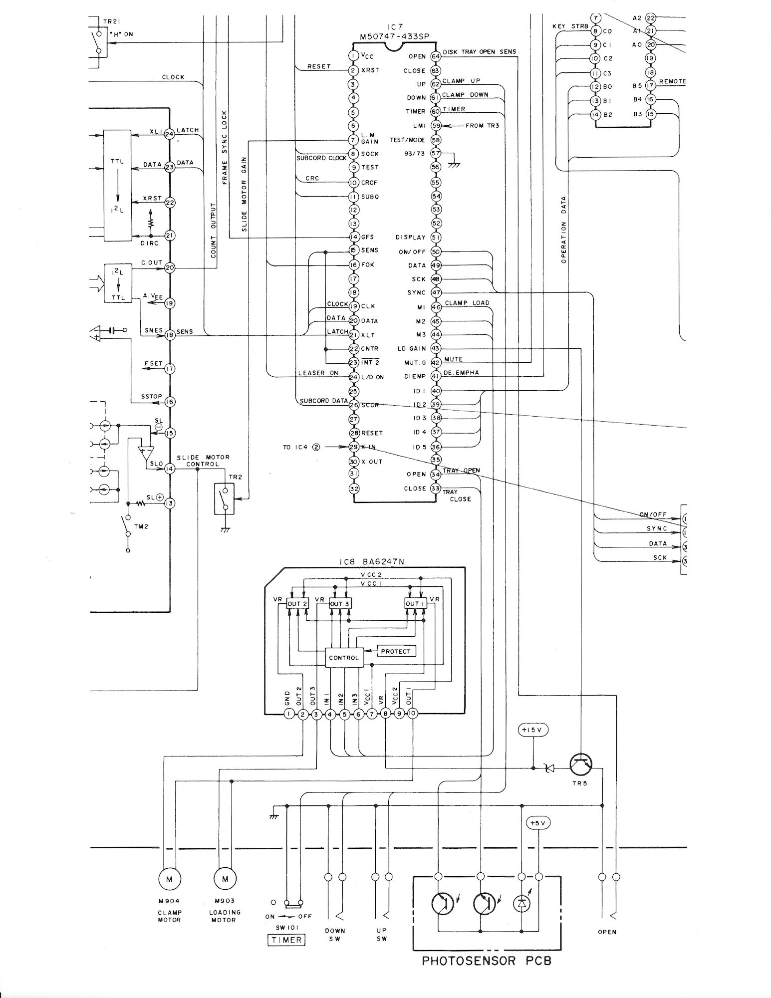

I looked at the datasheet for the BA6247 motor driver IC. This is one wacky device!
View attachment BA6247FP-Y,BA6238A.pdf
It contains "1 1/2" H bridges. Not 2.
Because of this it can only drive one motor at a time.
The "Vr" pin seems extremely important because the analog voltage at this pin determines the rotational speed of the motors.
One of my theories is that the motors should rotate more slowly.
Finding a way to reduce Vr could accomplish that.
-EB

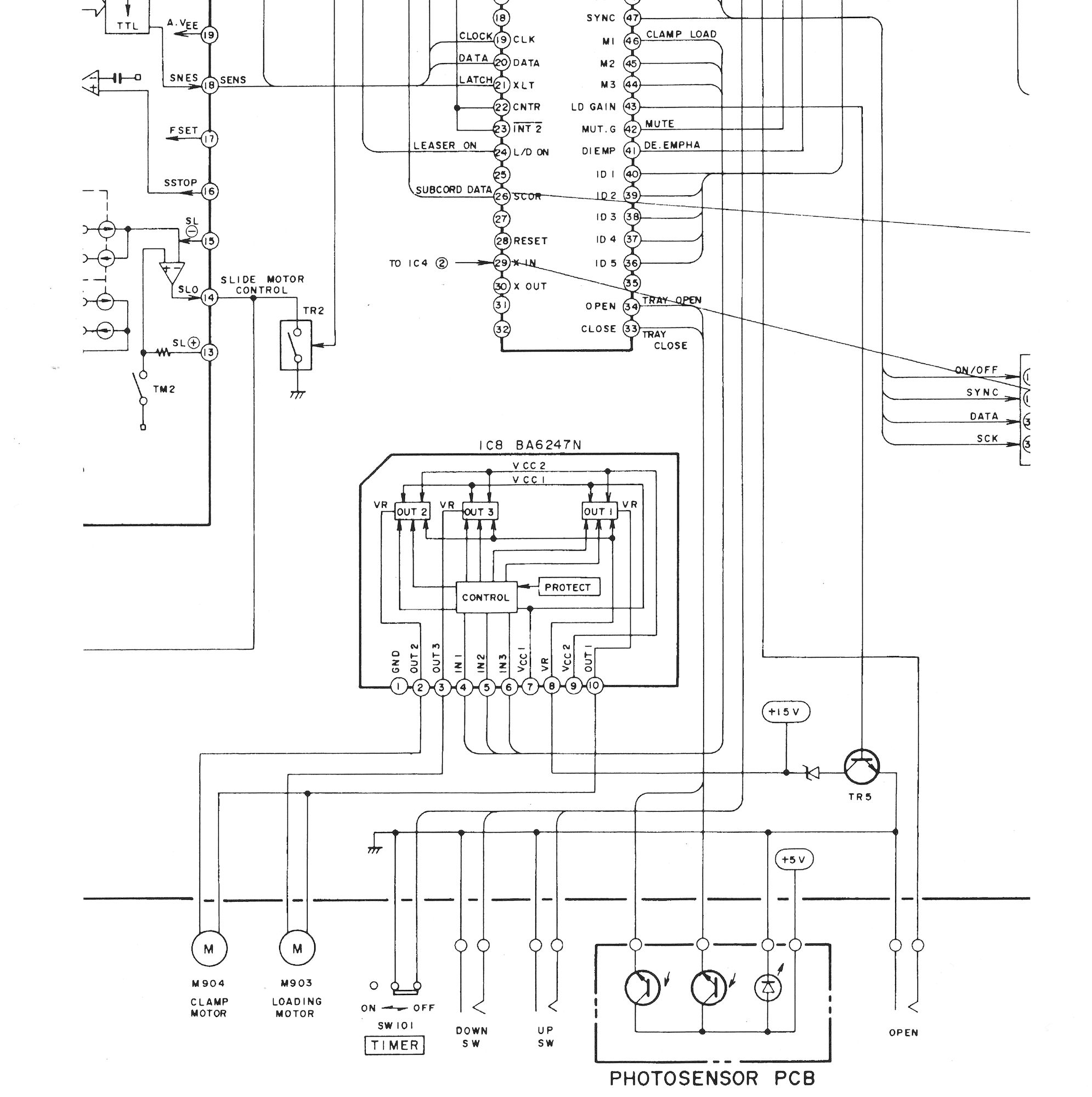

The motor drive chip is a BA6247 and the circuit is as shown in the data sheet except the Vr (pin 8) signal. This is normally set at just over half + supply volts but Akai are controlling the voltage at this with a transistor and zener diode driven from the micro. I tried changing this to the simple two resistor divider but again it made no difference.
I want to learn more about this "transistor and zener diode" connected between the MCU and the BA6247. The root cause of both the tray and clamper oscillation may be tied to this: Vr (pin 8).
According to the BA6247 datasheet the Vr pin is "pulled high" when unconnected (open circuit). This applies the full 12V to the motors to run them at full speed.
To reduce the output voltage and slow down the motors, Vr must be pulled down to a somewhat lower voltage. If Vr is grounded then the motors won't get any voltage.
Perhaps the "transistor and zener diode" are supposed to reduce the motor voltage at "end of travel?"
What signals and voltages are present at the MCU pin which connects to this "transistor and zener circuit"?
Use an oscilloscope with DC coupling to view it.
Then press open/close button to start the tray into motion.
Does the logic state of this MCU pin ever change?
-EB

How many versions of the Akai CD-93 model exist?
Evidently one version has an LED/dual photosensor module in addition to 3 (not 4) mechanical leaf-spring switches for detection of tray position.
The schematic in the service manual I just downloaded from hifiengine shows this LED/photosensor module and it also shows 3 (not 4) leaf switches:
The lower section of this schematic requires careful interpretation:
First of all the box showing +15 at the Vr pin (8) of the motor driver is totally incorrect. There must be no connection to a power supply rail here. Perhaps they were suggesting this voltage would be close to the VCC rail voltage of the driver IC when the motors are resting (not running)?
Because the Vr pin has an internal pullup it will rise to a value close to the VCC of the driver IC when transistor TR5 is switched off.
But when the MCU commands transistor TR5 to turn on, then Vr should be pulled down to the zener voltage of the (unmarked) zener diode. Unfortunately the zener diode isn't labeled on the schematic Sigh... Old schematics were often less than perfect. And they are still like this today.
The voltage of this zener diode must be identified. This can be done by temporarily connecting the collector of TR5 to ground with a cliplead. Doing this should reduce the voltage at the Vr pin. Power must be applied to the CD player to measure this. The CD player should be in a resting state where none of the motors are running.
Also, what is the VCC voltage at the driver chip power input pins (7 and 9)?
Oddly the schematic fails to show any connections to these pins.
Next a visual inspection of the transport mechanism must be conducted:
And exactly where are the 3 leaf-spring switches located?
I would assume that "down sw" and "up sw" apply to the clamper mechanism.
And that "open" detects tray position.

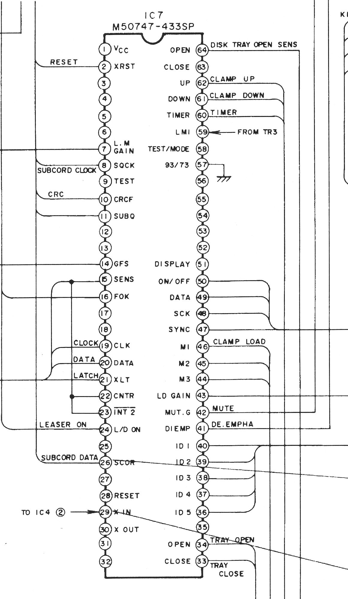

Finally let's take a closer look at the MCU:
Pins 61-64 detect the leaf-spring switches.
When a switch is closed then the corresponding MCU input pin should be at ground potential.
The MCU has internal pullup resistors which should pull all 4 pins up to the MCU VCC (probably 5V) when the switches are open.
Occasionally an internal pullup resistor fails. No problem: Add an external pullup (usually 4K7 ohms) to fix it.
Note: There is an unconnected pin 63 labeled "close."
I assume this would get used for a model that has a mechanical "tray closed" switch rather than the LED/photodetector sensor. If there is a mechanical leaf-spring tray-closed switch then it probably should be connected to pin 63.
There is a different set of MCU input pins for the LED/photosensor module. These are pins 33 and 34.
When light is falling on the photosensors this should cause a logic high level on these 2 pins.
When the light is interrupted the pins should be at logic level 0 (near ground voltage).
No external pulldown resistors are shown. However it's unusual for an MCU to have an internal "pulldown" on an input pin.
If this player has the LED/photsensor, then both pins 33 and 34 must be checked to make sure they swing all the way from logic low to logic high when the photosensors operate.
If there is no LED/photosensor present in this machine then its likely pins 33 and 34 should both be connected either to VCC (5V) or to ground. I'm not comfortable with "unconnected" input pins on an MCU.
Well, all of this should be enough to keep us busy for a while and out of trouble...
-EB
What is the voltage at Vr pin with TR5 collector grounded?
What is the voltage at Vr pin with TR5 collector open?
Does this LED/photsensor device actually exist?
It is labeled "PHOTOSENSOR PCB."
Therefore a tiny PC board should be present somewhere inside the transport mechanism.
It should be located in such a way that it can detect both "tray open" and "tray closed."
Is anything actually connected to MCU pin 63?
-EB

<<I looked at the datasheet for the BA6247 motor driver IC. This is one wacky device!>>
This is certainly in keeping with the Rube Goldberg design that Akai I have chosen to implement! 😀
Looking at the CD73 schematic, the zener (D19) on the Vr pin of the motor controller is HZ6A2, which is rated at 5.3V to 5.6V, so the motor supply voltage is being dropped to roughly half supply when the transistor is switched.
I need to get my scope on this point and see when and if it is being energised in the loading/clamping sequence.

My take on the schematics is that this zener is either 5V or 6V. Today's standard values are 5.1V, 5.6V, 6.2V. Of course there's probably nothing wrong with the original zener.Looking at the CD73 schematic, the zener (D19) on the Vr pin of the motor controller is HZ6A2, which is rated at 5.3V to 5.6V, so the motor supply voltage is being dropped to roughly half supply when the transistor is switched.
Take a close look at the detailed schematic on page 26 of the service manual. It's the same page for both models (CD-73 or CD-93).
There is also a 2K2 resistor (R59) between the MCU output pin "L.D gain" which is pin 43 on the MCU and the base of transistor TR5. With this series resistance the MCU output pin should rise above 3V if/when it tries to slow down the motors by outputting a logic high signal.
-EB
