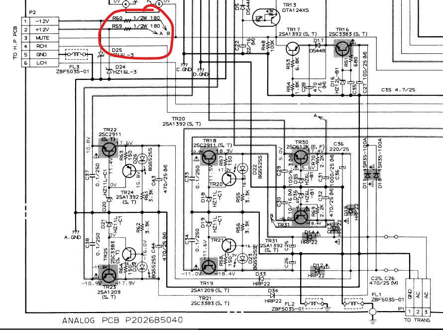

If those are regulated rails then that ripple is massive. The 5 volt rail, if that is the main 5 volt supplying the uP etc should have ripple in the single millivolt region or lower.
Raw unregulated supplies will have considerable ripple though.
Edit... I've just pulled the circuit for this one.
The output of the two regulators producing the -/+5 volts should be super clean. No visible ripple should be present as measured across the caps at the output of the reg.
The input side of the regulators (the 3300uF caps) will have ripple on them.
I can see lots of simple discrete regulators on that circuit. You need to check they are all OK under load (motor) by using the scope. Check both DC value and ripple. Look for dries on all these parts and the two 78/79 regs.
Check the 180 ohms feeding supplies to these. They look a typical potential problem spot.

The motor drive is fed direct from the unregulated 12V and has over 600mV 100Hz sawtooth ripple, which can't be good.
The output of the 7805 has about 100mV on it but it was replaced with a new one last time I worked on it.
I get a feeling of deja-vu with this as it was my eureka moment last time , so I pulled the regs and fed the rails from external bench supplies. It didn't cure the problem unfortunately.
I'll investigate further and check those 2 x 180Rs.
#Edit - a quick look at the schematic shows mine to be slightly different as its the CD73. This analog board is actually disconnected at present as the digital board works without it and access is easier.

TR30 & 31 don't exist in the CD73, so I think you may still be using the CD93 schematic, which does have some significant differences. One that stands out is they use optical devices for the loading tray.

It was a CD93 circuit I was going off.
