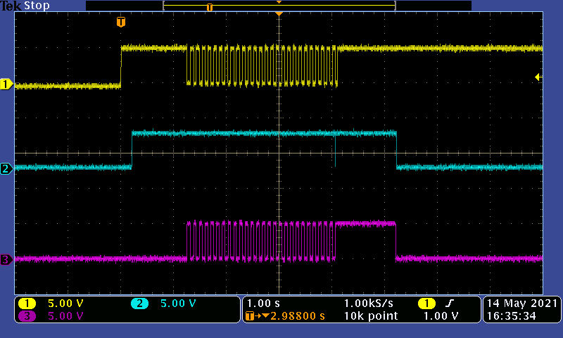

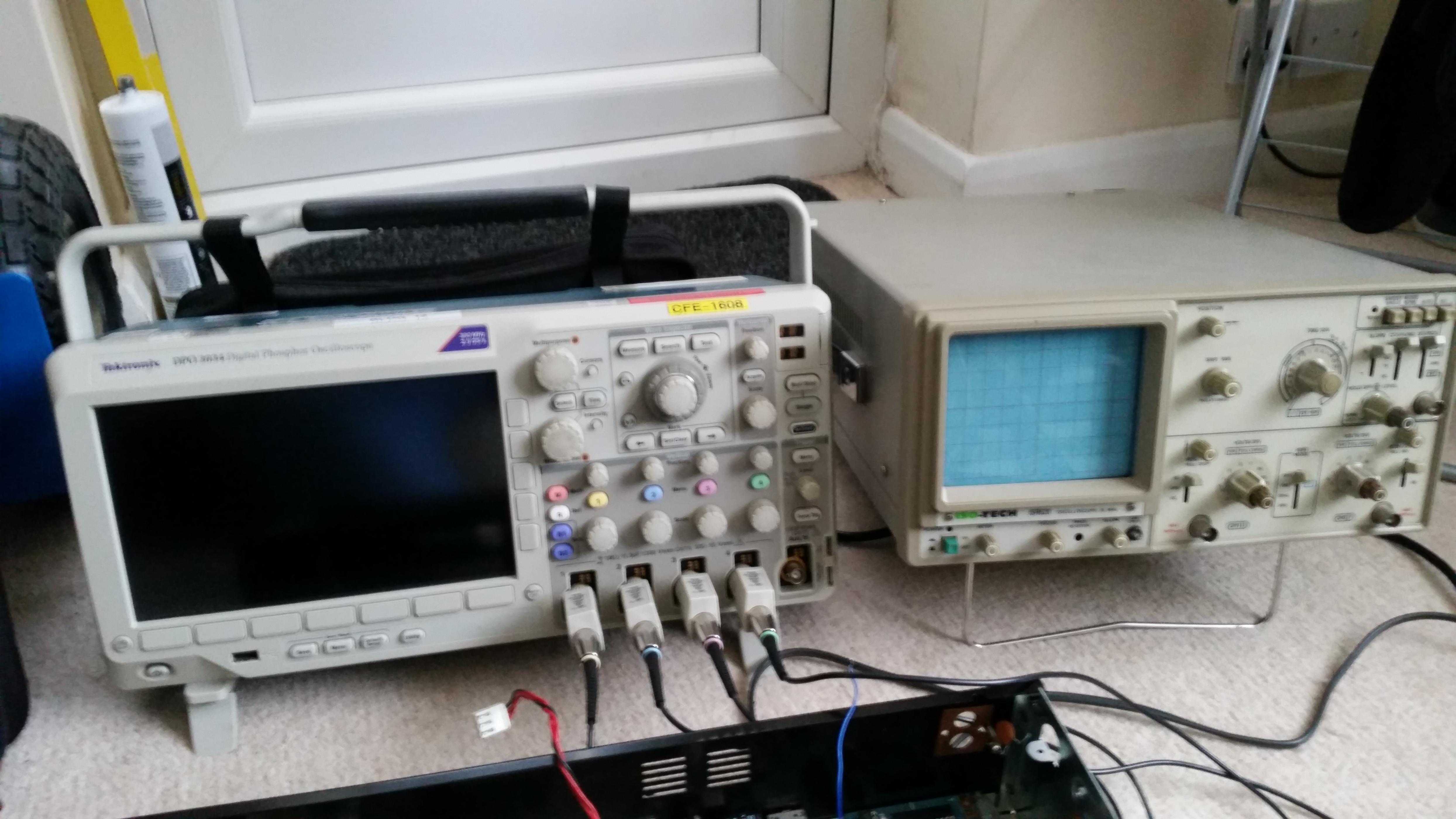

I have borrowed my works Tektronix 4 ch DSO for the weekeend (talk about taking work home...) so I can look at the tray/clamper operation in more detail as well as anything else.

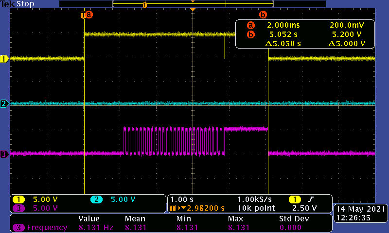

First is are the 3 motor control lines, M1 - yellow, M2 - blue and M3 - purple.
Pic 1: Tray closing, oscillating and opening with belts in place
Does that scope have 3 channels or 4?
Actually 3 channels might be enough.
With belts installed look at these 3 signals:
1) Tray closed switch
2) M1, the on/off control input to the motor driver IC for the tray motor
3) M3, the direction control input to the motor driver IC
For now I’m ignoring the clamper because (to the best of my knowledge) it does nothing until the tray operation is completely finished.
-EB
-EB

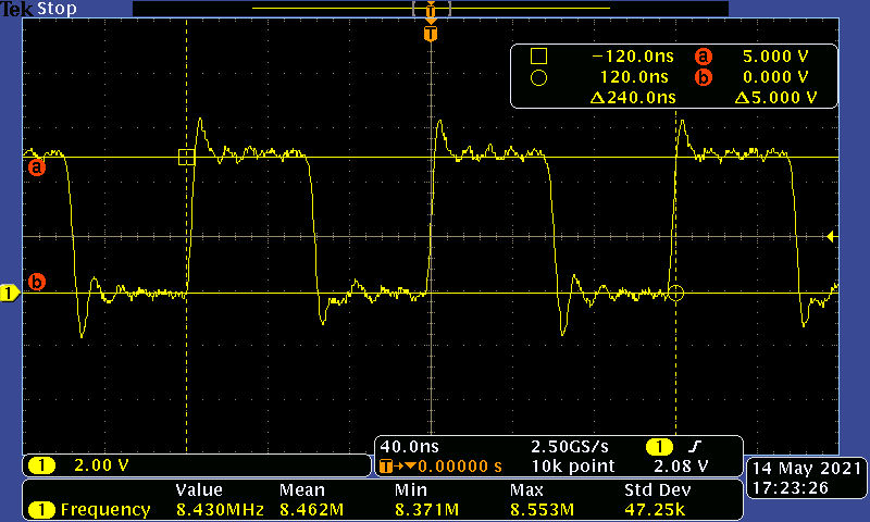

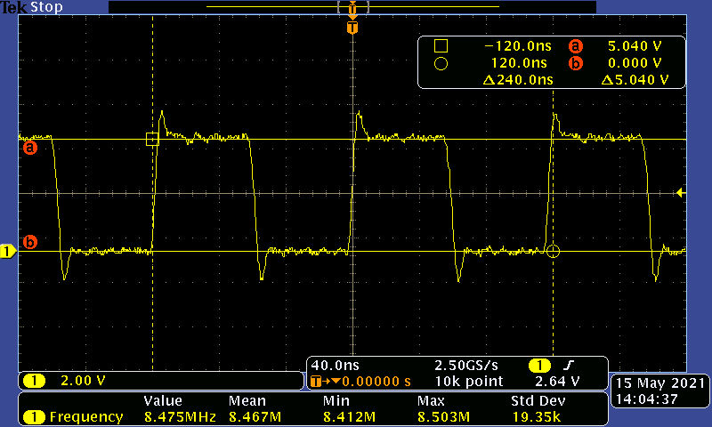

MCU clock input frequency is specified in the service manual as 8.(something) MHz. It should be a totally clean stable square wave at standard logic levels for a 5V VCC supply rail.I will take a look at the MCU reset/clock signals later and upload.
Any other suggestions welcome while I have a decent scope to hand.
At power-up the clock must be stable before end of /RESET.

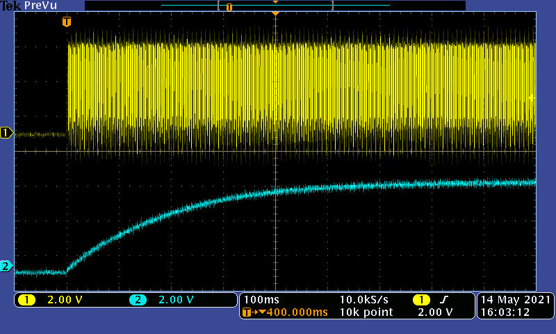

I've captured the clock signal at the MCU and I'm not sure it fits your description of totally clean stable square wave at standard logic levels... could do better I think! The rising and falling edges are well defined but the logic levels, particularly the low side is poor.
#EDIT: Frequency using the scope to measure is 8.453Mhz
The reset signal looks good and the clock is up and running in good time.

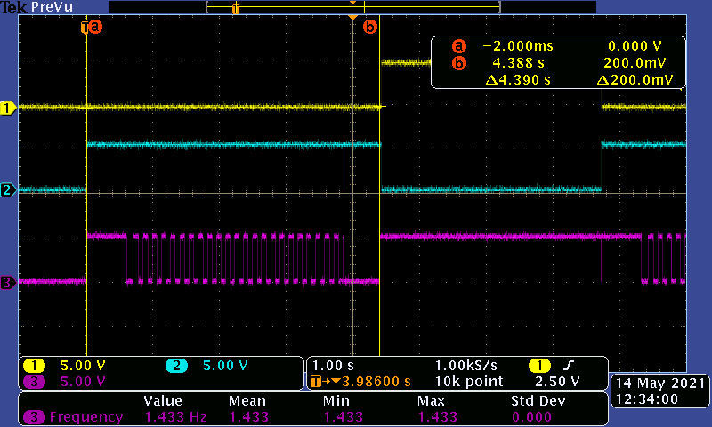

I've captured the tray closed switch (yellow) M1 (blue) and M3 (purple. Screenshot attached.

I've traced the clock signal back to IC4 and IC3 and it seems to get noisier at the output of IC4. I added a couple of caps across the supply pins, 47nF and 10uF, which have cleaned it up a bit.
Although it looks better on the scope, it hasn't made any difference to the tray oscillation.

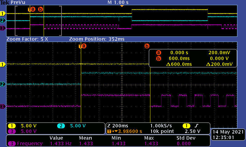

Please let me know if I'm reading your images from the scope correctly?I've captured the tray closed switch (yellow) M1 (blue) and M3 (purple. Screenshot attached.
With tray belt installed:
The tray goes in, oscillates, and then eventually returns to the open position.
The clamper motor never runs.
This happens no matter how the "tray close" operation is initiated.
I see you made some cursor measurements. I will take a close look at those a bit later.

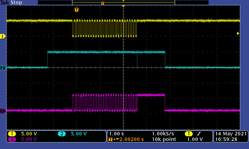

With tray belt removed:
It appears the clamper enters a similar oscillation pattern as the tray.
The clamper oscillation occurs when the clamper is nearly closed.
Eventually the clamper moves back to the open position
Then the tray motor runs for a while
Then the sequence of clamper close/oscillate/open happens again
And once again the tray motor runs for a while
And this repeats forever

(With tray belt still removed) What is the clamper cycle like if the player is powered up in the following state:
The tray is already in the fully closed position
The clamper is in the open position
-EB
With the tray belt installed: tray operation is as you described
With the tray belt removed: clamper operation is also as you described.
With the tray belt removed: Power on with the tray closed - clamper closes, oscillates, opens, tray motor runs and the cycle repeats as before.

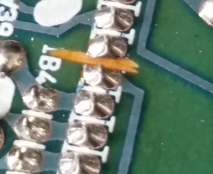

With the board out I noticed something that I hadn't before and can't explain. Pin 23 on the MCU has what looked like a track cut between it and pin 22. It is floating and not connected to pin 22 as shown on the schematic. Surely this can't be right?

I tried linking pin 23 to pin 22 as shown in the schematic but it made no difference to the problem.

Does it look like something that was done at the factory?With the board out I noticed something that I hadn't before and can't explain. Pin 23 on the MCU has what looked like a track cut between it and pin 22. It is floating and not connected to pin 22 as shown on the schematic. Surely this can't be right?
Or something that was done later?
