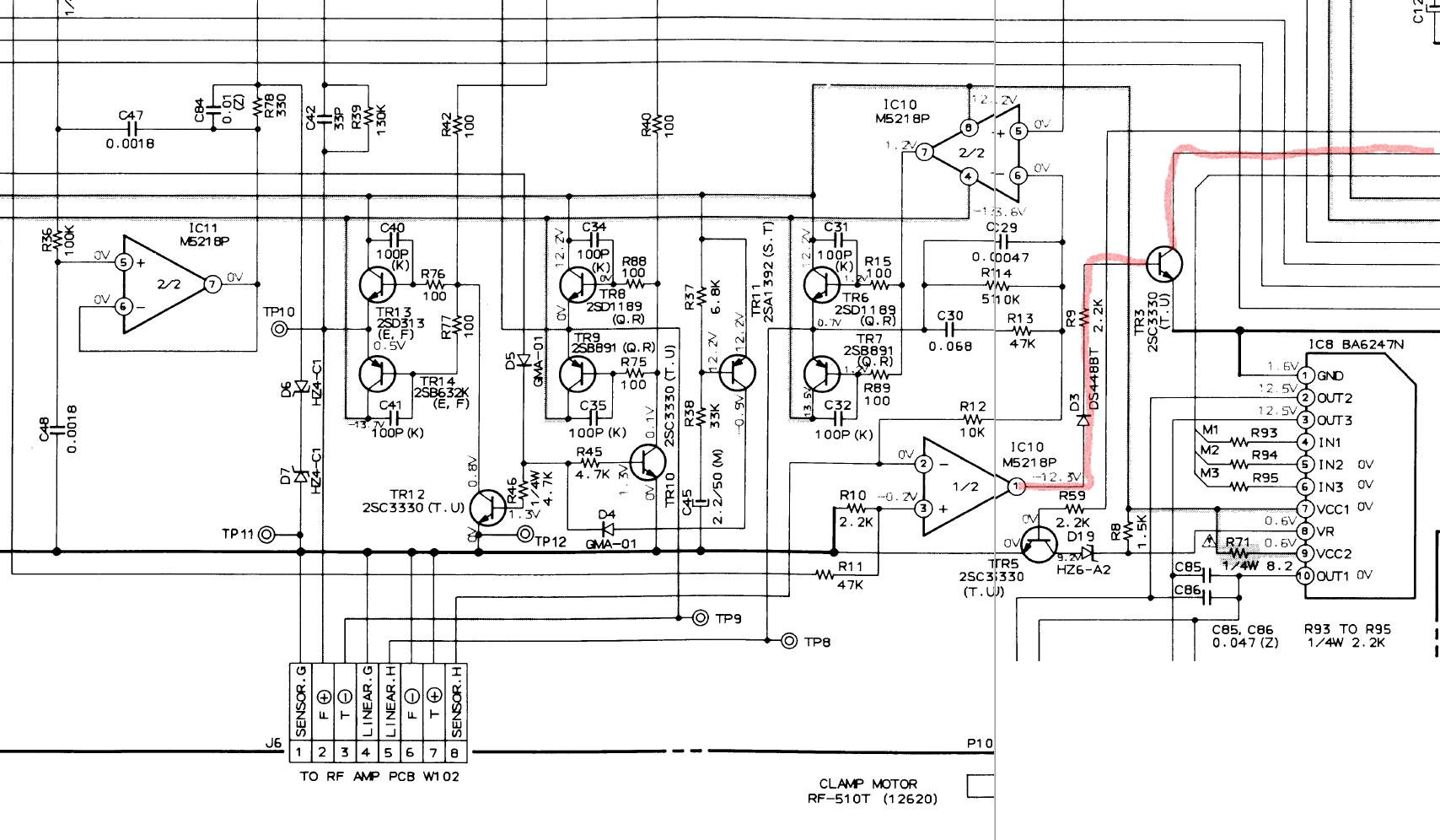

very interesting failure mode. looking at the BA6247 rohm driver datasheet, it is clear that the two motors share a common signal pin between the chip's two output stages. should the OUT1 connection (or the wire harnesses, pcb traces, etc) become intermittent, then attempting to drive one of the motors will cause the other one to run as well. Try double checking the wiring harnesses, pcb traces etc.

The strange behavior of the MCU hammering the CD tray by alternating the motor drive direction at limit switch status changes, on both loading and clamping cycles, appears increasingly more intentional, by design, the more I watch your videos, than a mere MCU defect or something by accident. Probably the machine is issuing some warnings about troubles with other systems by doing that.
On a hunch, that means I could be very wrong, there is this signal coming from IC10, and goes into #59 of the MCU (L.M.I.), which has to do with the laser pickup carriage linear motor, or its feedback coil to be exact. Usually people don't like having linear motors work open-loop, so 1/2 of IC10 is to detect a faulty feedback coil (at Sensor-H and Sensor-G). And my guess is when there is a defective feedback coil, or the detection circuit itself malfunctions, MCU would see a logic L at #59, it would then refuse to load or clamp the CD tray or the CD, even being forced to do.
Again, a wild guess, but perhaps worth a look. And there could be more of this kind of self-protection or warning mechanisms in working with this MCU.
By the way, Andy, if you are to try forcing TR3 off, it is better to disconnect the linear motor drive beforehand, in order to prevent possible damage if the linear motor does operate open-loop.

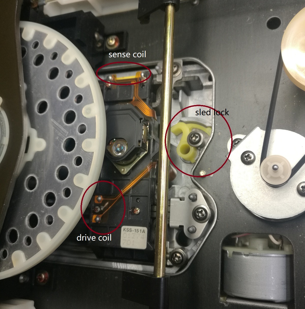

I have removed the RF amp PCB to reflow the 30 year old solder joints and check any electrolytic caps as I think this is always a starting point with old electronics of any kind. That completed I pulled the laser ribon and cleaned the contacts as this hasn't been removed in 30 years either.
I put it back together and measured the two coils mentioned on You Tube. The motor coil, pins 4 and 5, measures 36ohms and the sense coil, pins 1 and 8, measures 44Kohms on mine so very different to the figures you quoted on You Tube. The rework on the PCB made no difference to the problem so I will have to get the scope out and have a look at the circuit around IC10 and TR3 to see what this is doing when the tray is operated.
That sounds like we had a suspect....... and the sense coil, pins 1 and 8, measures 44Kohms .......
I measured the drive coil resistance again and got 35-ohm, matching yours. the sense coil is confirmed at 3.16Kohm.
I also measured the coils at both the connector on digital PCB and on their terminals on the pickup sled to make sure they match.
To get at the coil terminals on the sled, first turn off the power while the tray is out, then manually move the sled to its out most position, or tilt up the front of the machine and let the gravity do it, then secure the sled with the sled lock. --------- duh, this part is most likely unnecessary, you spent much more hours than I did around it...
OK, so the drive coil is fine but the sense coil is way higher than yours. I already moved the sled fully back to check this directly and eliminate the connectors and ribbon as a problem. It definitely reads 44k. I checked with two different meters to be sure.That sounds like we had a suspect.

I suppose the next thing is what to do about it? I'm assuming this is part of the pickup assembly and is unlikely to be available as a replacement part now. The strange thing is the player works fine once you can persuade it to load a disc, so maybe this circuit can be modified to eliminate the problem?
I guess the coil has become open circuit, and the 44Kohm is probably resistance of the rest of the circuit being probed at.
Neither coil seems to be part of the pickup. They are rather part of the deck mechanism, probably making even more difficult than the pickup to come by. I haven't seen any of the online pictures of the pickup has a coil on it.
I don't know about repairing the sense coil being practical or not. That coil is a mystery to me to begin with. At a DC resistance at about 3.4Kohm, it would take 370 meters of #44 AWG wire, probably the thinnest magnet wire you can get and be able to handle, before questioning being able to fit it all in such a small package. I wonder what the sense coil was wounded with.
The coil drive amplifier (U10-2) has a very different response with and without the sense coil. From my reading of the schematic, with the sense coil in circuit, the amp has a gain of 39 at DC, rolling off 6db/Oct at 50Hz, until flattening out to gain of 4 at much higher frequencies. This is before counting in the feedback from the sense coil as a secondary input but I think we can leave that part out for now. With the sense coil open circuit, on the other hand, the amp is at straight unity gain.
The good news is, despite the much altered amplifier characteristic, once the disc is somehow successfully loaded the tracking/sled-servo works, well perhaps not as perfectly, but certainly much better than non-worky at all.
So let's hope we could trick the MCU and defeat the supposed coil-detection process.
We probably don't want to put a resistor, 3.3Kohm, in place of the sense coil. Although doing that may trick the MCU into thinking there is a coil, and subsequently completes loading a disc, the resistor would also restore the amplifiers frequency response. This could be dangerous. as without a functioning sense coil feeding back the sled traversing velocity there may be chances the amplifier puts the entire rail voltage (12V) onto the motor coil and instantly speeds the sled up to a very high speed, and possibly crashes them into the end stop. We would rather have a sluggish sled than one out of control. However if you lock the sled up with that sled lock, it's safe to try it quickly, just remember take the resistor out immediately after.
If it's more convenient to access, instead of a resistor, we could short the base of TR3 to ground. This would defeat the supposed coil sensing process at MCU, without worrying about the sled speeding.
