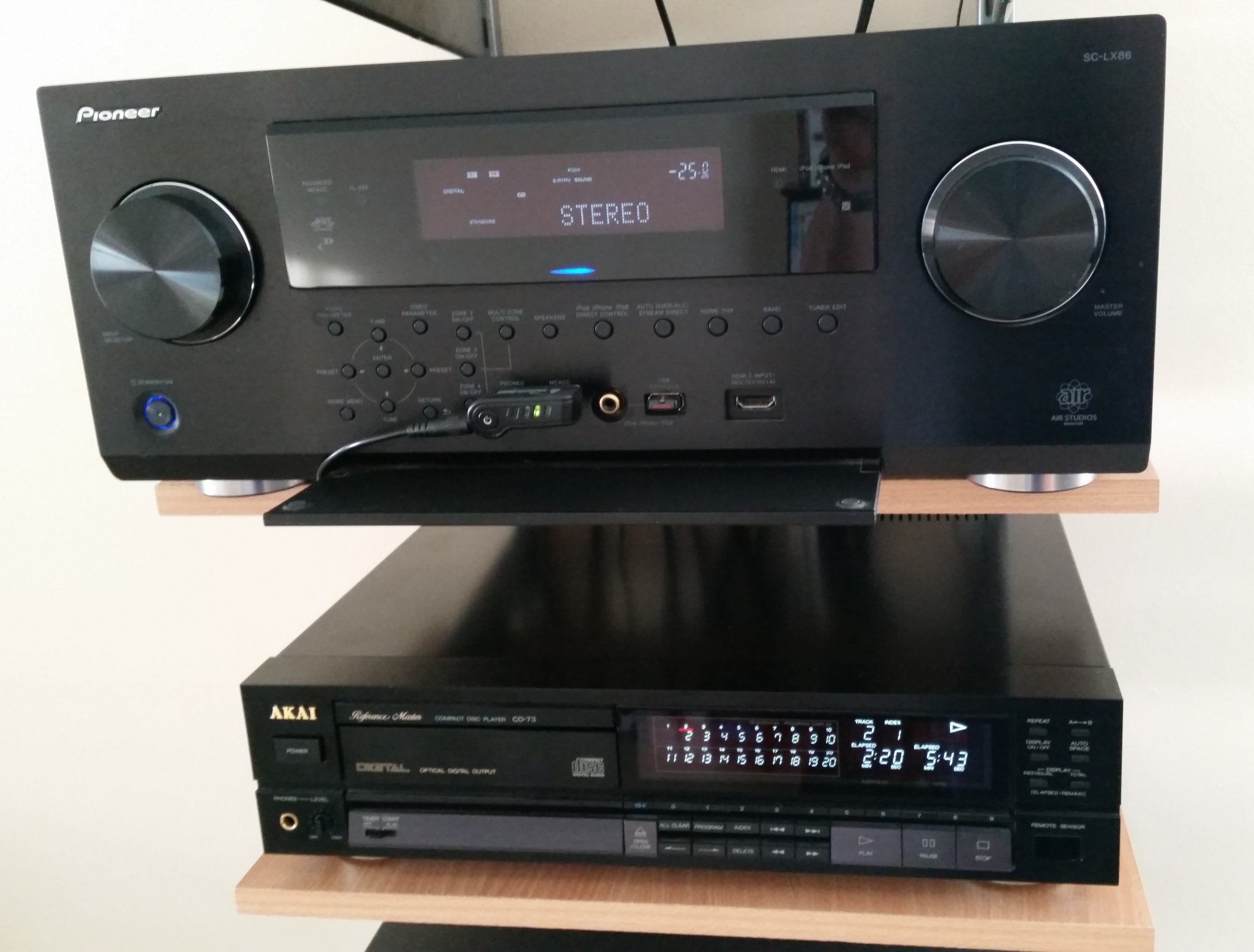

I've given it a thorough test and it's definitely cured. I'll be swapping it over for my Akai CD-55 which has been stand in for far too long. I'll enjoy a few beers and my music this evening.
Thank you very much once again! Also to all to all those that contributed to this discussion and journey... to a simple wire link! 🍺 😀
The Akai is back where it should be after languishing in the cupboard for far too long. Coupled for the first time via it's optical output to my Pioneer SC-LX86, it sounds very nice and after several hours use is still working perfectly. The tray loads and unloads without any problem every time.
