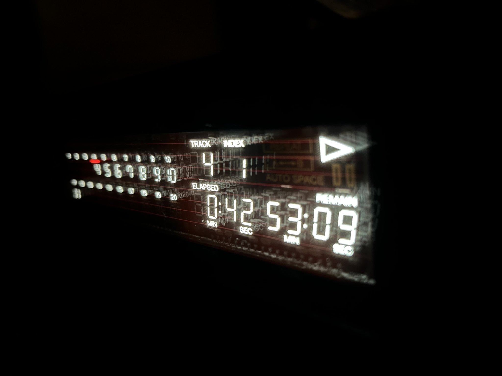

The amplitude looks correct once it settles down but it's very difficult to get it into that state and it seems to be deteriorating.
The service manual shows five pots that need to be adjusted as part of the setup procedure but it references an akai test disc to do this. The player has to be put into various test modes using the disc to do this. I tried a normal music CD but the disc starts to run at crazy speeds, so I don't think I can do it that way.
I can borrow a frequency counter from work to check the PLL but I do recall setting this before. Without the akai test disc I'm not sure I'll be able to make the other adjustments though.
One other thing that is happening is I must wait for the disc to stop spinning before I press eject or the tray comes out with a rapid spinning disc still on it.

I finally got it to start playing again by going from track to track. My scope can measure frequency and the PLL is locked at 7.35kHz as shown in the manual which is one win.
If I skip a track it starts misbehaving again and the PLL starts jumping around in frequency but I think this is an effect of the fault rather than the cause?

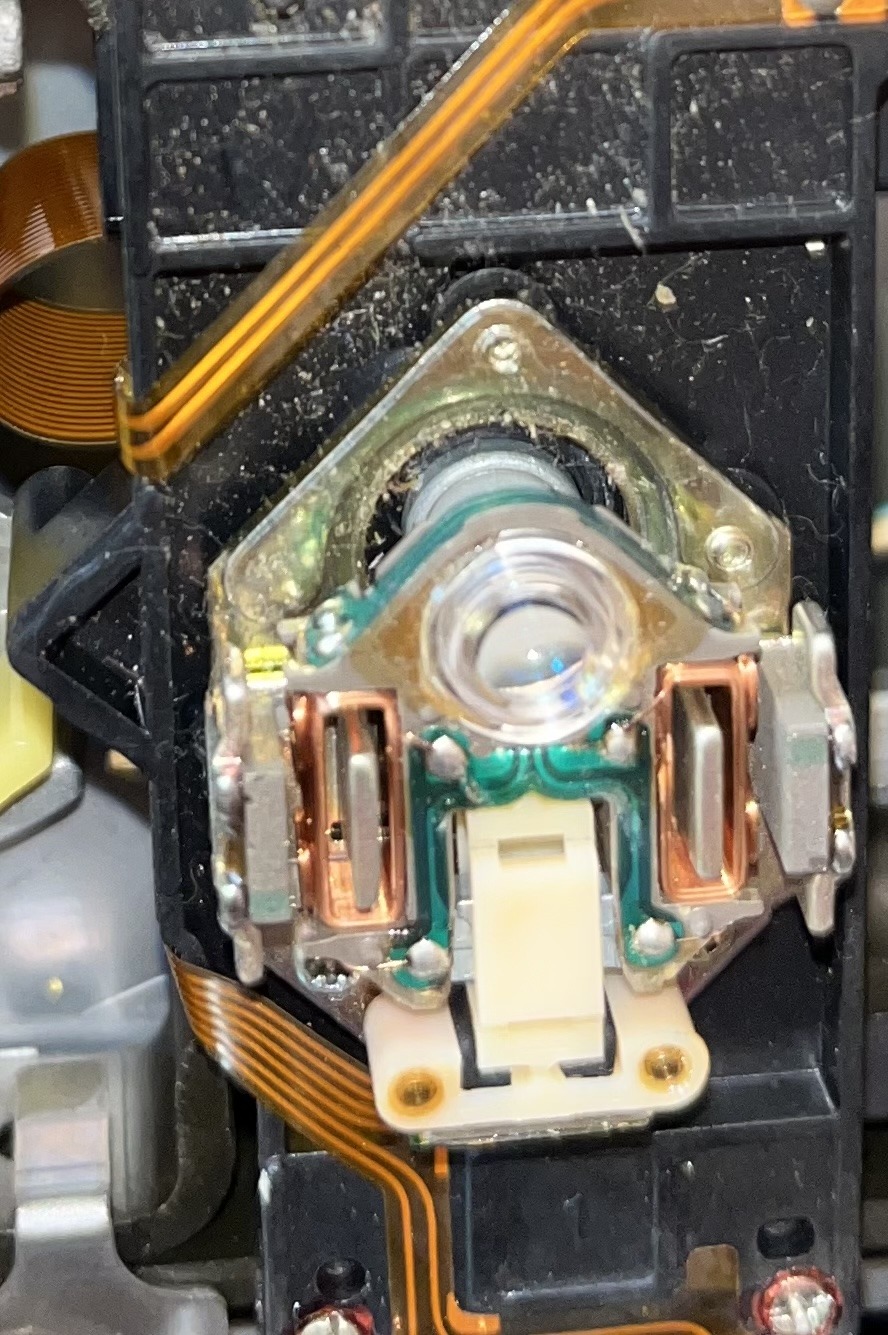

I think the problem still lies with the sense coil on the sled. The fact that the machine still plays well when it somehow does, and that when it does you have good RF waveform indicates the laser is good, the focus servo is good, the CLV servo is good. The questionable part is then the tracking servo, which the linear drive sled is big part of, which we have a failing sense coil within. When you fast-forward or skip a sound track or seek a sound track, you're asking the tracking servo to perform a much more dynamic task than would during normal playback. These seem to be the moment the operation would fail from your description, and a symptom consistent with the above suspicion.
The shorting wire mod that seemed to have "worked" did not fix anything, other than fooling the micro-controller into not seeing a failing sense coil and, consequently not performing its safe-guard duty refusing loading the disc. The performance of the linear sled drive system might have been borderline yet could keep the machine going for a while, and when the sense coil deteriorated further, we have a non-usable machine eventually.
If you happen to become strong-willed enough and want to get to the bottom of it, I guess there is no way around that sense coil. Replacing it, or rewinding it😱😱😱 would be the only way to go I'm afraid.

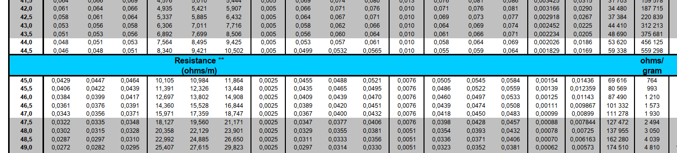

In case it ever becomes useful, this chart may help make a reasonable guess about the wire size by using the ohms/gram column. As the wire is extremely thin and there can be a substantial length of it, measuring the total weight is probably more practical than measuring the total length.
It would take a fairly precise electronic scale to weigh out the magnet wire unwound from the bobbin. The scale I make espresso with has resolution of 0.01g and it's inexpensive. Or, take the unwound wire to a jeweler 🙂.
Thanks for the wire info. I'll take a look at removing the coil and unwinding it. It will take some time and won't be much fun but I'll need to count the number of turns and replace it with wire of the same gauge to achieve the same coil resistance.

I read the most recent posts with great interest. I put my CD73 back into storage after it stopped working again. I haven't got around to looking at the sense coil again but if it is just a break in the wire in the first few turns, then it would seem a good time to take another look at it. If that is indeed the case, then removing a few turns doesn't seem like a bad idea to get it working.
I have removed the sense coil and as soon as I touched one of the wires it snapped away. I tried to locate the end of the wire on the coil but it's all but impossible to do so. The wire is so thin it just breaks away with any attempt at this. I think this player is now officially dead!
Don't! 🙂 such hairwire windings can be rewound too. I have a friend who is making pickup coils. I can ask him. There was a thread about possible wire diameter. And I also have to note that KSS272A has around the same resistance sense coil (3,5k measured), and it seems unaffected by the problem-I was able to separate and reconnect without any issue. So it looks like we still have possibilities, don't give up! 🙂 Sound is very good from this player.
My attempts to locate the end of the wire to reconnect it failed over and over... the more I tried, the more damage I did. I have now removed all of the wire from the coil former so I can weigh it. This was previously suggested as a better way to determine the amount of wire required.
