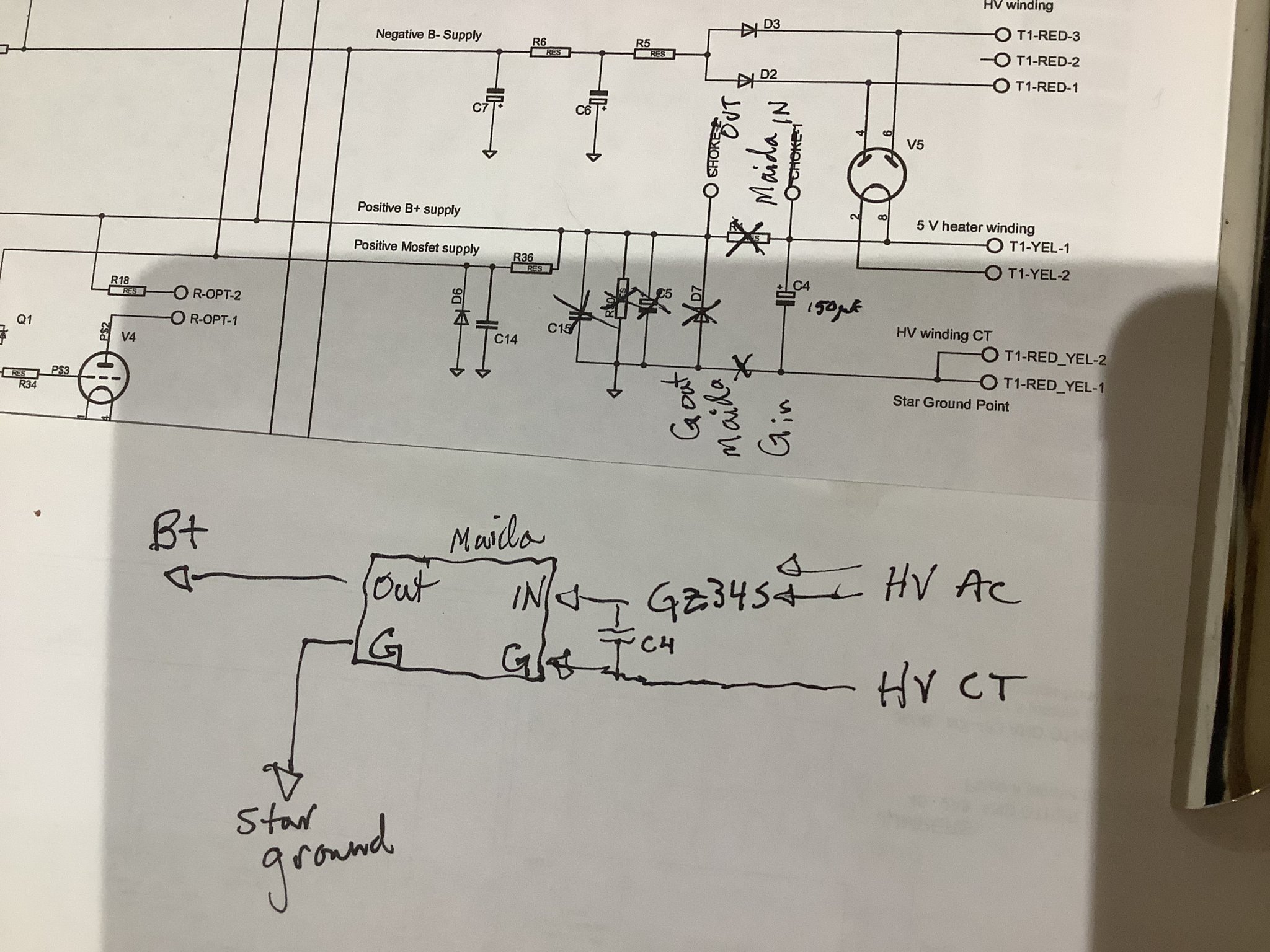

Hi, I want try 21 Century Maida HV reg (from Neurochrome) on my tse. I am not so sure about the changes (and grounding). I plan to have a 150u cap (in place of C4) in between the rectifier and the Maida board, then I will strip out C15/R30/C5/D7. Should I also get rid of C14 on mosfet branch? As I understand the Maida docs, less capacitance downstream of the reg is better.
Also, I am not sure about where to run the in and out grounds for the reg. Do they both just go to central ground, or perhaps the out ground goes to the central ground, and the in ground just connects to C4 and the HV centre tap(see my diagram below). Any suggestions appreciated.

A 150uF input capacitor in C4 will probably make fireworks of your GZ34. Research the maximum input capacitor to use with GZ34.
I would not change the downstream components from the point where you want to install the Maida reg in place of R4; you need at least the bleeder resistor R30. C14 might be required.
Before going this route it would be useful to investigate the B+ voltages you will end up with. Do not forget that there is a minimum voltage drop required in order for the Maida to function properly. To make it work with your existing power transformer you might consider SS rectification. That also has the advantage of allowing higher capacitance on the input capacitor.

What about grounding?
@henryyyy you're welcome to email me directly. You can do so by adding @neurochrome.com to my user ID here or by going through the Contact Us form on my website.
Anyway. I would keep C5, C15, and R10. Just make sure the sum of C5 and C15 is no more than 47 uF. Personally, I would make C5 = 10 uF; C15 = 100 nF but the values aren't critical as long as you have a reasonable amount of decoupling capacitance.
R4 is eliminated. That's where the Maida Regulator will go. Connect the input of the Maida Regulator across C4. Connect the output across C5. The terminals for the choke come in handy for this. You do not need to cut the ground connection between C4 and C5.

You will also need D7 across the output of the Maida. The B+ voltage is tube rectified. The B- which supplies bias to the output tubes via the mosfets is solid state rectified. This is done for a reason. B- comes up first which keeps the output tubes in cutoff. The DHT's warm up faster than the 5AR4 so they are ready, but still held in cutoff as the 5AR4 applies B+. The bias supply moves from a large negative voltage to the proper value as the 5AR4 heats gently starting the output tubes. During warmup some of the negative voltage will find its way through the voltage divider associated with the bias pots and put a negative voltage across C5 which is now the output of your Maida. It may not like this. D7 will clamp it to about half a volt.

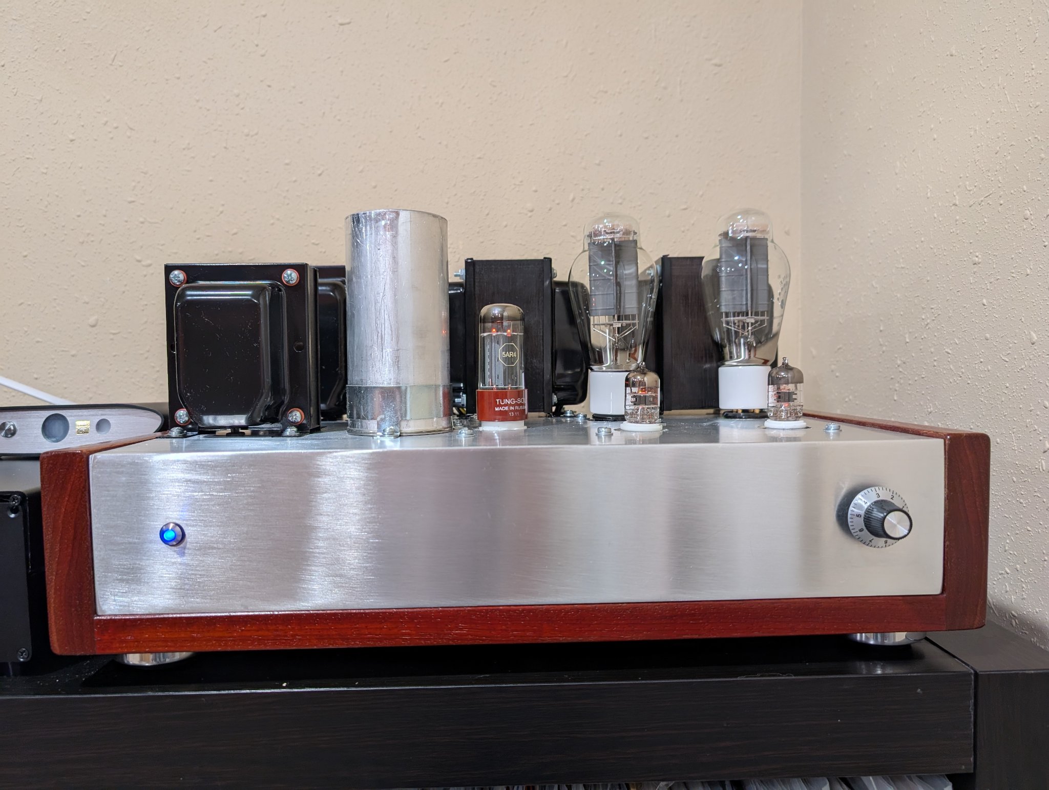

Got my TSE II up and running thanks to the help of this thread and some amazing members.
Special shout-out to George for personally answering a few questions I had during the build. Wouldn't have been possible without all the great information and time others have put in before me.
Running all Hammond:
Power trans 372HX
Output trans 1628sea
193G choke
Psvane 300b biased at 75ma
Raytheon 5842- set at 175v
Tung Sol 5AR4
Mundorf Supreme coupling caps. Overall pretty impressed and happy with the final product. Might try and use the 16 ohm tap on the output transformers to get the 2.5k load, doesn't seem to have the gain of the other tubelab amps, still plenty loud though 😁
This joins Tubelabs other creations in my setup, the SSE and SPP. Now time to get this burned in!

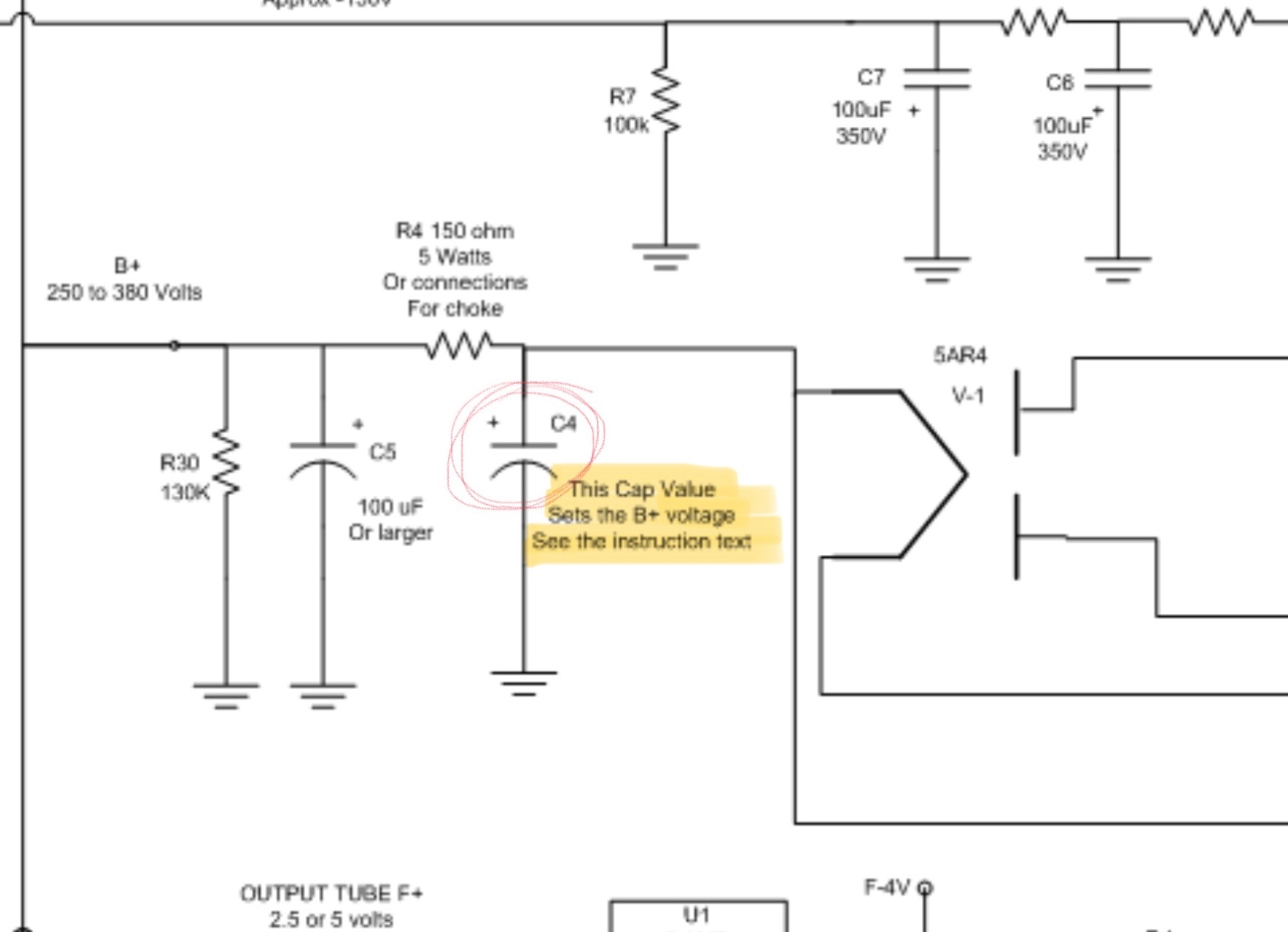

Assuming I can still get a TSE-II pcb at the tubelab paypal (after all, George didn't promise anything about boards in 2025), I am going to dive into this project. I have been trying to read up and learn about this design. There is one thing that confuses me on the schematic. It looks like the 5V heater is connected to the B+ voltage at the bottom of the tube rectifier. Being new to tubes, I will assume that I don't know how to schematic a tube rectifier.
The reason that I was looking at that part of the circuit is that I have a leftover Hammond 290CX transformer (yes, leftover from another tube project so I'm not entirely a tube noob. Or is that tube knob?) I think the 290CX was designed as a guitar amp transformer with a different physical orientation than is typical. Comparing to the 372HX, the 290CX has only 4 amps 6.3V compared to the 372HX having 6 amps but that should be the problem for the 5842 because it only requires 300 mA per tube. The big difference is the 290CX has 650V C.T. instead of the 600 for the 372HX. It seems like I should be able to drop a 50 measly volts somewhere in the power supply. I'm thinking turning the CLC power supply into a CLCRC with some off board components. Am I off my nut or does this idea merit a few more dead brain cells? My thought is the cost of the power transformer is worth an upgrade on tubes for this amp.
Thanks in advance.

C4 value is all you need to change to adjust B+, if you want to keep it simple.It seems like I should be able to drop a 50 measly volts somewhere in the power supply. I'm thinking turning the CLC power supply into a CLCRC with some off board components. Am I off my nut or does this idea merit a few more dead brain cells?

Tweaking the value of C4 will adjust the B+ voltage. This works best if a choke is used in place of R4. A choke is recommended to eliminate hum with sensitive speakers.
Yes, the 5.0 volt heater winding is connected to B+. This is the case for all DH rectifiers like the 5U4 and 5Y3. It is also common practice with the 5AR4. In my 60+ years of tinkering with vacuum tube electronics I have seen exactly two transformers with an internal short from the 5 volt winding to the 6.3 volt winding. One of them belonged to cogitech. It made life miserable for a bypass cap and took forever to remotely troubleshoot. Shortly after that another one was found, also in an SSE. Both were Hammonds.
