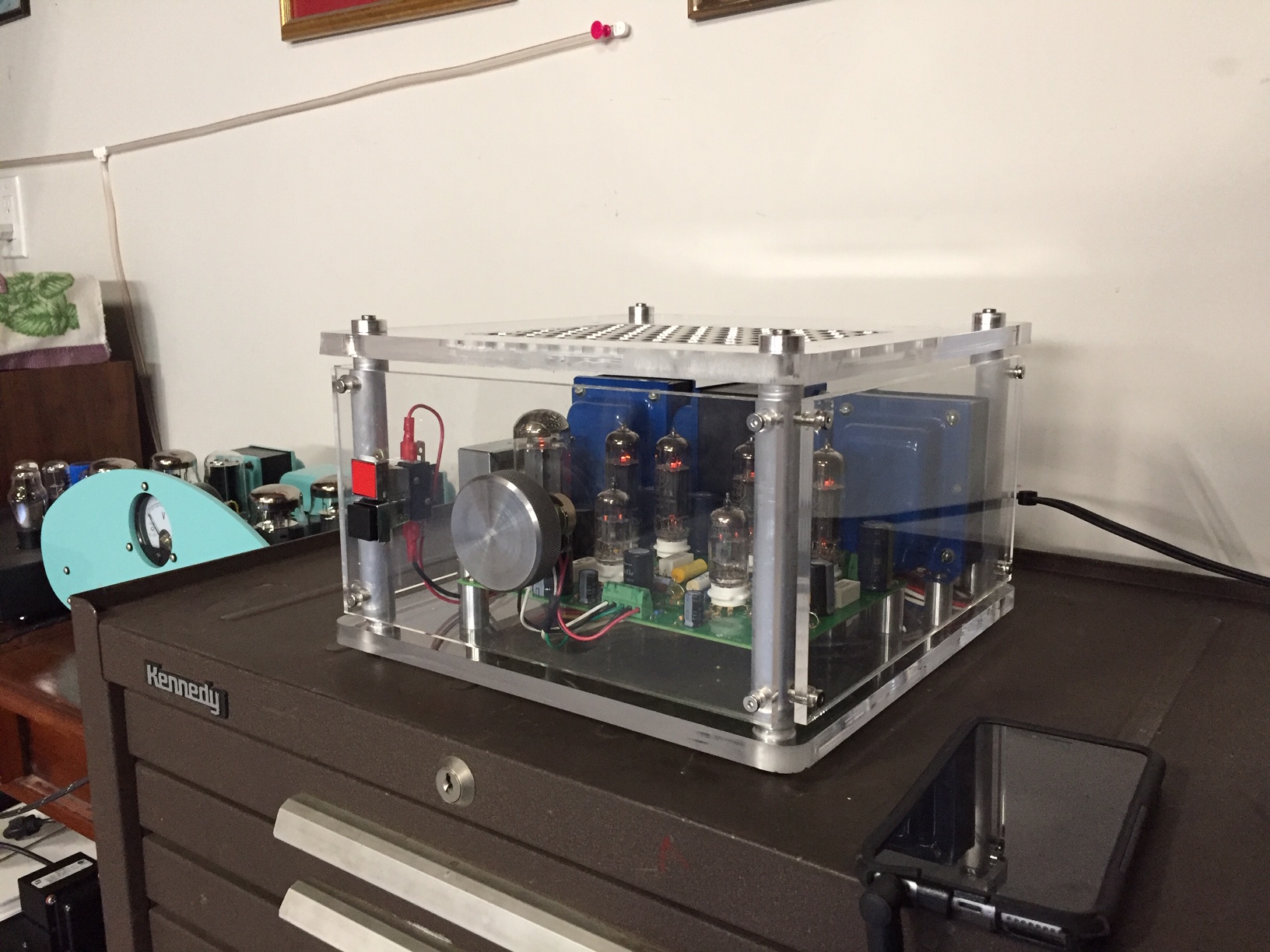

I looked back at my pictures and counted 6 Tubelab amps I have built, including a TSE-II that I recently sold. Before retiring, several students bought different Tubelab boards and built them. Every time they played music through their Tubelab amp for the first time, I would yell: it's alive! It's Alive! IT'S ALIVE!!! As loud as I could. The students always were amazed at what they had learned and done. There are several Tubelab amps still out there in various locations of the world, thanks to Tubelabs. And, I still have about 10 Sharp filament regulators, even though they went extinct due to Foxconn's takeover of Sharp Electronics, but I'm not the person who ebay selling them of $25/each.
One student built this push pull amp based on a Tubelab board:
