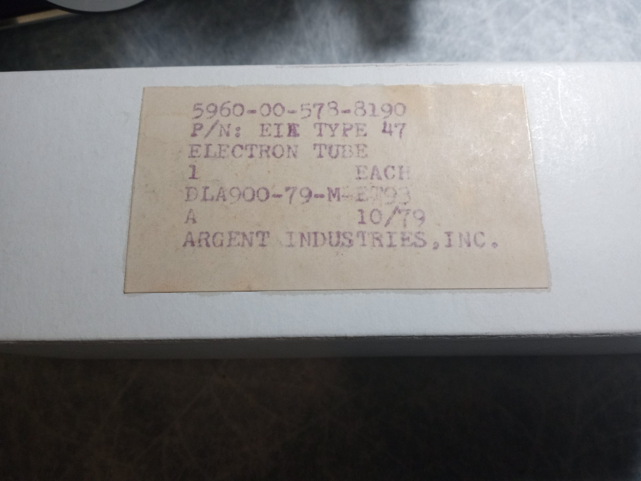

OK, why did a box containing 5 50L6 tubes, 10 50FE5's, 10 12AU6's and 10 12AW6's show up at my house today, and another pair of Ebay scored 50FE5's show up yesterday? No, they are not for old radios, or any old stuff. There is another box full of stuff that I fetched from the storage trailer destined for the same place. To me, the real question is what did the US military do with 50L6 tubes in 1987? That bar code is an FSN (Federal Stock Number).
That's a head scratcher.
Audio out in a tape recorder or film projector, maybe even an intercom or speakerphone would be my WAG.
The real question is, being Richardson, are they even 50L6GT's?
Maybe whoever figures it out can tell us why the Feds needed to restock 47's in 1979.
