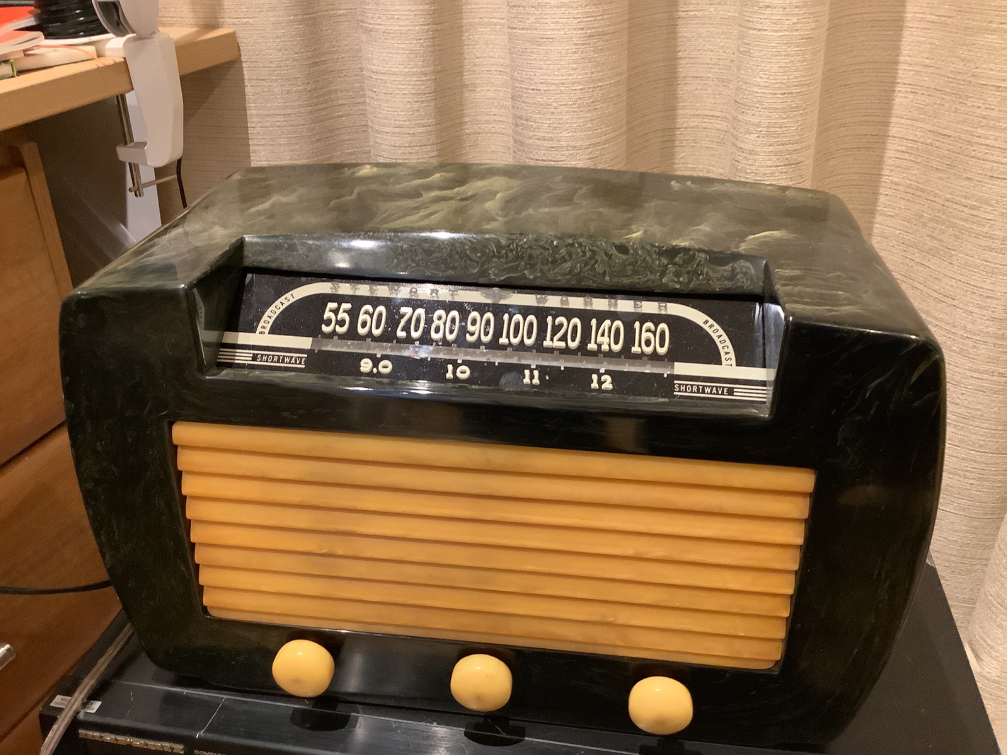

Tune the radio to a weak analog AM station. Place it near the amp and fire the amp up and play some music. Use a non metallic instrument to move the wires leading to the 300B tubes. Anty interruption, buzzes or crackles that come from the radio could be from oscillation. Without changing anything cut power to the amp while still doing whatever disturbed the radio. If the disturbance stops, the amp is likely oscillating. I have created some circuits that could blank out a TV set that was connected to cable TV in another room. TV sweep tubes connected up with clip leads will do that!

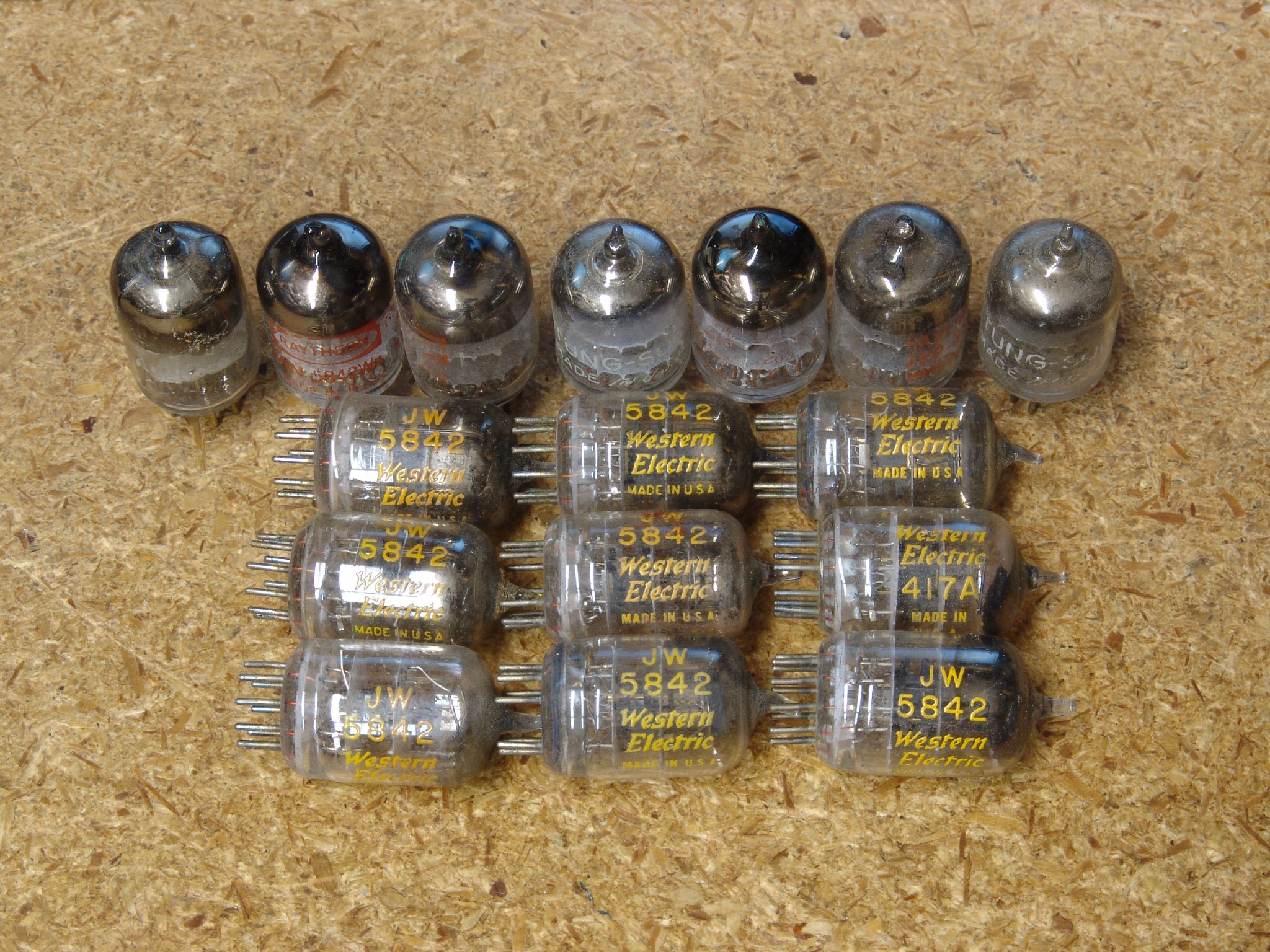

A lot depends on the tube, its original application and how it is currently used. Googling "5842 vacuum tube" brings up more BS than fact, especially the "used exclusively in Russian military radios" statement. The 5842 was designed expressly for use in high frequency telephone RF carrier repeater amplifiers, some of which were employed in underground or undersea applications were repair was rather difficult. Several manufacturers made this tube. I have seen Raytheon, Western Electric, Ericsson, Tung Sol, and a few others I can't remember. WE also called it the 417A with some tubes marked 5842 / 417A. Raytheon's were the most common flavor seen in the US, these tubes were made to last.

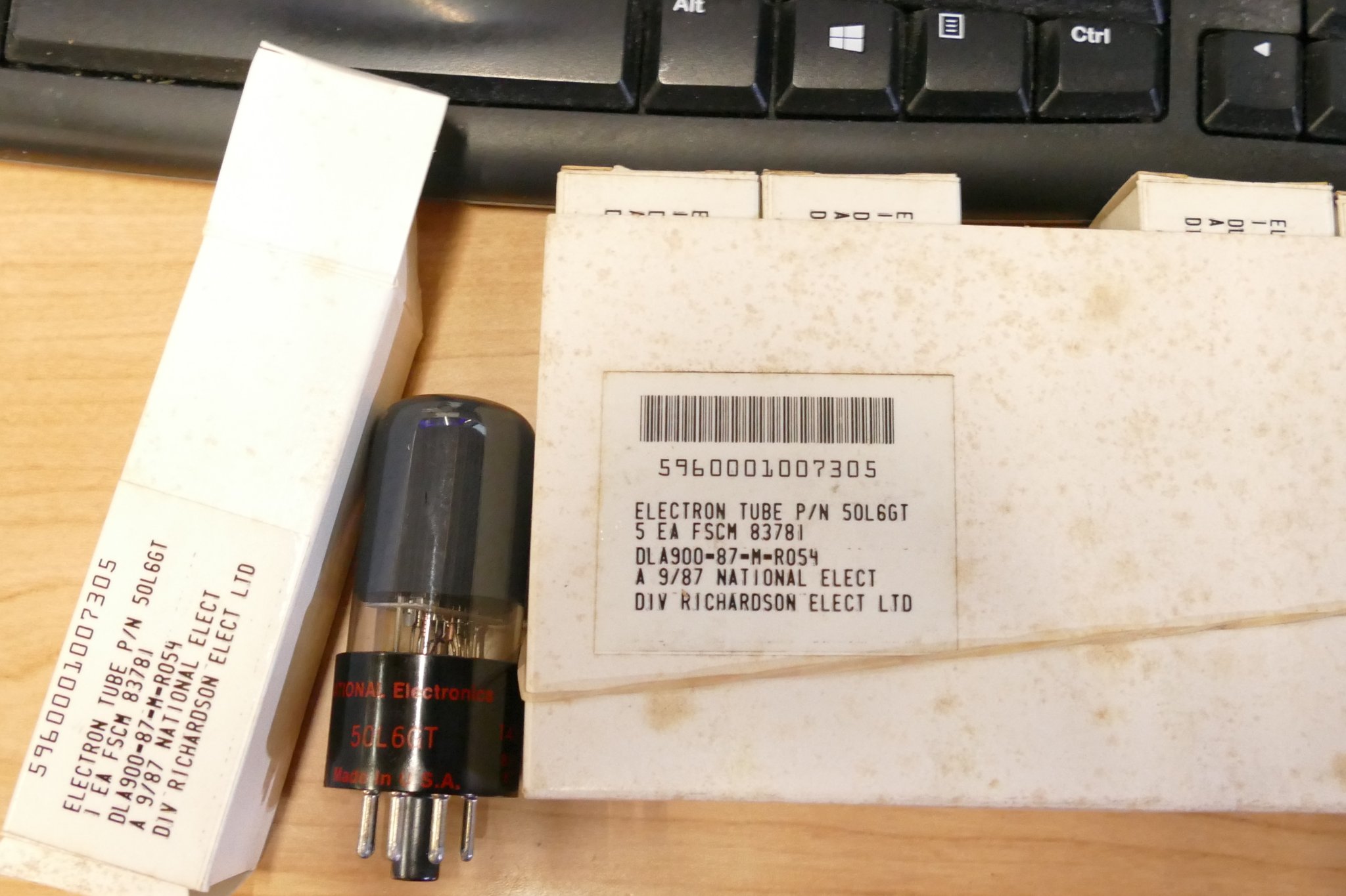

OK, why did a box containing 5 50L6 tubes, 10 50FE5's, 10 12AU6's and 10 12AW6's show up at my house today, and another pair of Ebay scored 50FE5's show up yesterday? No, they are not for old radios, or any old stuff. There is another box full of stuff that I fetched from the storage trailer destined for the same place. To me, the real question is what did the US military do with 50L6 tubes in 1987? That bar code is an FSN (Federal Stock Number).

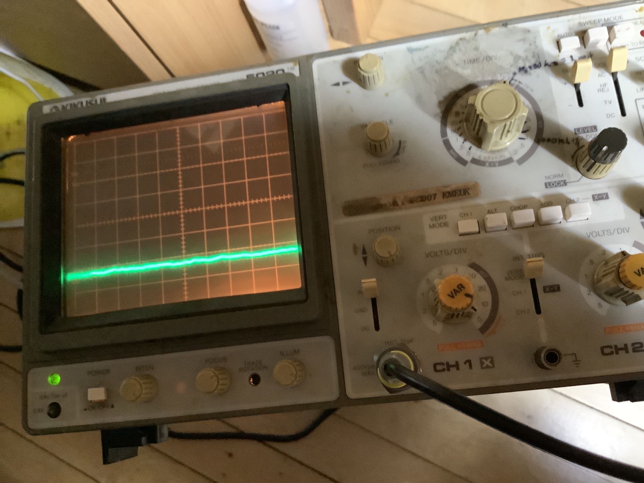

If you have a scope, look at the filament voltage on the 300B's. It should be ripple free DC.
Hi George, I tried putting my 1940s radio by the TseII and I didn’t notice any change when turning on then off. The reception for am is not terrific in the uk. There is only one channel I can get is at 700kh and that is very weak. Is there any other way to check for oscillation?
I put my oscilloscope on the filament and the ripple is around 2.5 mV.

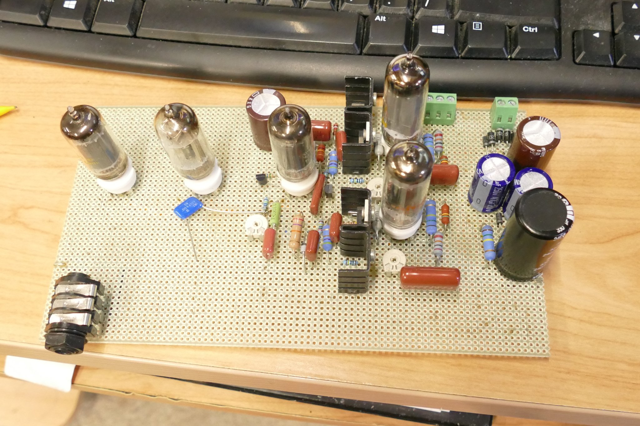

I had this board running fine with 45s but I decided to change to 300b because the 45s always sounded nice but weak with my system. Perhaps I could switch back to see if the 45s still sound ok?

Since nobody else is answering, I'll toss in a few thoughts. I don't know if it's even possible but could you move the output tubes to the pcb or at least close enough to use much shorter wires? Although the AM radio test seemed to indicate that it wasn't oscillation, I might want to completely eliminate that possibility. And it's something that might stay the same as you changed to the 45's. Other than that, I think your instinct is good to change the mosfets. You have checked all the resistors in the signal path and swapped out input tubes, output tubes, and OPT. What else could there be?

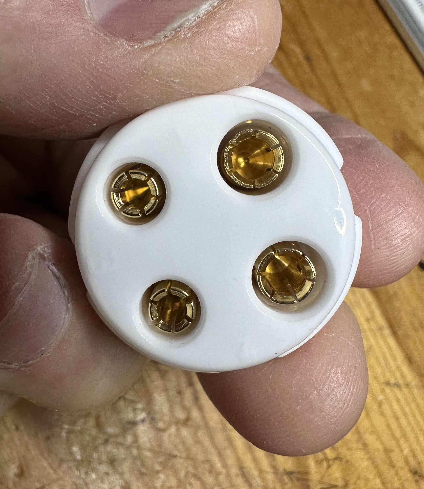

Thanks, just waiting for the mosfet delivery. The reason I moved the 300b sockets off the board was because the sockets were so tight that I was bending the board every time I put in or out a valve. I have real trouble sourcing good sockets!
I completely understand that concern. Having had that problem on a previous project I tried the more expensive, collet type socket (see link). I think that they are a little better but still very tight.
Machined pin sockets
I'm thinking about cutting pieces of plastic to brace the pcb between the pcb and the base.
Reactions: henryyyy

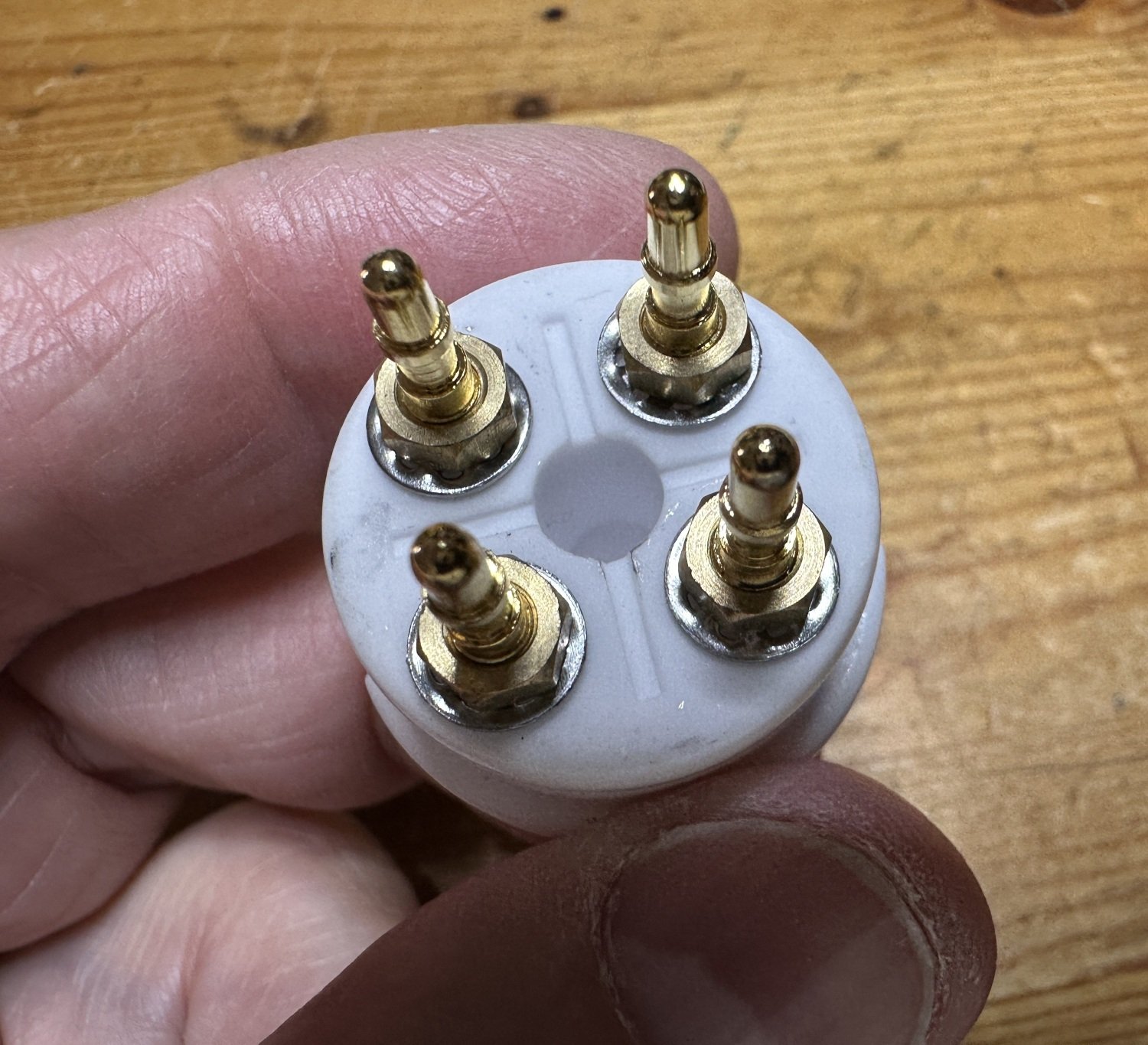

Hi Henry,
Regarding the machined pin sockets, I actually ordered the ceramic ones, not the bakelite ones I linked, but the sockets are the same. I just took another look at them since you were ordering some. I have an older set of 45's and they slide in and out with reasonable force. My 300b's are brand new Genelex PX300B are stiffer. If you look closely at the picture, the cuts inside the socket don't go full depth. If I push the 300b into the socket and leave 6 mm or so between the bottom of the valve and the top of the socket, then they are tight and have good connection. Push them in all the way and they are too tight.
One problem that will require some tweaking is soldering the pins to the pcb. The hole in the pcb is much larger than the pins. There are two approaches that I am considering. First is soldering the nuts on the pins to the pcb and maybe filling in the holes on the bottom a little. The other idea is to make a washer out of copper or brass that sits on the first shoulder of the pins. Then soldering the pin and washer to the pcb and each other. Both ideas seem possible but I haven't done it yet.

Good news, I moved the sockets back onto the board as George suggested a the distortion is gone. I guess there was oscillation due to moving the sockets off the board. I am not sure why the radio test didn’t pick it up. It sound better then when I started so I seem to have fixed the other weak signal/distortion issue along the way. I am still worried that the sockets are too tight and am thinking of how to stabilise that area of the board - perhaps adding a post.
