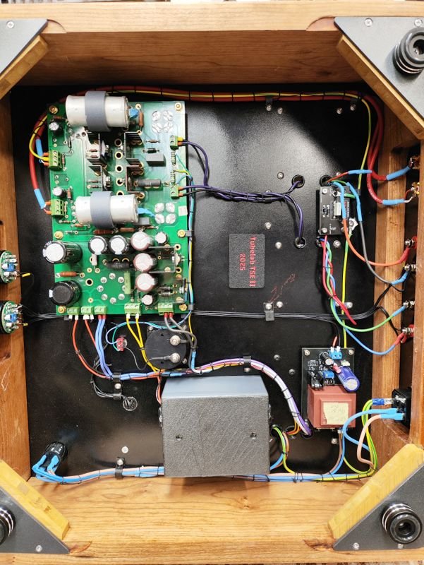

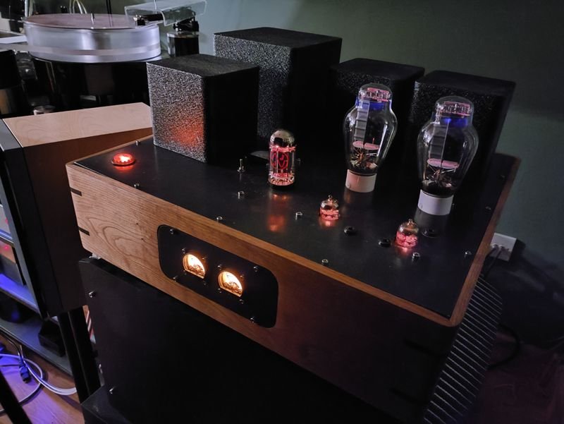

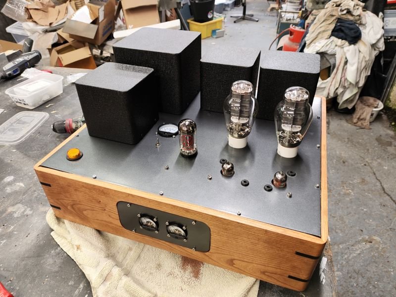

Hi all,
I finally finished my build. I cheated somewhat here since I bought a populated board from another member here, I just had to add some of my own preferences for coupling caps etc.
I went with cable lacing for the looms just because I thought it would fit nicely with the valve era. Power transformer is a custom toroid, output transformers are a somewhat unusual 5k:6R set donated from a damaged amp that I repaired for a friend. Everything else is pretty much standard. Since those photos were taken I added test points on the top plate for the 5842 valves. I fitted a 1V scale meter and switch for checking the 300b current. I 3d printed tubes that guide a screwdriver down to the adjustment pots so that you can't short anything when adjusting, and printed covers for the 2mm sockets I used for test points. Same deal for the big polypropylene caps for power supply.
Sound is really good, very happy with how it sounds - I had it running on a board before making the chassis so I knew it was worth the effort.
Thanks to George for the design and making boards available and to all who gave the advice in the thread here.

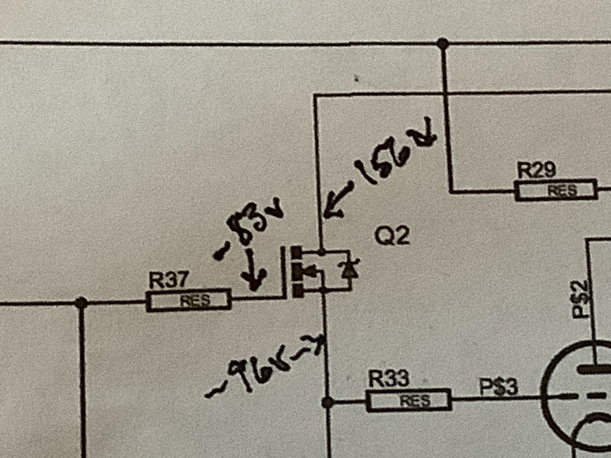

I removed the Maida regulator and put in R4, but I still get a muffled weak output. I tried swapping out the OPTs and valves with no improvement. Is it worth trying to bring B- up? It is -256v. The mosfets have +156v, -83 and -96v. Could that be the problem?

First of all, I apologize in advance for suggesting things that you have already tried 12 times. That said, it does seem like something is wrong. This is the way I'm understanding it. Please, someone correct me if I have this wrong.
Assuming R5, R6, R11, R12, and R13 are the correct values, there is no direct way to adjust B-. The way that B- is adjusted is by adjusting the wiper on R12 which, through Q1, changes the amount of current drawn through the output tubes. I believe that B+ gets larger as B- gets smaller. Since your B+ and bias current were already good enough, you may have to lower B+with resistance in the choke circuit to get B- closer to the suggested -184V.
I wish someone with knowledge would chime in and suggest an acceptable B- range for 300b tubes. From what I have read there are few specs for B- in the datasheets. The closest I came was New Sensor 300b where they state that the limiting value of grid voltage (to ground?) is -220V. Maybe you should try to measure grid voltage. I'm guessing that it will be closer to -60 than -220. If it really is much more negative than -60 then it really could be affecting the way it sounds because it's way off the curves for any datasheet that I've seen.
In the end, when none of this helps, I would probably go back to the Tubelab/Design/Tubelab SE/Assembly Manual and follow both the "Check out" and Bias Settings" pages to the letter (except for R7 which isn't there anymore). Oh yeah, and check the continuity and values of R5, R6, R36, R11, R12, and R13 for the millionth time.

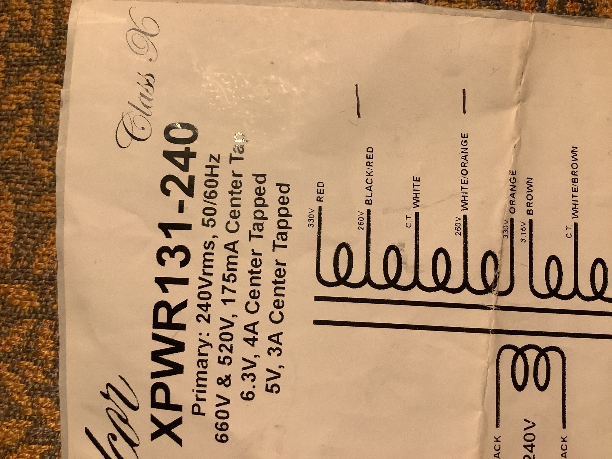

Thanks Jac! The 250v that I was referring to is the “negative B- supply” on George’s schematic. I think the Tse website says -150v, but it will vary with the PT. The Q2 mosfet sheet says 450v max so it must be heavy duty, so I am guessing the 260v across them is probably ok. The B- voltage is set by r5/c6/r6/c7 (rcrc filter). I am guessing I could also use the other winding on my PT: I am using the 660v winding which gives 400v once smoothed out (which is just right for the B+). Perhaps I could use the other winding (taps) 520v to feed the B-?

Just my opinion, but before I considered switching to the 420V tap, I would check grid to ground voltage was in the -61V to -74V range. If it was then maybe -250V for B- is OK. If it's not, then I would consider adding a couple Ohms of series resistance to the choke (or R4) and reset the bias. Because B+ and B- (plus I assume grid voltage) move in opposite directions with bias adjustment, the hope is that you could find a more balanced operating point without giving up so much B+ voltage. After all, the 420 Volt tap is only capable of about 300V B+.
