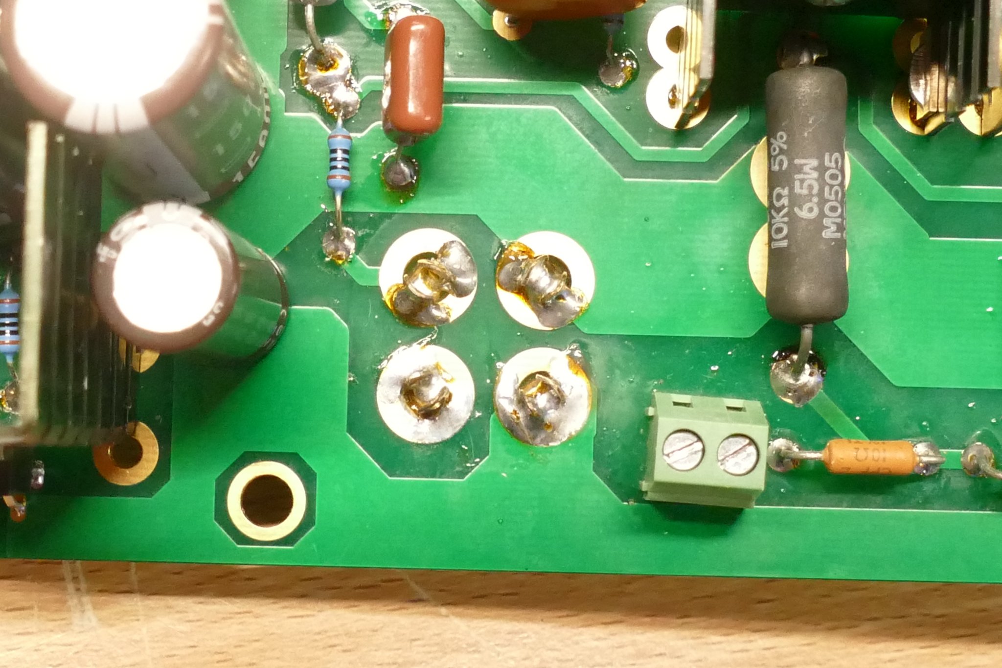

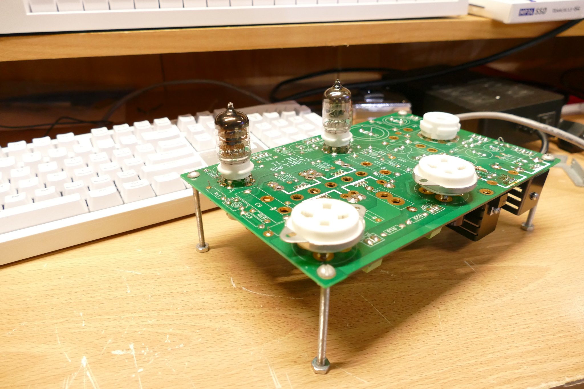

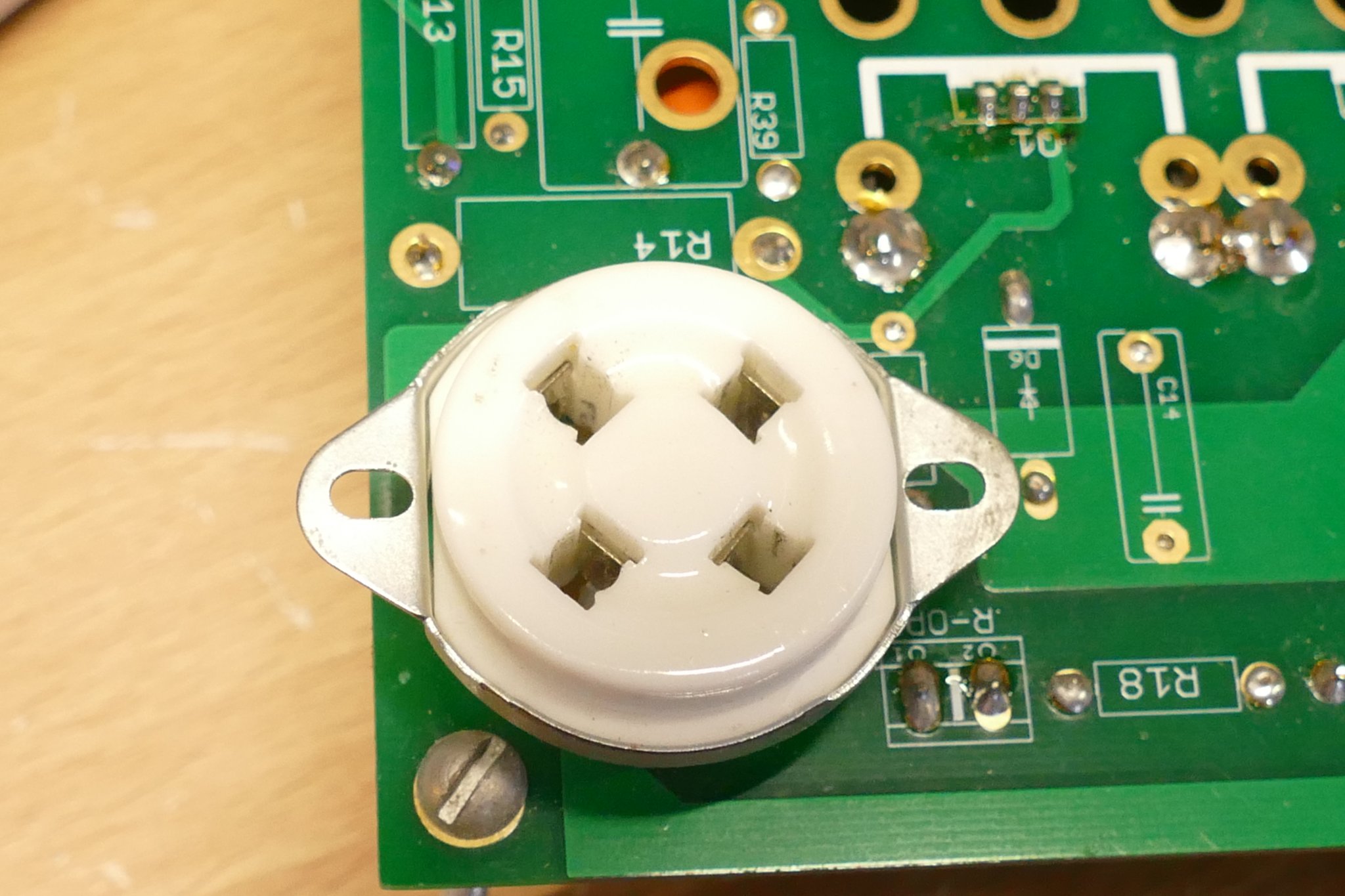

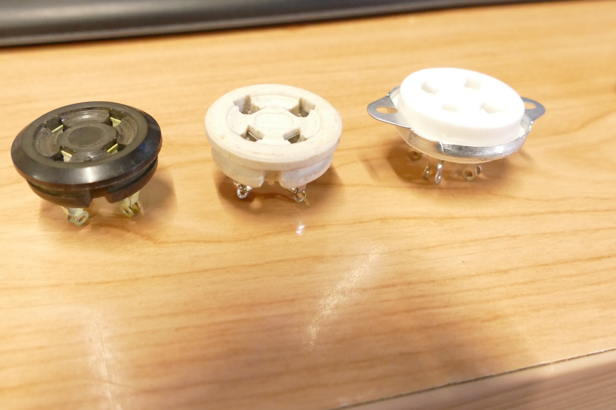

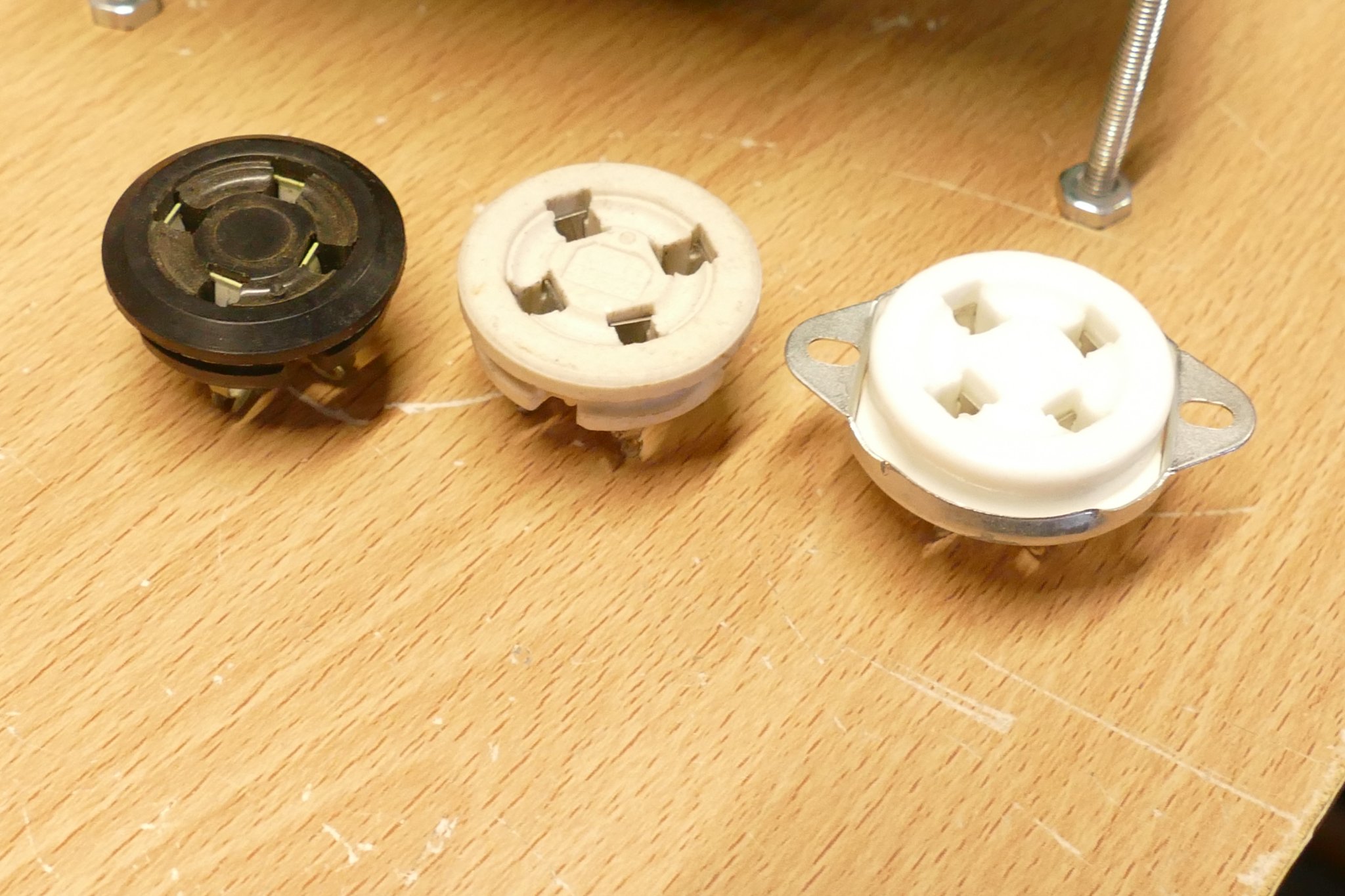

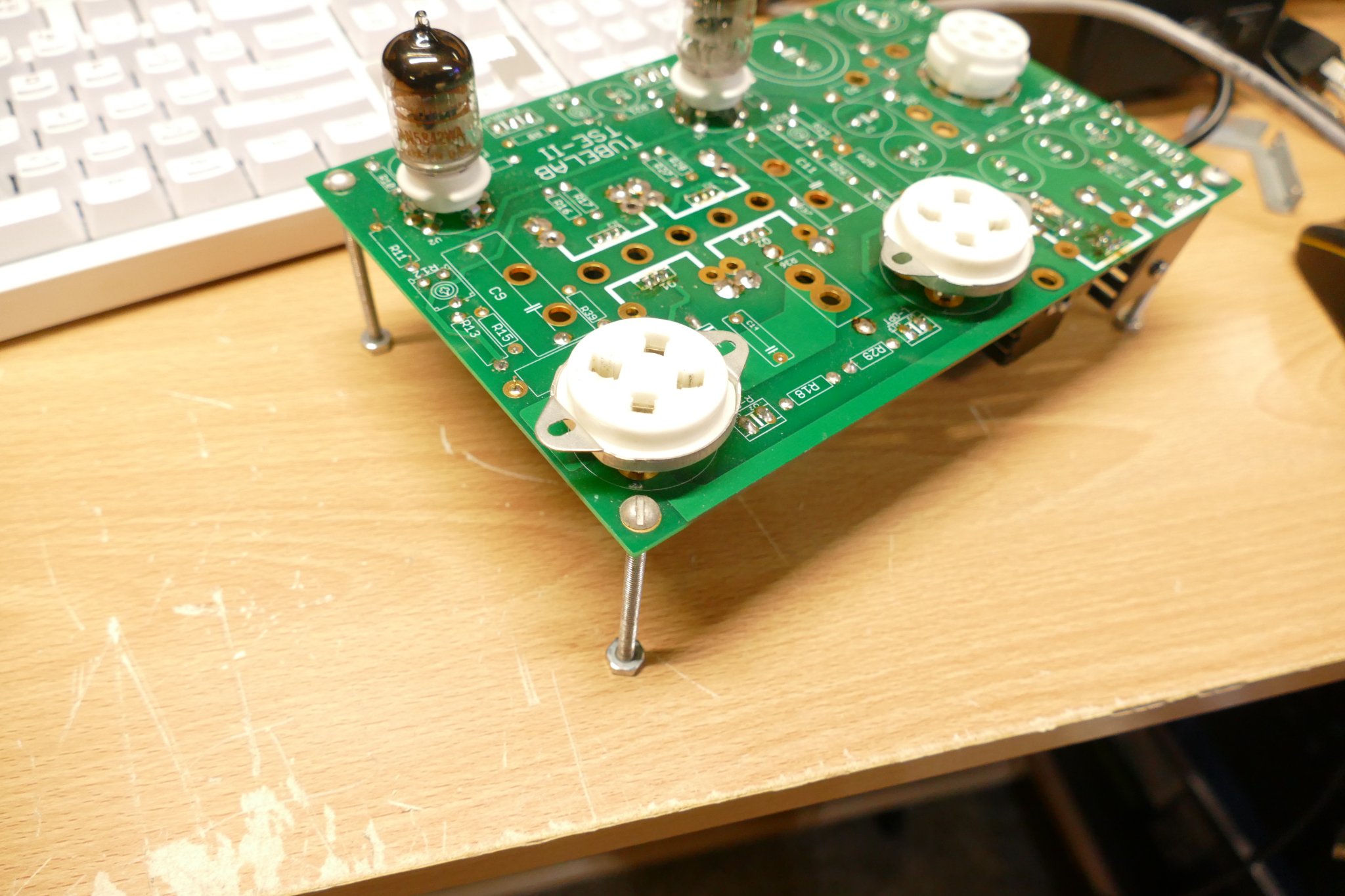

I went with sockets that bolt to the top plate
Not sure which ones you got but I use these and just ignore the flange. It can also be cut off as it is quite thin. I have built boards with all three types of sockets shown. The original amps used a ceramic version of the black bakelite socket that is still available in the goodcomponent link and on Ebay. They seemed to have vanished in the last few years. The flanged version that I have used is available at AES, Ebay and several other places. Mount the board to the top plate with enough space that the flange is just below the plate using the four corner mounting holes with spacers or multiple nuts. You should also use a fifth mounting support to prevent board flex when changing tubes using any of the many extra holes in the board except the two between the output tubes as they are connected to board ground.
https://www.tubesandmore.com/products/socket-4-pin-ceramic-chassis-mount

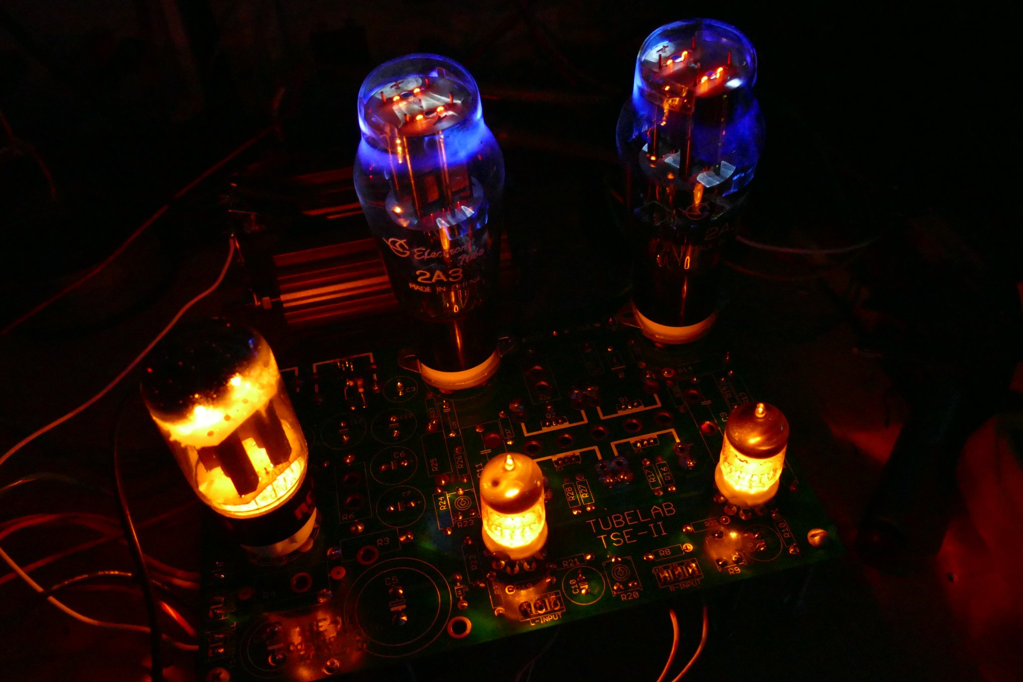

I have a TSE-II that's powered with a 372HX. I run some Chinese 2A3's WAY OVER SPEC at 70 mA each and My B+ runs from 375 to 390 volts depending on line voltage. Those tubes are 20 years old and have been in the amp for about 5 years. Ever see blue glow on the glass of a DHT? They still sound nice but have lost some of the glow.

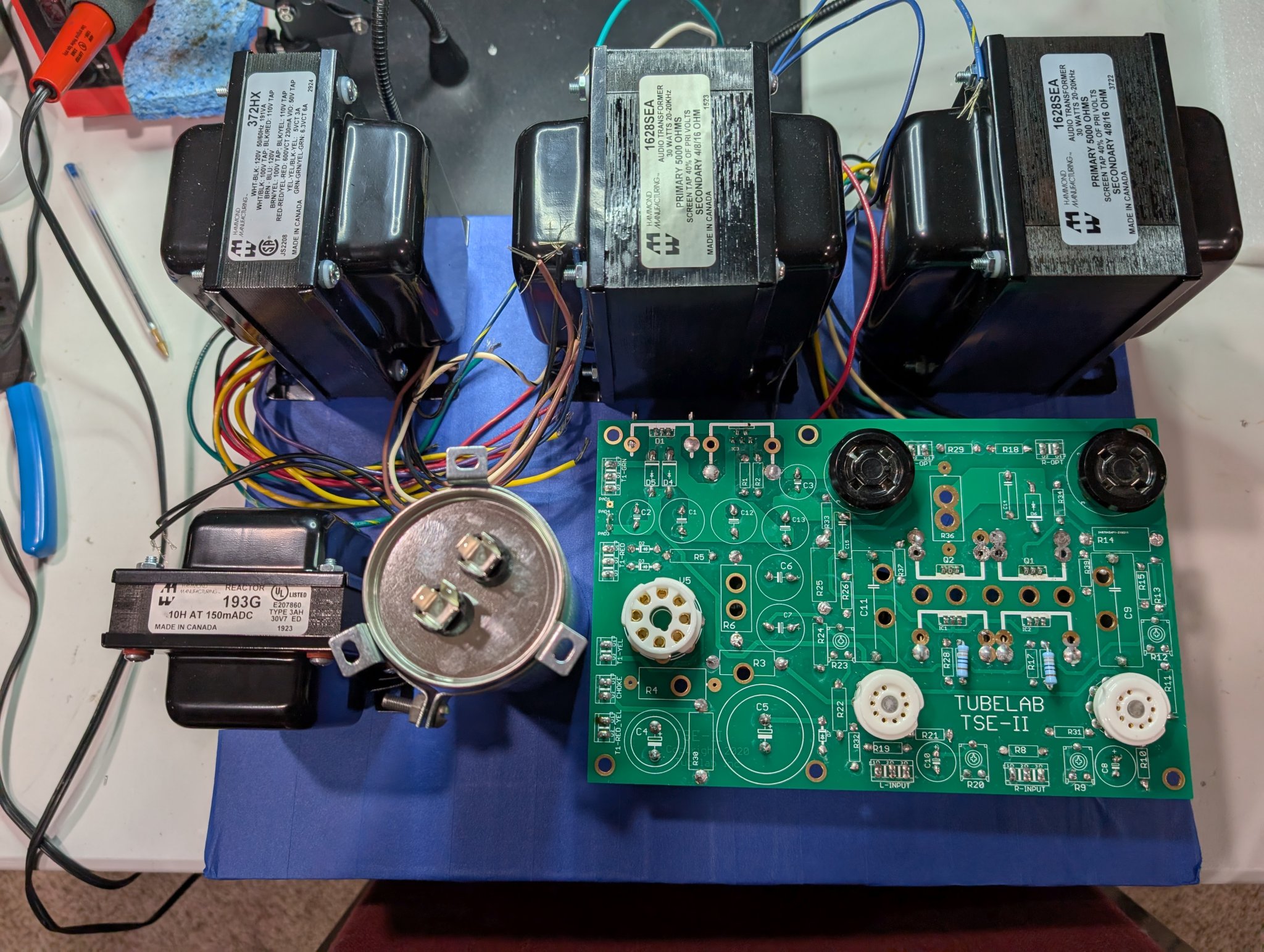

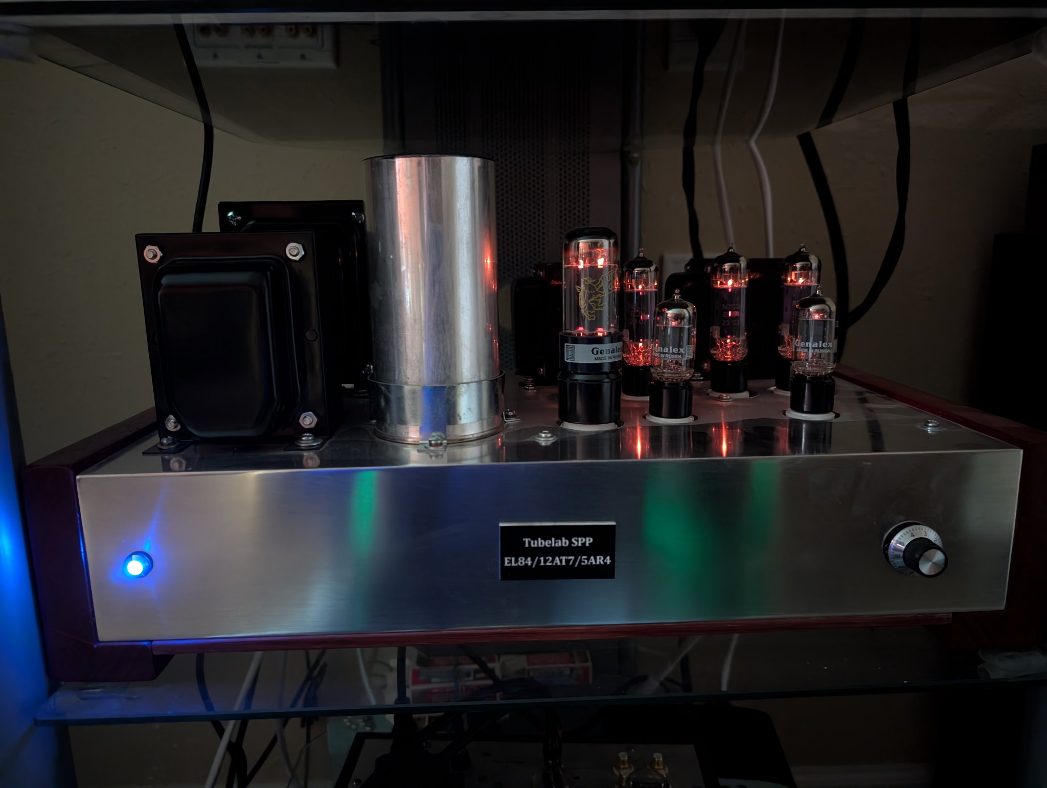

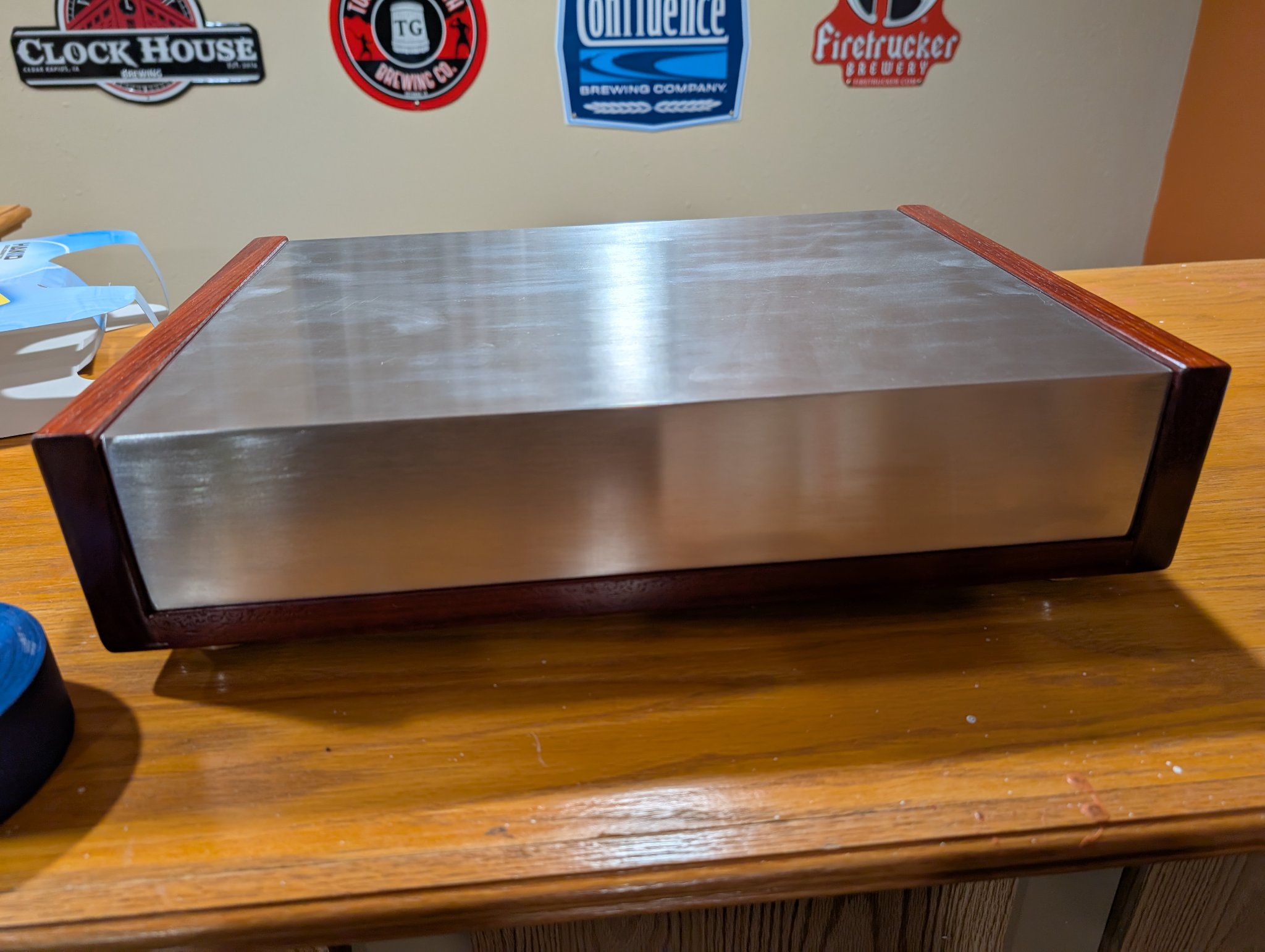

Here we go, getting the layout finalized for the TSEII 300B. Almost ready to hack up this beautiful chassis! Also included is a picture of my completed SPP, finished last year, by far my favorite amplifier I currently have!
Using all Hammonds
Main transformer 372HX
Output 1628SEA
193G choke, may be a little large, we will see
Mundorf supreme coupling caps
