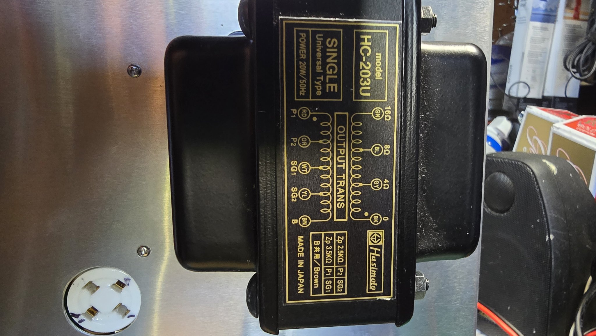

I have a question, what are o think about this trans.
ISO FC-40-3.5S ?
Is this a good choice for this project?
ISO FC-40-3.5S ?

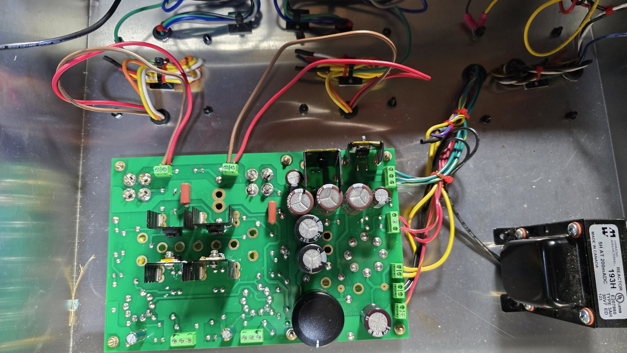

Nevermind, figured it out. Had one side switched around. Now time for testing and adjustments.
Made these when I was building the TSE-II. Hope it helps.
