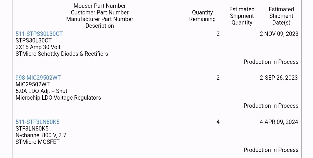

George,
Sorry that you've had to fund the business and sorry to see your business go.
It looks like BOM 1.2 is good from a Mouser/Digi-key stock standpoint?

Did you check octopart.com?
I have used STF3N80K5 as replacement.
Newark has the regulator.

Make sure you get a 2 or 3 watt part for R5, instead of what’s in the BOM.
Thanks for the tip and suggestions, will definitely check those parts out.
Also pay particularly attention to the power transformer you select. Going with George’s favorite Hammond is the easier route.

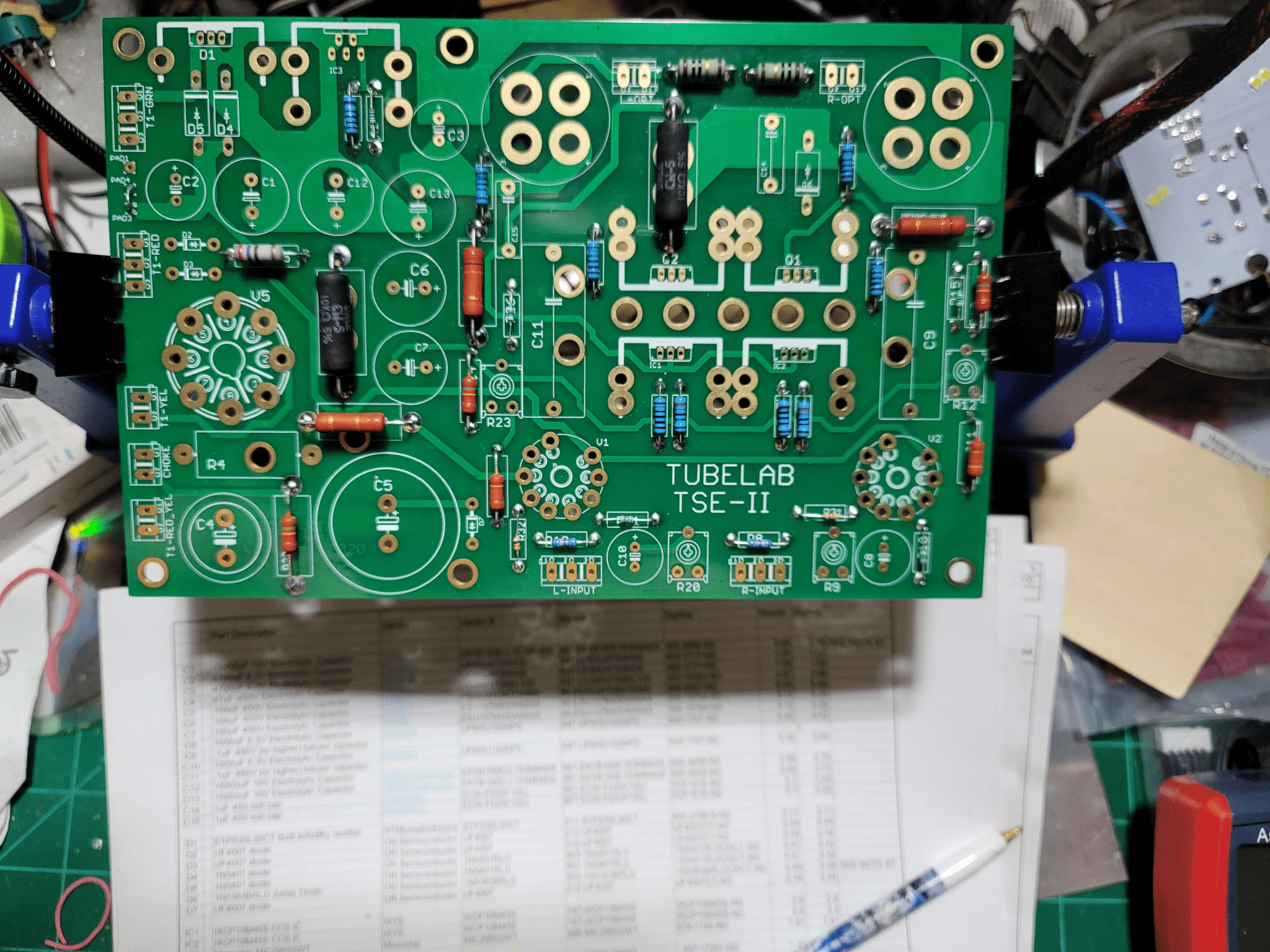

Hi Everyone,
Ok I am stumped. I thought I had found the wire diagram for this but lost it and have just been through Tubelab site but am missing it. I am wiring up the TSEII using RCA inputs. I am using a pre-amp and not a passive volume control. I think this is correct:
L Input 1 - rca Input
L Input 2 - rca ground
R input 3 - rca input
R input 2 - rca ground
Is this correct?

Here's how I connected mine- the negative is marked with a straight vertical line, positive is +.
Correct. L-Input 1 and R-Input 3 are the inputs, the rest are all grounds.

Happy New Year, everyone!
I've just treated myself with a nice Mouser BOM order for my new TSE-II board. This is will be a very long term project for me, as I really love the SSE that I built a few years ago and I have other priorities. I just wanted to secure all the parts before some of them once again become unobtanium. I'll be making very good use of this thread over the coming months (maybe years). Thanks to all!
