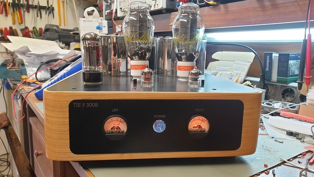

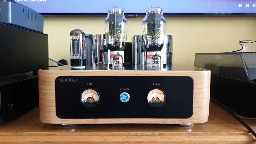

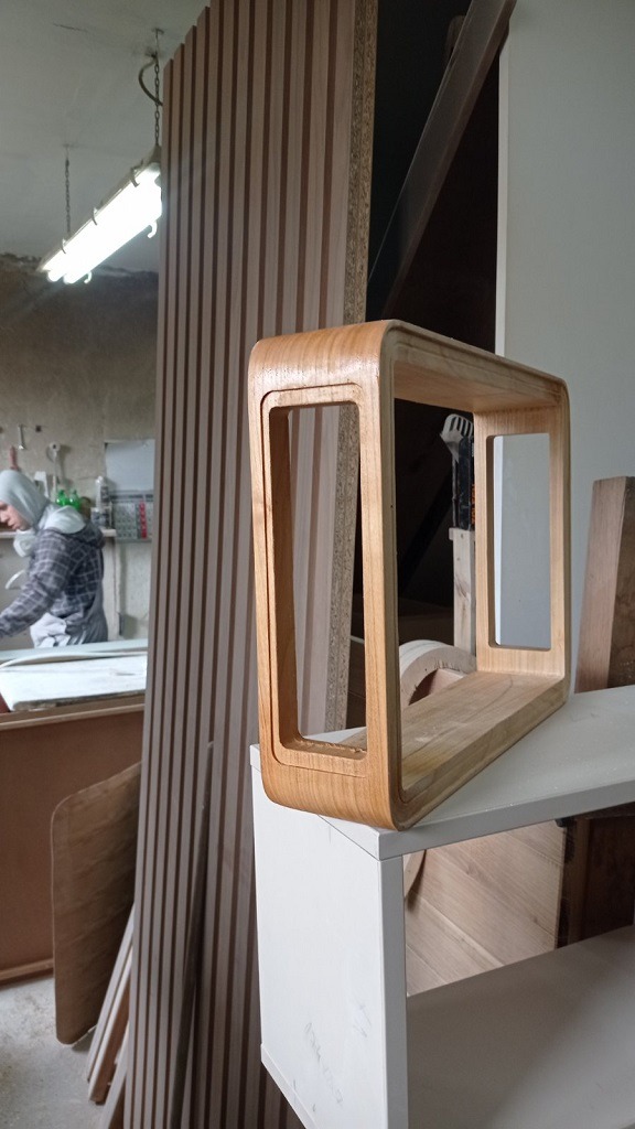

Awesome enclosure. Was that make or buy?My amplifier during the final tests:
And ready for listening:
Where'd you get the meters? I'm having trouble finding ones that small.
