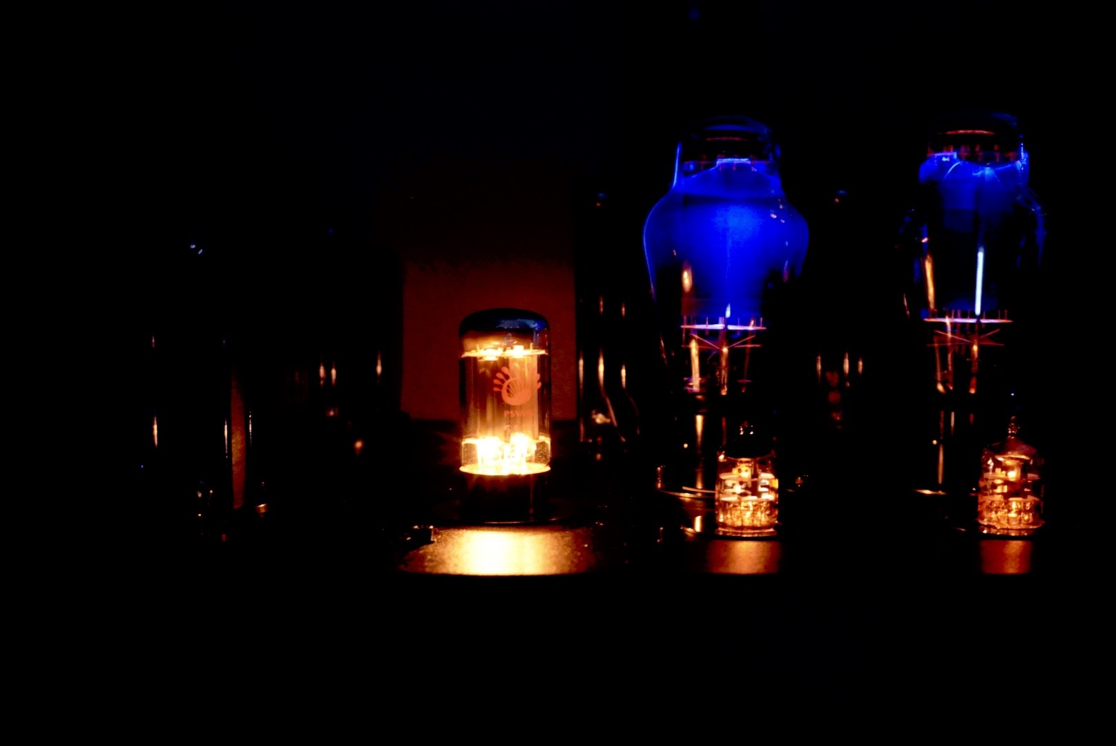

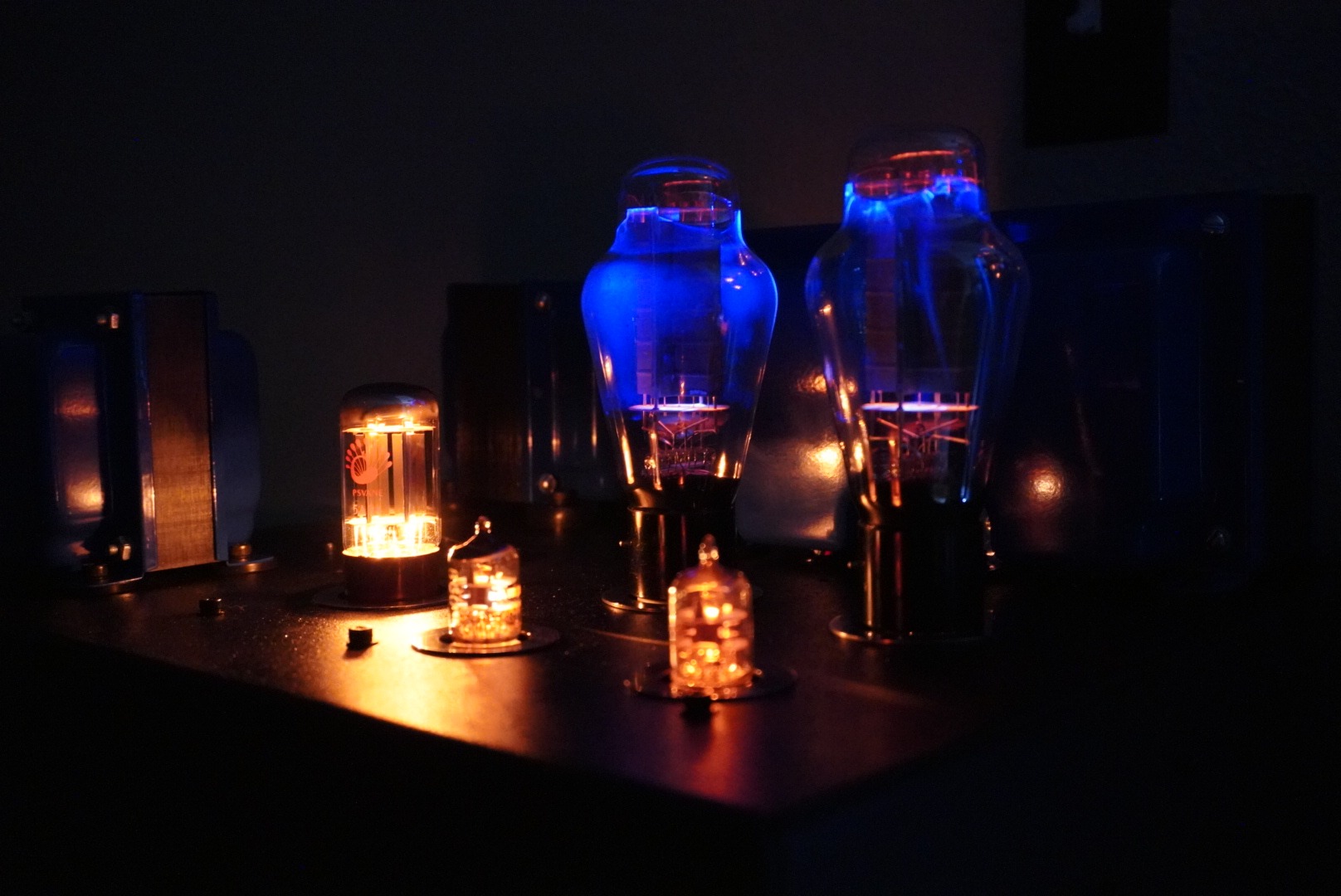

First, I went back to a 5AR4 rectifier and I restored the motor run cap.
Minimal rework of the wiring as well.
Then, mandatory shots of the thing at work:

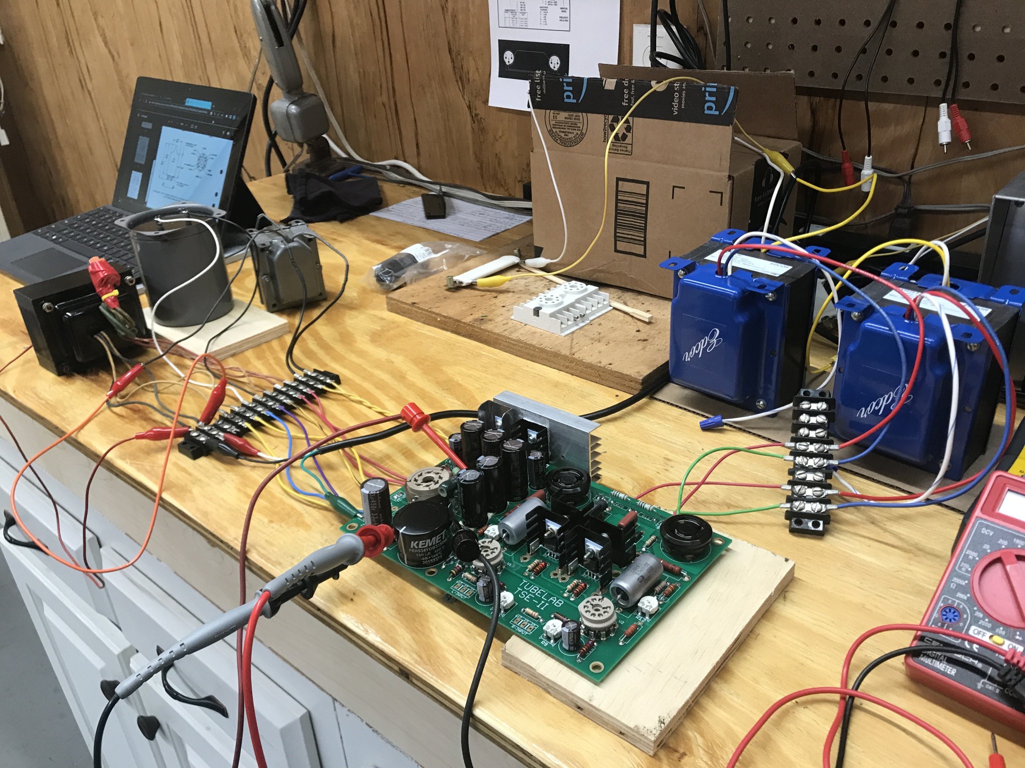

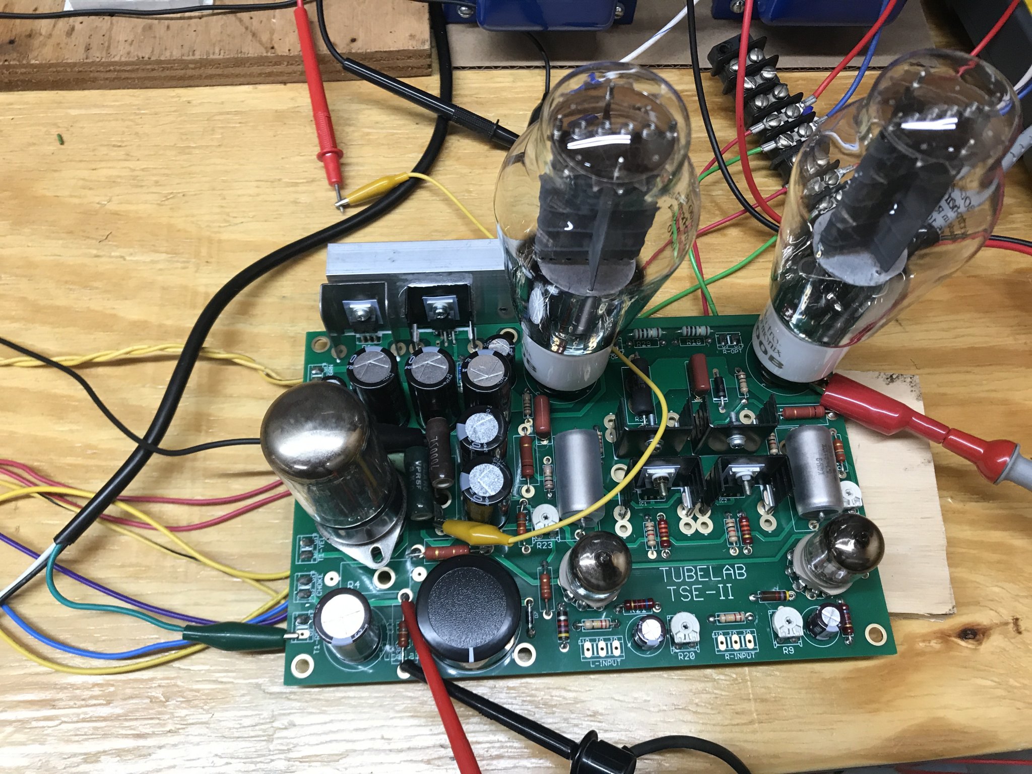

I have upgraded to a pair of EML 300BXLS tubes and now I wanted to raise B+ to 500V.
This is giving me some problems with the negative supply.
The positive supply is no problem, I have replaced all electrolytics with 900V film caps.
I just forgot about the 2 100uF 450V electrolytics in the negative supply and blew C6 and also R5. I have tried changing the value of R5 in an attempt to lower the voltage over C6, but that didn't work.
I have a 470-0-470V power transformer with separate 6.3V and 5V transformers, so it is possible to reduce the 470-0-470V a bit with a bucking transformer without affecting the heater voltage.
I guess I could try to replace the 100uF 450V with a higher voltage film cap, but it looks like there is more on this negative supply than just the bias.
So I am not really sure where to start, looks like there are more modifications needed than I expected.

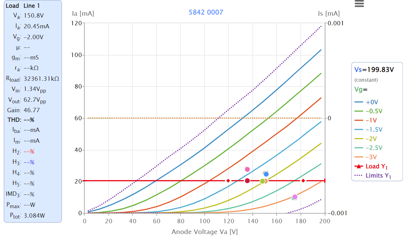

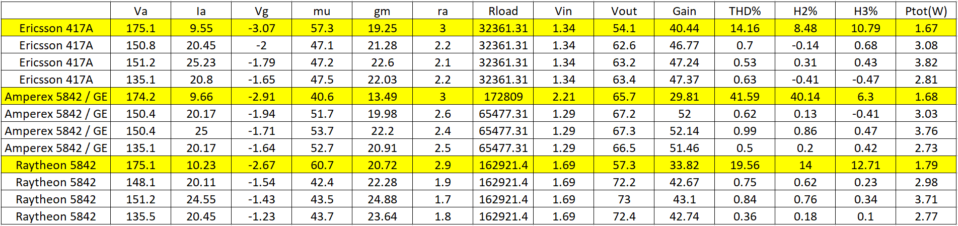

Separately, I've been looking into building a 5842 headphone amp and recently also finished a uTracer and have been curve tracing many of them.
Looking for the optimal operating point, I am getting fairly poor results with Va=175V Ia=10mA similar to the TSE points.
This is true for Ericsson 417A, Amperex/GE and Raytheon 5842 which do measure diffierently.
Might be an operator error on my end or not applicable to the TSE due to other reasons, but it seems like lower voltage and higher current leads to much less distortion. It is only a single resistor change and re-adjustment of the trimmer resistor so could be worth a try at something like 135/150V and 20mA.
(The flat load line assumes using a CCS)

Interesting to see that 175V is not the best voltage for the 5842. I will probably not change it on the TSE-2. I also have an U-tracer, so I could try to measure the 5842 myself when I find some time.
That would be some interesting finding.
But the Amperex performance at 175V is very appealing in terms of H2%.
I firmly believe even harmonics distortion is the main appeal of tube amplification.
If overall distortion must be reduced to the max, SS cannot be beat.
I lost the thread for that project, how is it going?
