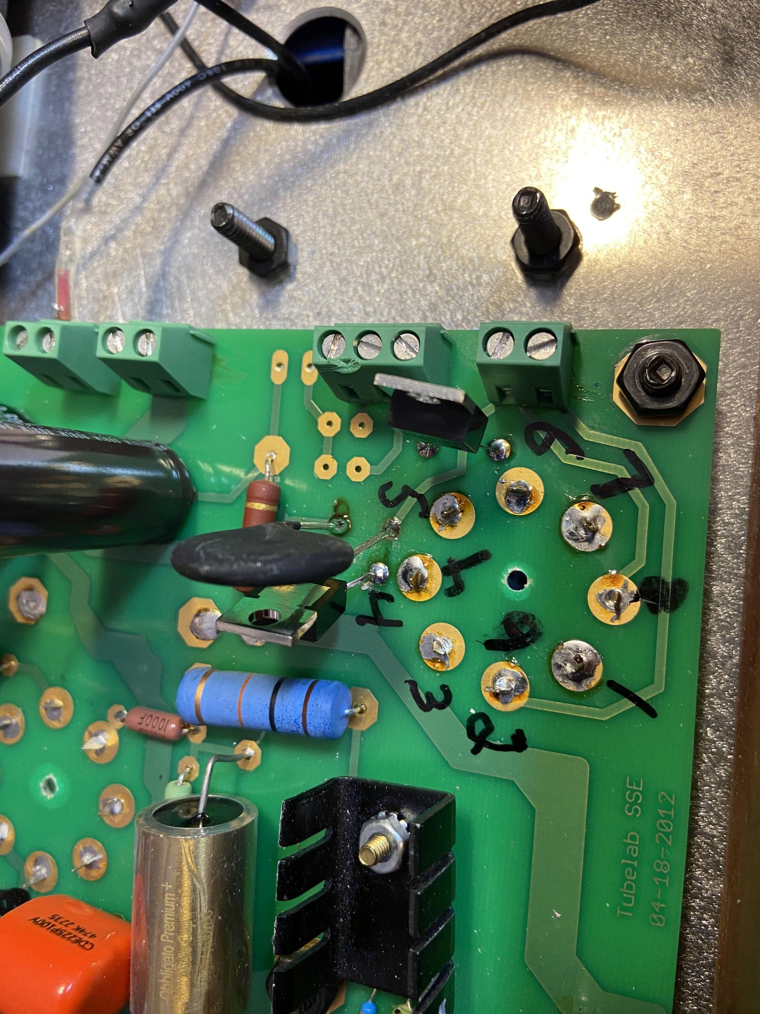

George,
I've been going over and over my wacky negative 700 vDC on KT66 Plates SSE build. Tested the output from the 5AR4 every which way, testing with and without choke and supplemental cap, etc, etc.
I have a printout of the schematic I've been referring to but just now I went back to your "schematic" page and re-read the first paragraph where it says:
"The mode (Triode / UL) switch, the Cathode feedback switch, the standby switch, and the rectifier switch are optional, and should be hard wired into the desired position if they are not used.
So the switches need to be installed, not just left out? I passed right by them on the BOM which reads, "USED IF DESIRED". Still, I can't see how the full voltage of the 6K7VG is reaching the outputs.

Is TR1 left open keeping voltage from reaching rectifier pin 8?
There's no TR1 on the BOM. Is a jumper needed? Sure looks like it.
The new board has three components added to cope with the junk 5AR4's that came out of all three new production factories around the time I had to change the name of the board to keep the lawyers away (2012). Diodes D3 and D4 should be a 1N4007 or UF4007 and TR-1 should be a CL140 inrush current limiter. All three can be replaced with wire jumpers and the new board will be exactly like the old board. Adding the parts will help any 5AR4 live longer though.

I'm so certain I got the polarity right I'm perfecly willing to wait until you can look at at the inverted install
photo ;-)
The Schottky's have their backs to the front just like the CCS MOSFETS and the CL-90 is a resistor, no polarity except at the AA Tweaks Asylum.

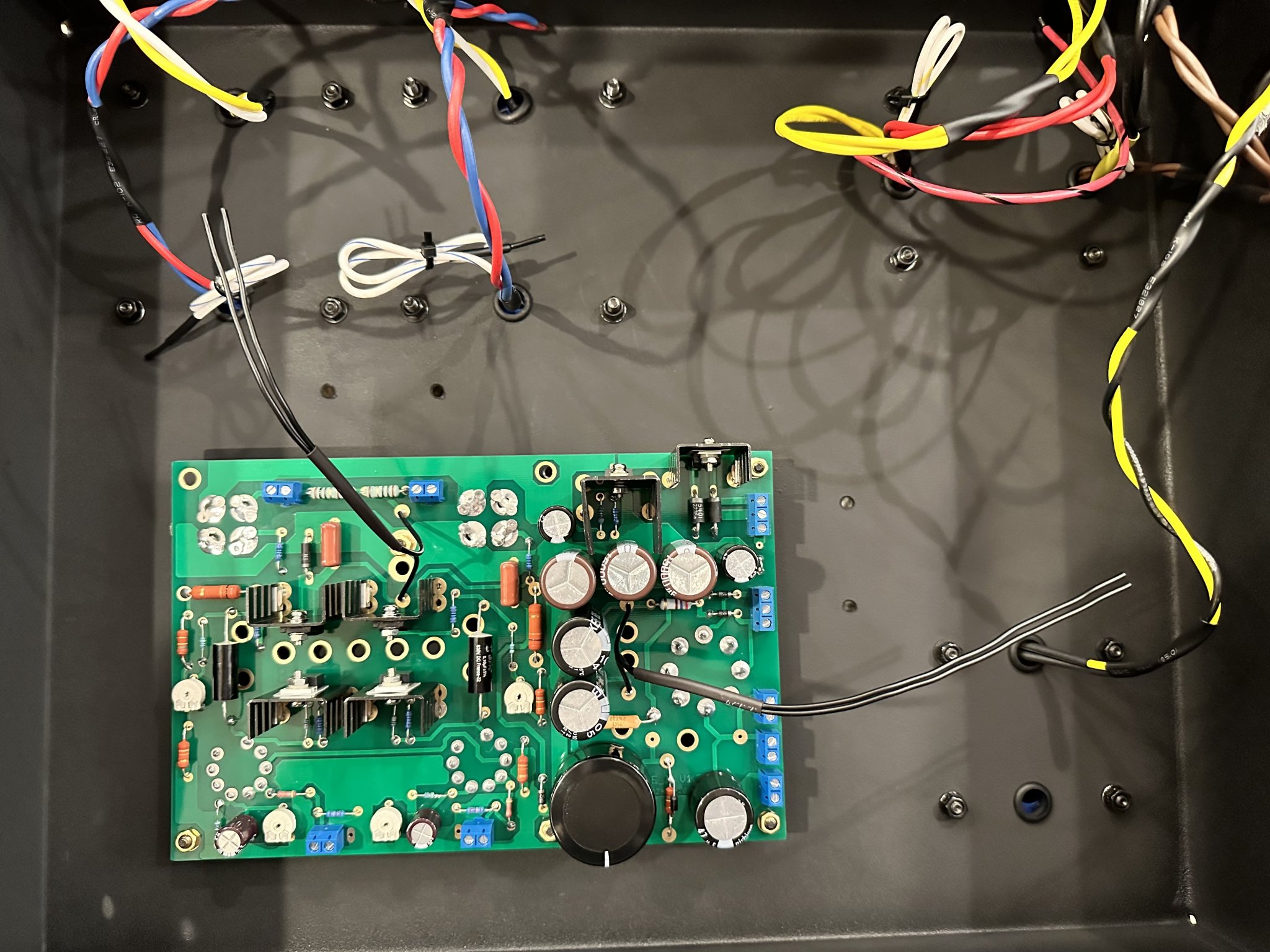

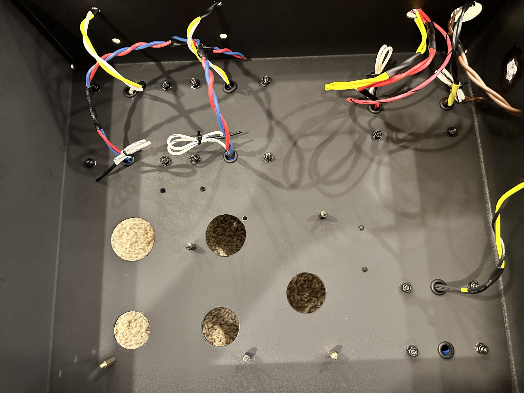

So, chassis fabrication is almost complete.
Thinking about wiring now..
All of my secondaries have CTs, I am planning to hook them all to the chassis star ground bolt without any detour.
Is that fine?
RCA input will be grounded via the board.
The board will have a single wire going to the chassis star ground bolt. (from one of the T1-RED_YEL pads)
The negative speaker binding posts will also be connected to the chassis star ground bolt.
The chassis star ground bolt will be connected to IEC inlet earth pin.
Is there anything wrong with any of that?
Lastly, I am wondering if all the transformer bell covers and cores should also be connected to the star ground chassis bolt.
Edcor seems to prefer to have the bells isolated from the cores, so I guess it would not make sense to lead them all to the star ground chassis bolt.

Do NOT ground the CT on the 6.3 volt or the 5 volt windings. Grounding the 5 volt CT will short your B+ to ground likely ruining the rectifier tube. The CT on the 6.3 volt winding is controlled by a jumper setting on the board. The CT must be connected to the terminal on the board for this to work.

True, the 6.3V CT is not used in a 300B build, but it cannot be grounded. It should be left unconnected or connected to the PC board terminal where it does nothing. The 5V CT must also be left unconnected. The HV CT must be connected to the board where it is grounded. Connecting it to chassis ground and the board T1-red-yel terminal is OK.
Thank you, George. I’ll go with that plan.
I’ll leave the transformer cores and covers alone. After looking at 2 dozen pictures of builds by various people, no one bothers with those. The code may disagree, but I figure they would have to be made wrong in the first place to be a danger.
Of course, the chassis will still be earthed anyhow.
I am not happy with my PT wiring, but I painted myself in that corner when I picked that large case.
