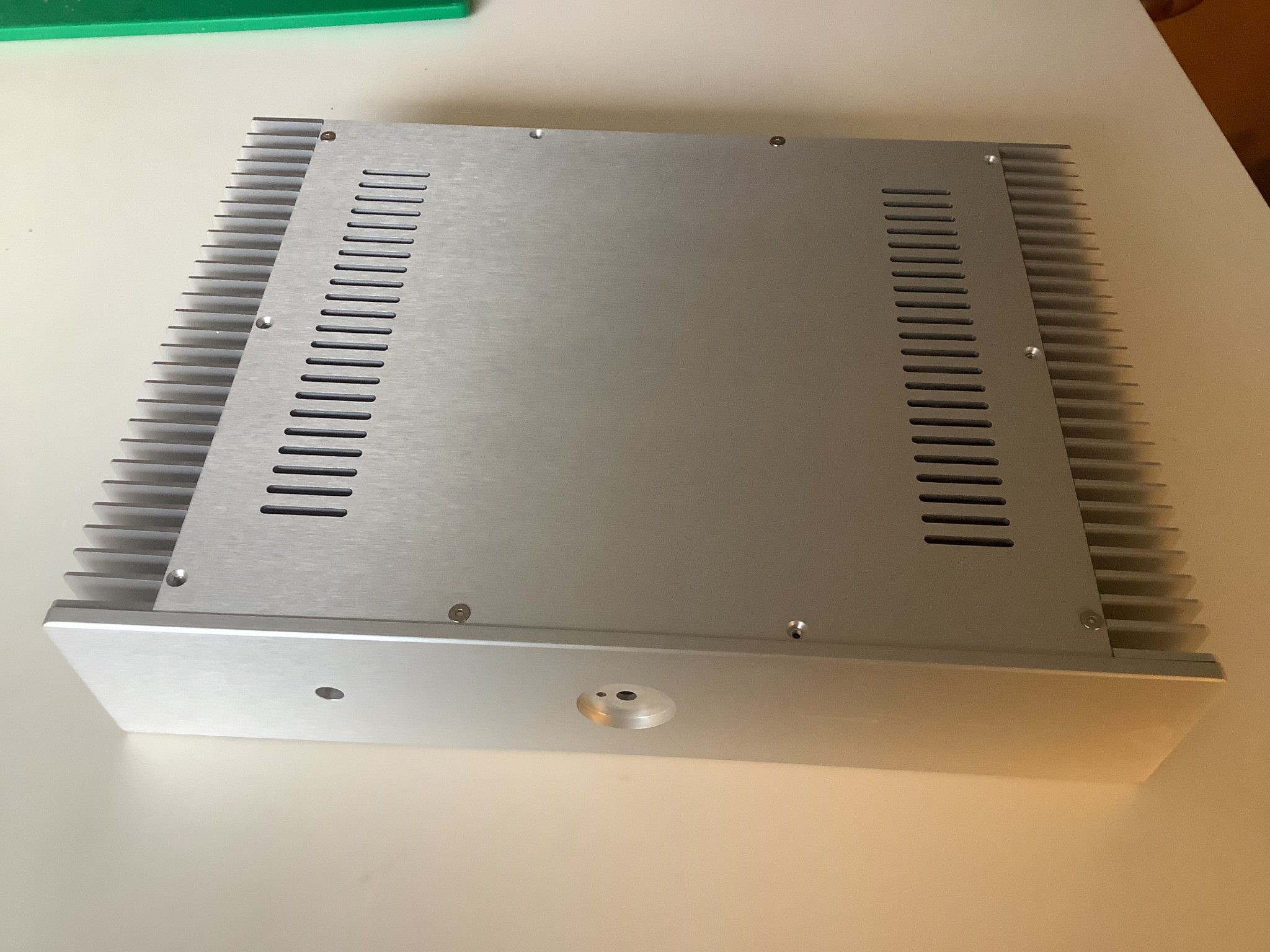

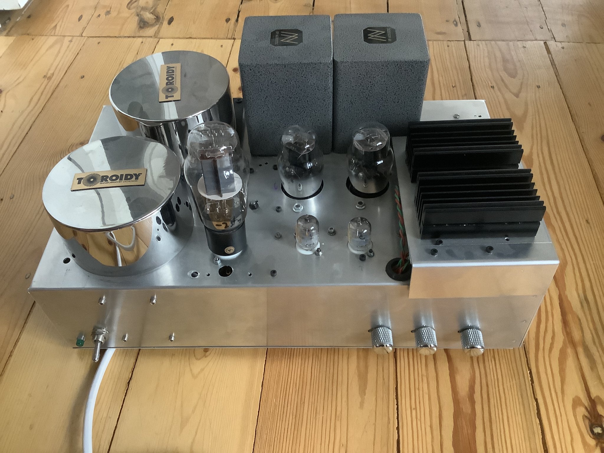

I finally got my new chassis and I’m ready to build my new Tse! The old one died a few years ago after extensive modding (second picture). I‘m not going to mod anymore (George : I promise!). I am hoping to take advantage of those amazing heatsinks on the new chassis by moving hot components off the board. Which should I move? IC1/2 R36 Q1/2? IC3 and D1? Thanks! Henry
