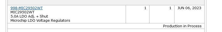

Thanks George. I read the whole thread the last couple of nights (Probably retained too little from reading past midnight).
I will go back to 1197.
The MIC29502WT is on back-order till June IIRC at Mouser.
I have two of the TI parts coming so I will test with them to see if they can hold up for 5V at 2.4A with resistive load.
