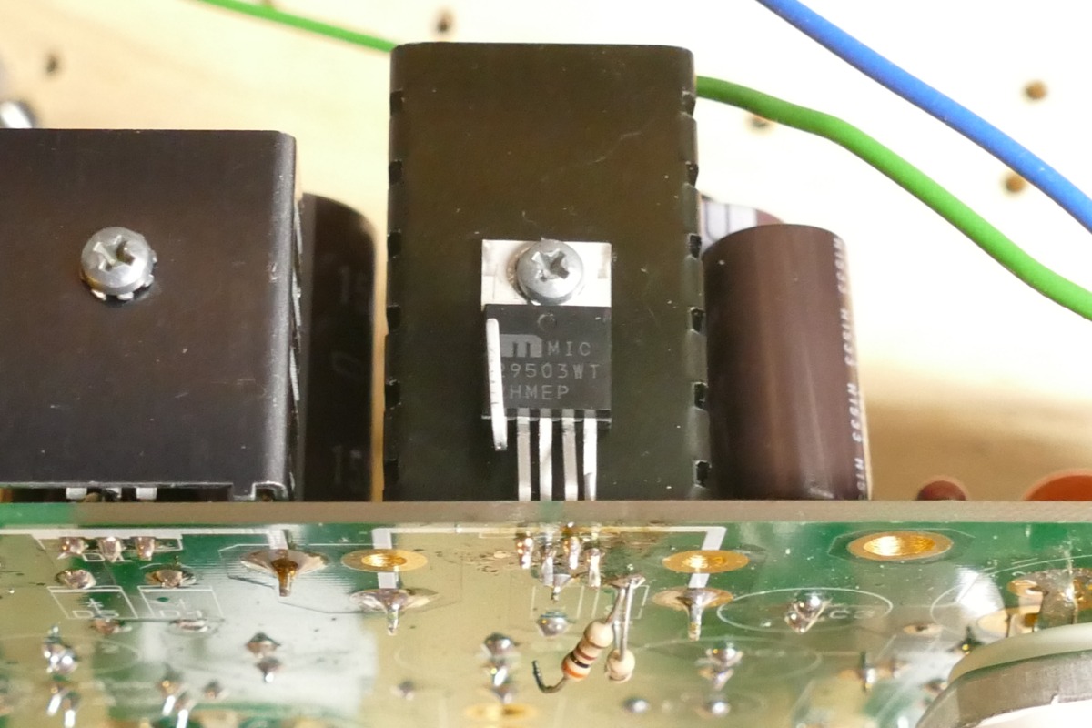

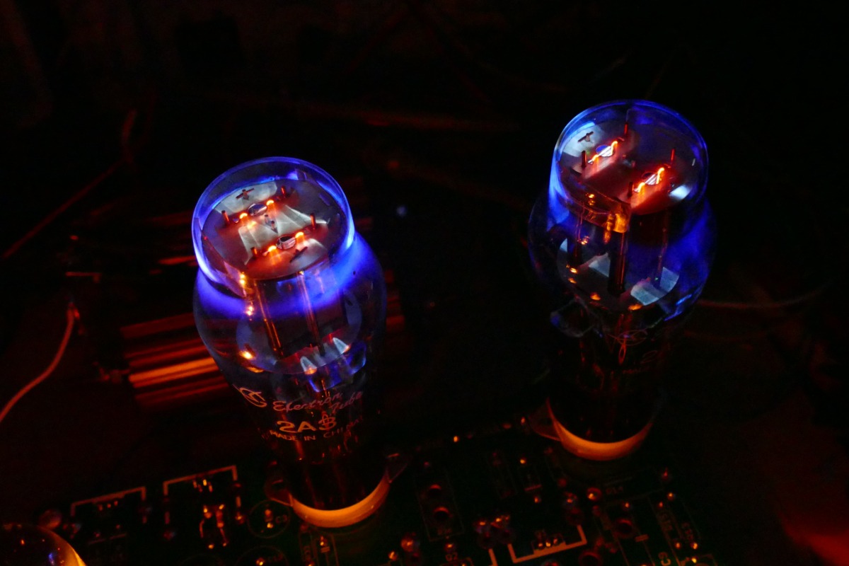

I got the Micrel MIC29502BT parts that I ordered from Ebay today. They came with formed leads that were not compatible with the PC board and two pins were cut shorter than the other three. It was however rather easy to straighten them and rebend them to fit the board and the existing heat sink. The board had 4.95 volts of filament voltage with the Microchip MIC29502WT and 4.97 volts with the Micrel MIC20502BT part. I let it play for about an hour with 300B tubes and no issues were found. My line voltage was bouncing between 126 and 128 volts at the time with a Hammond 200 series power transformer. The raw DC into the regulator with no output tubes installed was 9.4 volts which would blow the 6 volt TI parts so I may not test them.
I have not yet connected it up to a Variac or tried 2A3's on 2.5 volts. The only thing resembling a date code on these parts says 9818 which could mean the 18th week of 1998. The old Micrel data sheet that I found is dated 2012. Upon a more careful inspection it clearly spells out the difference between the BT and WT parts. The BT parts are not ROHS compliant and the WT parts are, see the table on page 3. ROHS came into existence in 2003, so these could be old parts from 1998.

Once straightened, the leads will be of different length with the shortest being about 1/8 inch shorter than normal. They fit on the heat sink that was already in the board which had a slot for the screw. They might not fit if there was a single hole for the screw.

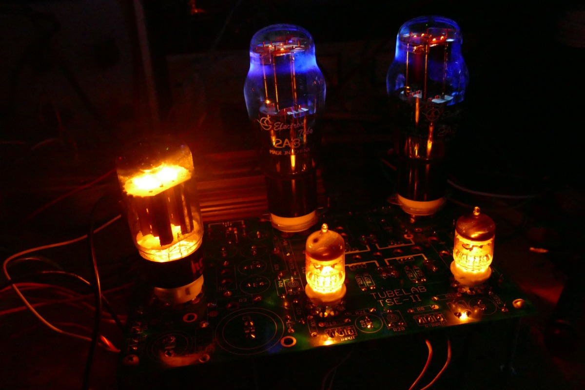

The Micrel MIC29502BT parts have been tested with 2A3 tubes. They work fine.

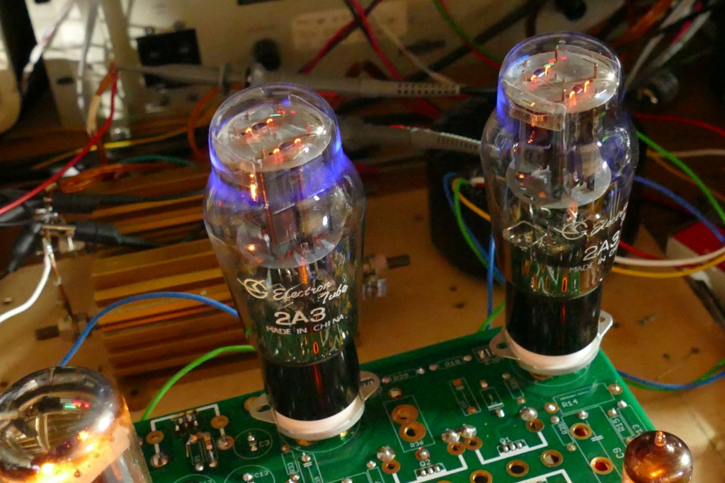

Many have grown accustomed to seeing a harmless blue glow ON the glass of a sweep tube or even a 6L6GC that's being run at a high plate voltage. It may even dance to the music if it's played loud enough. How many people have seen that blue glow on a DHT? These 20 year old Chinese 2A3's are eating 400 volts at 65 mA each. Yes, the glow dances to the music.

The MIC29503WT parts also work fine. Pin 1 must be bent out of the way and NOT inserted in the board, or simply cut off. again PIN #1 must NOT be connected in the TSE-II board, and it must not touch anything. See the first picture.

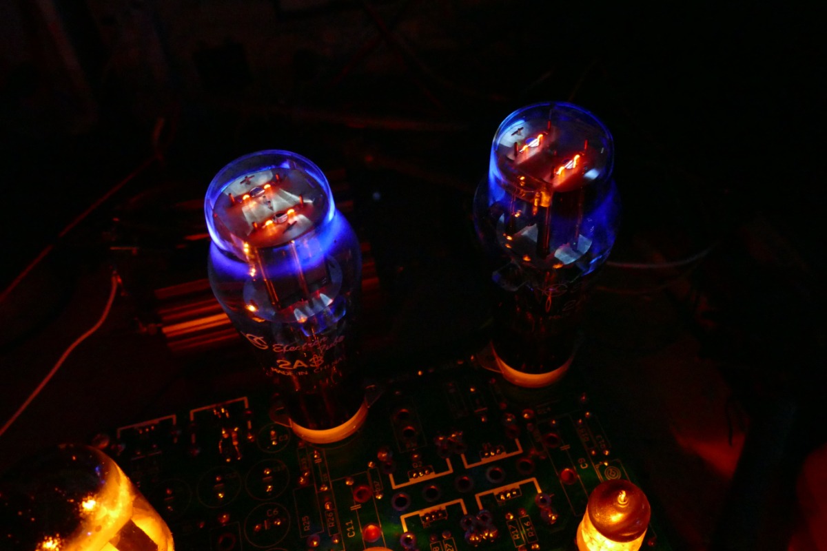

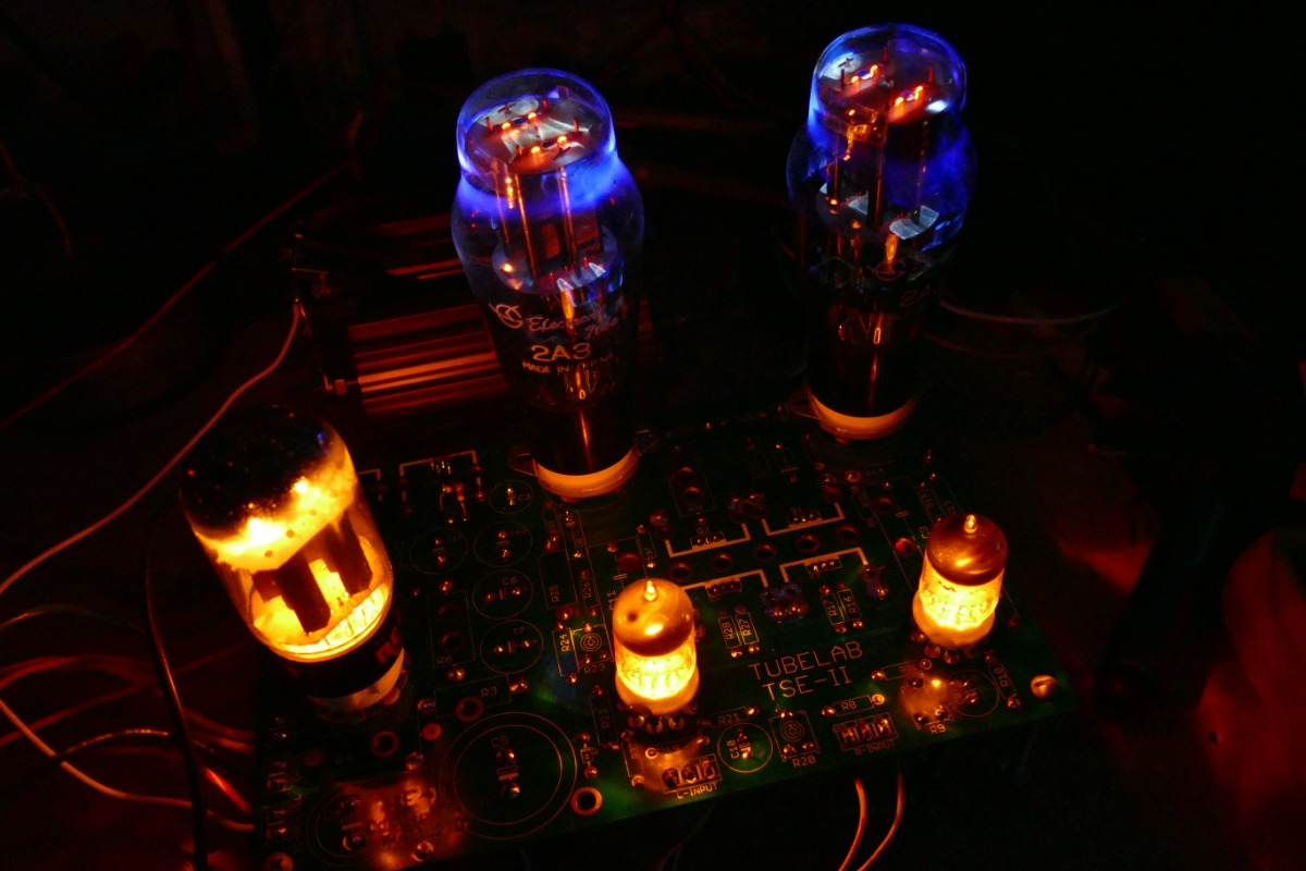

It is now totally dark, so I got some better glowing 2A3 pictures too.

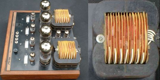

Assuming I'm going to use an 845 (unless someone convinces me otherwise and I'm open to all criticism) I come here to ask for help in building an ultra linear transformer. I can do it at home. I have already renewed some conventional and toroidal transformers.
I need help with these questions:
1° What voltages are most suitable for the 845? (I would never skimp on iron dimensions or copper)
2° What are the ideal dimensions of iron? (E/I or C)? GO or GNO?
3° I would like to follow the advice of this article that says it is possible to increase the number of turns of the primary, improving the frequency range? In order not to compromise the secondary specifications, they suggest increasing the wire gauge (this would make the transformer heavy which is not a problem) the idea is that it does not saturate and has an inductance close to "perfect" I would be satisfied with 80 Henriques.
Note: I intend to section the turns and deposit them vertically (90°) from the iron, interspersing with the secondary (Pi winding).

Have you ever worked with high voltage? Have you any experience winding output transformers?
I suspect there has been no response to your post because what you propose seems unrealistic and potentially dangerous.
You understand that ultra-linear only applies to tetrode or pentode tubes? The 845 is a transmitter triode.
https://en.wikipedia.org/wiki/Ultra-linear
Additionally, the 845 is a scarce, physically large and expensive tube, and usually is run at high voltages like 800 or 1000 volts or higher. https://frank.pocnet.net/sheets/049/8/845.pdf
How much experience do you have with vacuum tube projects? Working with voltages in this 1000V range safely requires special techniques and experience - not for the novice. Ok for George yes (Mr. Tubelab), me maybe not, and definitely not for someone's first project. There is a thread at the top of the DIY Audio Tube Amplifier forum about safe practices that you should read - https://www.diyaudio.com/community/...s-general-and-ultra-high-voltage.30172/latest
Maybe you should read all of the original Tubelab site, and do some more reading and research.
