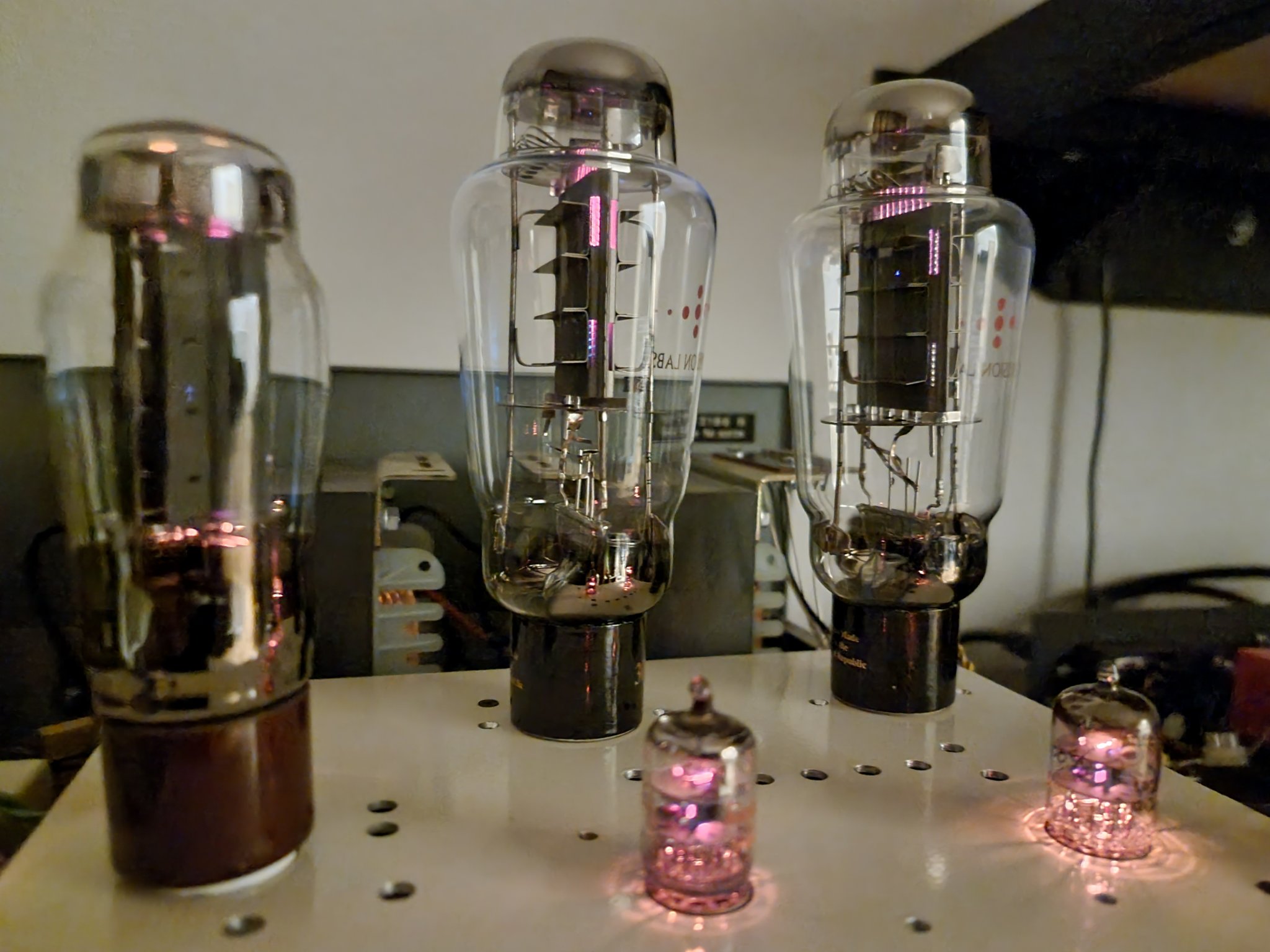

I have just bought a few GZ37 and would like to use one with the TSE-2. Has anyone tried this yet and did you change the first capacitor value?
I modified the TSE-2 for the GZ37 and also a pair of EML 300B XLS tubes.
I changed the 47uF cap for a 10uF 900V cap and the 150uF cap for a 200uF 1000V cap. I removed the motor run cap.
I also changed the 1uF 450V cap for a 630V version.
With the 300-0-300V tap I was getting a B+ of around 380V before modifying the caps with a GZ34 and EH 300B.
The GZ37 gives about 10V less B+ than the GZ34.
Now I am getting only 395V B+ with the 350-0-350V tap. I was hoping to reach about 450V.
I will try a 383-0-383V transformer, but I don't think it will get me to 450V.
Any suggesties what I can do to reach 450V?
Not sure if I can use much more than the 10uF first cap with the GZ37, but I have some 22uF also.

How much current are those big XLS type consuming?
You are going from 370 Vdc to 395 Vdc (+25V) with an AC supply increase of 50V (70Vpeak)?
Smells like increased current to me (the winding resistance increased a bit too going from 300V to 350V on the same PT).
You are moving to a larger rectifier because you need the extra current?
Finding no GZ37 graphs, I looked at the GZ34 graphs: to reach 450Vdc at 150mA or more, you need 400-0-400, depending on transformer resistance and capacitor value.
The GZ37 is generally used with a 4uF cap. 10 should be ok, but you don't want to burn out these rare tubes too fast.
Because I only reached 395V, I have them at 60mA. The goal was 450V and 80mA.
The transformer can deliver 250mA, so it should be fine.
I don't need extra current, I just liked the look of the GZ37 and was able to buy 4 of them cheap. I also was running out of Mullard or Philips GZ34. Probably
with the GZ34, I would have reached 405V, maybe 410V. I could try this.
Unfortunately I don't have a 400-0-400V transformer and my 383-0-383V transformer is 180mA. With the 300B XLS at 80mA each, there is not much reserve left. It is a Tektronix transformer, so it probably will deliver a bit more than 180mA. Hope this transformer will give better results. I have 9 of these transformers, so I can afford to blow one up, but hope not.
