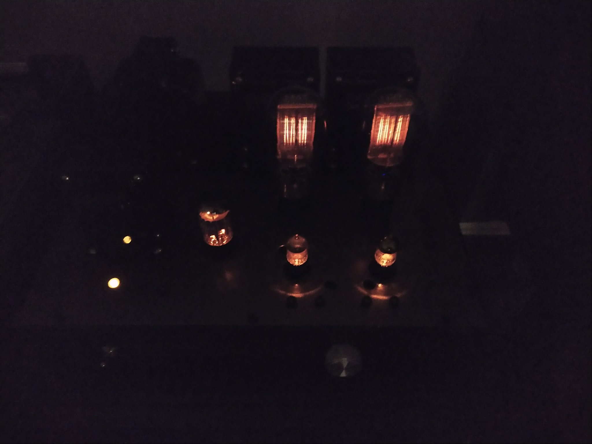

Thank you Francois!Excellent work and very nice build! Congratulations.
JustMikey: Those 300B's look sexy..what are they?
...and the off-board cap is interesting......a motor-run substitute?
Long live the TSE-II!Please rename this thread to: After a 14 year run, the TSE WON'T die!
The 300B are Sophia mesh plate that I bought at good deal about 10 years ago. Went in the stash and finally had a chance to use them. Also tried some EH gold grid, gold pin to that I bought about 2 years ago. Both sound good. EH a bit darker but a good full sound, Sophia a bit airy and lighter but a good detailed sound. EH don't look like much, the Sophia light up beautifully at night.JustMikey: Those 300B's look sexy..what are they?
Only two caps off board. One is paralleled with 100R resistor to "lift" the signal ground off the chassis and main earth ground - that's the little dark square one in the back. Other one is on the tiny pcb with a diode to take the 7vac from a junk box filament transformer I had and give me 9vdc to run the little fan. No motor run in the actually amp ps, only what's on the TSE-II board.
Me too!! very nice. I think you need a GZ37 rectifier...would go good with those tubes.....hahaMesh plate 300Bs at night. I love that look.
Looks like Sophia makes a ST glass 5AR4 equivalent rectifier ....

From what I understand, the 274 has a very low first capacitor limit... something like 10uf and a lot less current ability. I thought about them since I like the look, but when I did the math I realized that I would need to parallel two them and get a higher voltage PT to keep the B+ up.Looks like Sophia makes a ST glass 5AR4 equivalent rectifier ....
