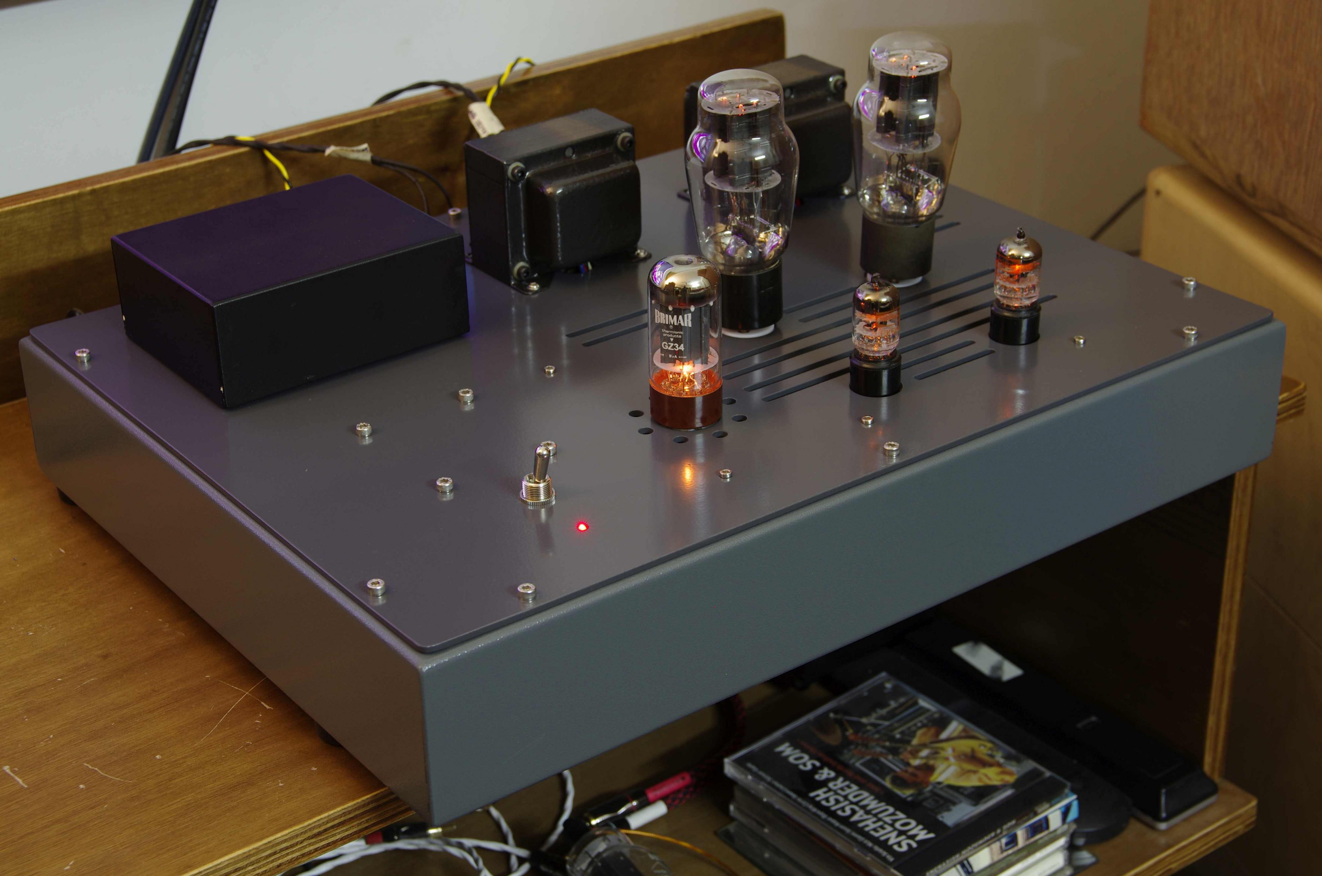

Fired up the TSE-II - 2A3 today. The tubes biased right up to 35ma with 323 B+. I had the 300b up till now and have a chassis to build.
Before the TSEs I completed an Aikido Octal (6SN7) which was also bare board. They are a fabulous combination.
The preamp is posted on another Aikido thread here. I don't want to post in both posts.
Need help with the 5842s, they are at 199 & 201v. Should that be reduced ? The B- is 165v.

I've run the 2A3 for about 20hrs. The voltages are all stable. There's not much info on biasing the TSE-2A3. The rectifier and B+ are fixed, so should I raise the current. The 5842s are at 199 & 201v, thought I'd leave them as is for now.
B+ 323
B- 165
2A3 61v
2A3 35mA
Can somebody help ?
did you check this page:
Setting the Bias | Tubelab
The anode voltage of the driver tubes should be set to ~ 175 V

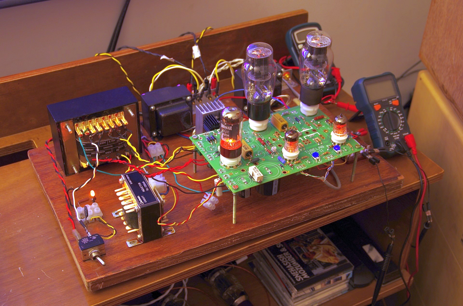

Thanks Pieroh. I redid the 'check-out' with the 2A3s and OPT disconnected. The 5842s are at 185v now. Looks much better.
B+ 310
B- 165
2A3 56v
2A3 45mA

The 5842 has a wide variety of characteristics. The parts listed on the BOM may not cover the spread of all tubes. If the adjustment pot is at one end and you still can't get do 175 volts, you could change the value of R10 and R21. I needed to go to 470 ohms for some tubes.
In reality there shouldn't be much difference between 175 and 185 volts, and some Raytheon tubes had lower distortion on 185 volts. Genuine WE 471A's tended to do best on 175 volts.
George, thanks for chiming in. There is some play left on both sets of trimmers. The B+ has dropped below 310 on a secondary of 300-0-300 which surprised me, thought I'd get ~ 320v.
Trying a different rectifier - 5U4GB (N.E.C). Had a Brimar GZ34 (current stock /model) earlier. They were bright Orange, the 'juiciest' glow among all the tubes 😱 The N.E.Cs look ok.

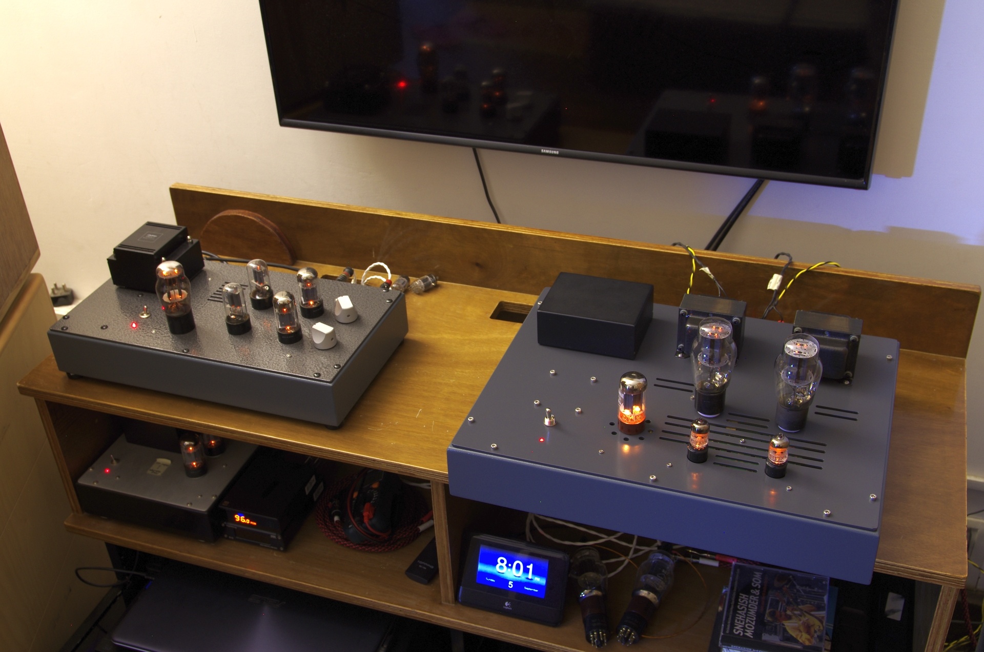

TSE-II (2A3)
Finished this long pending build. After about 80hrs the amp is running well.
5842 176v
B+ 290
B- 167
Bias 60ma
Its a different sound to the 300b. Not really a lack of bass as in different. No regrets really.

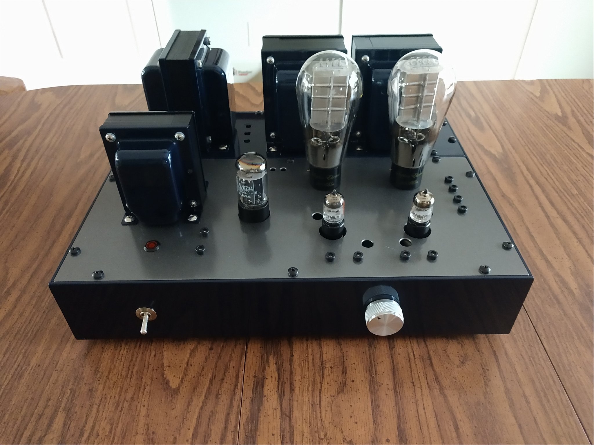

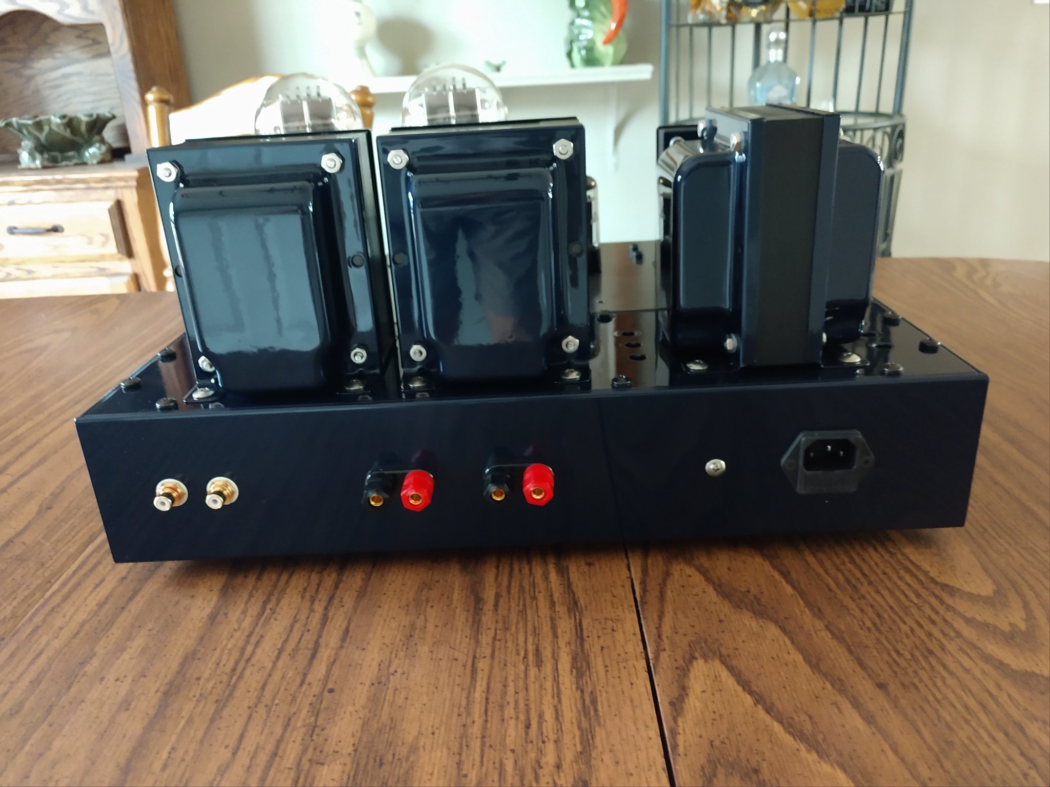

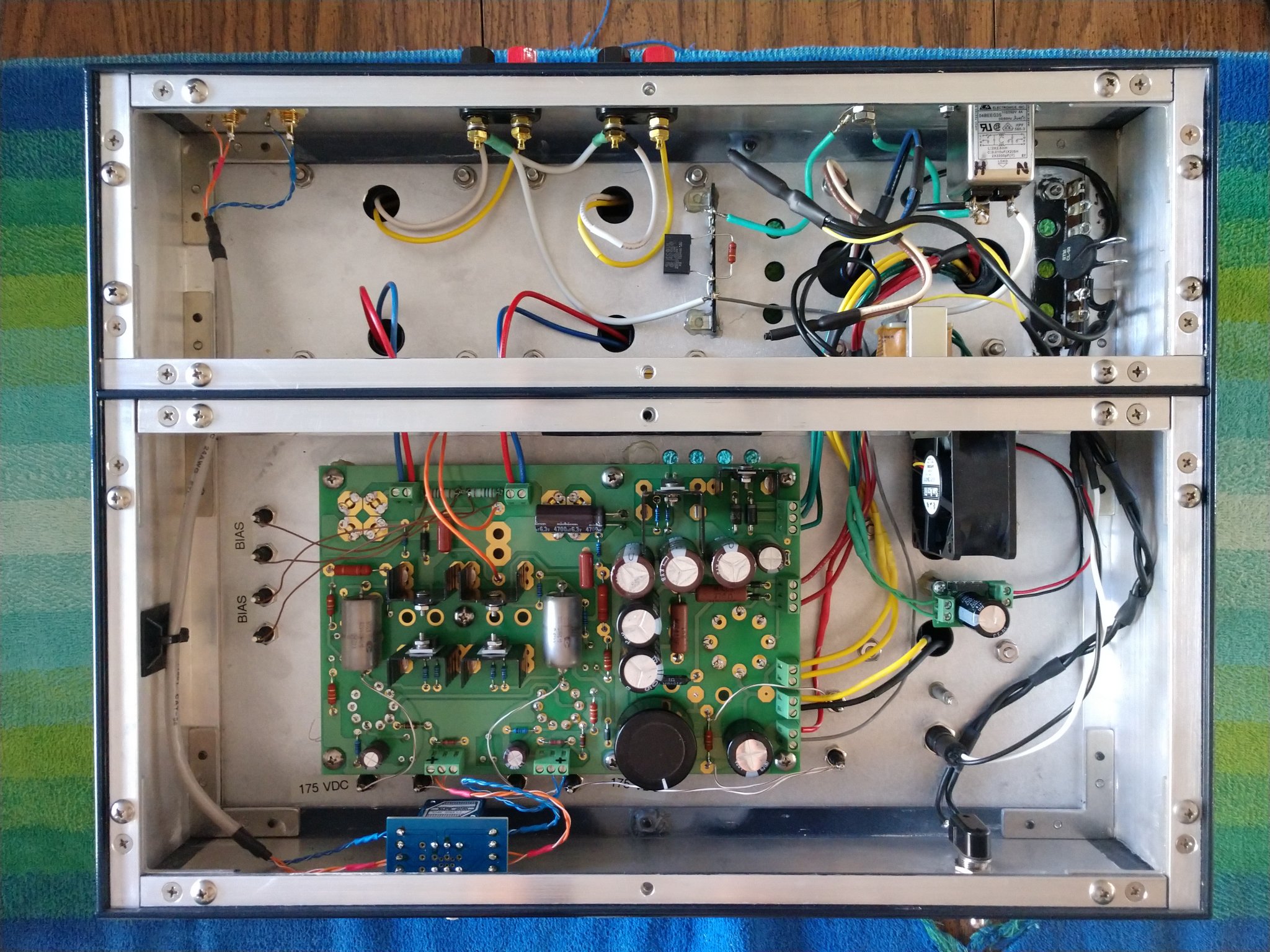

Just finished my TSE-II 300B. Sounds great! I did have to do a few simple things to manage heat from R36 and IC3. Moved R36 off-board to side of the chassis. I mounted C3 horizontal to give the IC3 heat sink some breathing room, and installed a small 12V fan inside the chassis. Chassis has a perforated bottom and top vents. Used a Landfall Systems 17x13 chassis. Edcor 5K:8 OPT and Hammond PT. B+ is 360, 5842s at 175V, 300Bs bias at 70ma. Everything is working great. If could offer any constructive criticism, it would be to widen the pcb slightly, giving a little more room between the IC3 / D1 heat sinks and the adjacent row of capacitors. Widening that side of the pcb would also give more breathing room to R36. Things get hot along that side - manageable, but hot. Anyway, I'm really enjoying it, and appreciate Georges smart design and his support on this forum. BTW, the SSE I built ten years is still running strong.
