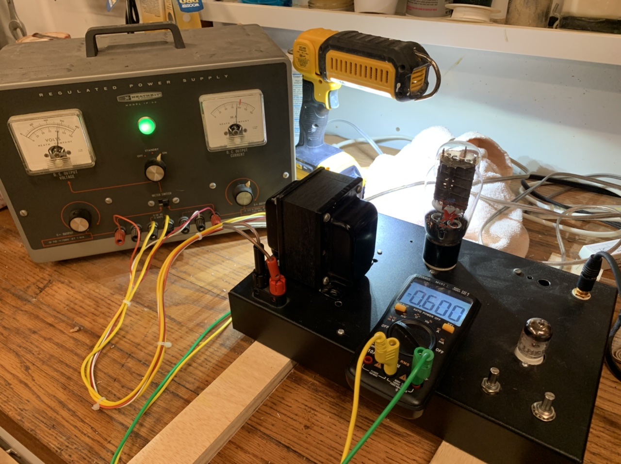

In previous post about 2A3 mono amp powered by Heathkit regulated P/S:
The 2A3 is biased at 60mA (the meter is reading 0.6 volts across the 10 ohm bias resistor), and the 10M45 CCS is set at a nominal 9 mA (330 ohm "setting" resistor, as spec'd).
The Heathkit current meter, however, is reading ~90mA for one channel.
Where is the rest of the current (about 20mA) being dissipated? Seems like a fairly large overhead. I assume it's going to:
(a) MOSFET
(b) OPT
(c) CCS parasitic losses
Remember, there's no rectification or filtering losses in this number.

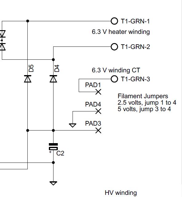

a couple of questions on the TSE II 300B. Do I hook up all the PS center taps, except the 5V? I thought I read somewhere not to hook up the 6.3V center tap. Pulled the bottom off my TSE I, 45 amp and 6.3 center tap is hooked up.
Have look at the schematic; the 6.3 CT is connected to the inboard terminal [labeled T1-GRN-3] next to the two 6.3V leads.
For 2.5V filaments, the 6.3V CT is jumpered to the tail-end of the filament rectifier "bridge".
For 5V filaments, the 6.3V CT is left FLOATING (in which case the terminal block is just a handy place to park it)
I'm currently looking at PT options for a TSE-II 45 build... in the case where a PT didn't have a 6.3V center tap, could you create an artificial one, e.g. by running a 100R resistor from both T1-GRN-1 and T1-GRN-2, to T1-GRN-3?
No, the CT on the 6.3 volt winding must be real in a 2.5 volt situation since the power supply is a FWCT design drawing full current through the CT.
The virtual CT thing made with resistors only works for hum balancing.
