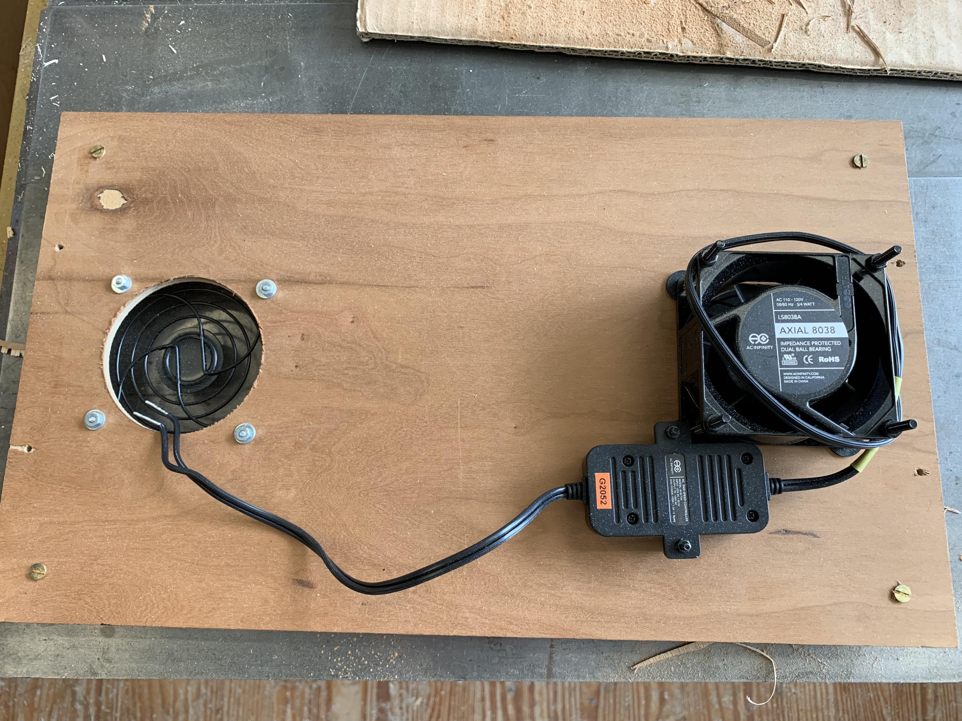

Re: Muffin Fans
I did a similar thing, except using a 120V fan with speed controller mounted in a ply bottom plate (see attached). With speed turned-down real low it's only audible within about a meter...I don't use it on the 300B monoblocks since I relocated the big 10K resistor (R29?) off the board (and increased to 25W heat-sink type). Would work good on a stereo 300B, I think.

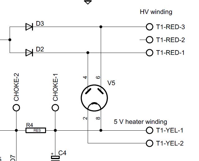

5V CT & Star-Grounding
A 5V center tap is not only UNNECESSARY, but there's no place for it on the board.
If you have a CT lead, suggest coiling & zip-tying it, cutting the end flush AND putting a piece of heat-shrink on there (squeeze the hot end with pliers). Don't use electrical tape, as it's hot under there.
I suppose you COULD ground it, but personally I am religious about avoiding possible ground loops, so I keep the board insulated from the chassis and bring only ONE ground wire (from the red-yellow HT CT) to the star-ground point.
At star-ground I have:
(1) PST ground wire
(2) A/C ground
(3) board ground
Input jacks are isolated from the chassis, and grounded back through the board ground-plane to the star-ground.
At star-ground, don't forget to scrape-off any finish on the chassis.

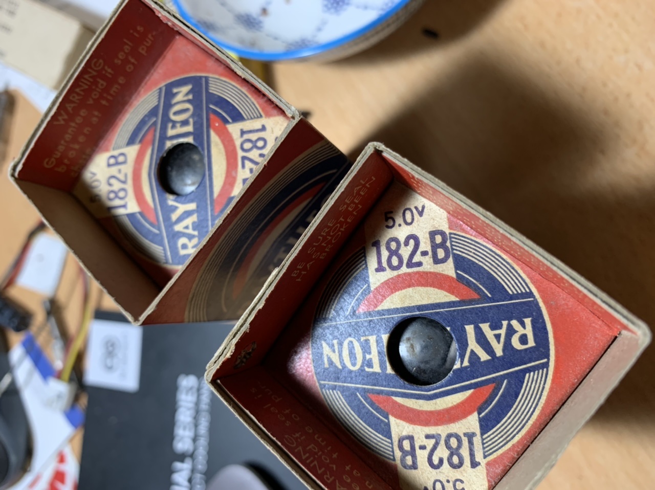

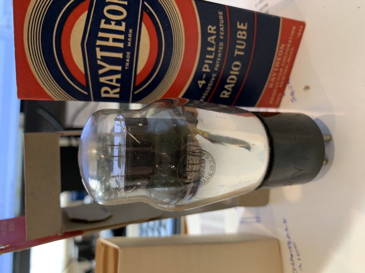

Still finding stuff.. PAIR of UNOPENED 182-B DHTs
Still cleaning-up the recesses of the shop, one year after LAY-OFF, I mean Retirement. Came across these (!)
5v 1.25A filaments
250V “tension plaque”
-60V “tension grille”
30mA “courant plaque”
5K ohm “impedance de charge”
1.8 W “puissance module”
CLOSE to a 5v 45, but lower Vp max, and at 250Vp, SLIGHTLY higher Rp and Mu…
https://frank.pocnet.net/sheets/121/1/182B.pdf
I assume that they are ST bottles, not globes…haven’t opened ‘em yet.
Anybody have a fluoroscope they can lend me?
EDIT: couldn’t stand the suspense. They are indeed STs, with sumptuous getter.
See photo.
FleaBay prices seem slightly higher than 45s, but not egregious.
Seem to be equivalent to 483s (I think George has UX-483s IIRC)
5v 1.25A filaments
See photo.
Unless I SELL’em, I guess I know what I’ll do with that last TSE-II board…
Unless of course y’all talk me OUT OF IT.
On paper you do need a 8 to 10 amp 6.3 volt winding for 2A3's. In practice you aren't going to fine one on a single power transformer that runs the whole amp. If you are using a separate 6.3 volt transformer, then 10 amps is a good choice. My 2A3 amp uses a Hammond 372HX. This force feeds the tubes over 350 volts of B+ so it shouldn't be used, but my amp works fine and the transformer does not get hot. I have tried cheap dual plate Chinese 2A3's and Sovtek single plate 2A3's. Neither seem to mind the over voltage, but then I feed my 45's 320 volts.
Do NOT ground the CT on the 5 volt winding. This will short B+ to ground making for a short unhappy life for the rectifier tube and possibly frying some other parts. The CT on the 6.3 volt winding should be connected to it's terminal on the board. The jumper will decide if it gets grounded or not.
If you have a CT lead.......I suppose you COULD ground it, but......
5v 1.25A filaments
See photo.
The 182 is the little brother to the 183. The 183 IS a 5 volt 45. I have a pair of 92 year old NX-483's (same as a 183) in my original TSE. I run them at 320 volts and 30 mA and they are still kicking. They drove my 87 dB Yamaha NS-10M's to a decent listening level in my 10 X 10 foot room in Florida. They are nearly useless here in a 2000 square foot basement, so that amp sits on the shelf, lonely and unplugged.
