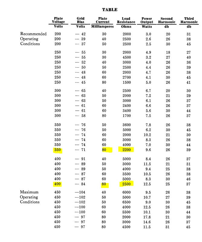

Sanity check here, please? I've been monitoring driver voltage (175VDC) and 300B bias (62Ma) and although the bias jumps around a bit, it's starting to settle down. My B+ across R30 is 380VDC and across R6 it's -190 VDC. Actually it's +190 VDC, but I assume it's because I have the wire's reversed? This is with a 5AR4 rectifier. With a 5U4 rectifier I get 345 VDC across R30 and the same -190 VDC across R6. Should I change some values on the board, or is that 380 V fine? IIRC a 300B is good for up to 400V, but it shortens tube life.
I've noticed when I biased up the 300Bs (after installing the 5U4) and brought the drivers up to 175, the B+ now is 272V and B- is 200V.
272 is a bit low. I think you want it in the range of 350V-400V. With your 3K OPT, something like 350V, 60-70mA.
Thanks. I've settled on the 5AR4, which gives me 380V. Bias at 70mA. From searching around the web I found that for 380V the bias should be 90% or 94.7 mA for class A....and best sound. Supposed to shorten the life of the 300B, tho. Also suggested to back it down from that point, but not to the point you can hear the quality of sound go down. Maybe 5 to 10%. I installed a pair of Hashimoto H-20-3.5U...these also have a 2.5 tap on them, which I much prefer.

Attaching the WE300B list of operating points, you seem to be fairly close. Maybe experiment with 80mA too.

The EH300b I'm using would keep drifting when set around 80mA. I changed from a 310-0-310 (350 B+) to 330-0-330 (377 B+) and reduced current to 70mA. Mains supply is 230v with a power conditioner.
Its been running a few months without problems and no longer drifts by more than 1mA now.

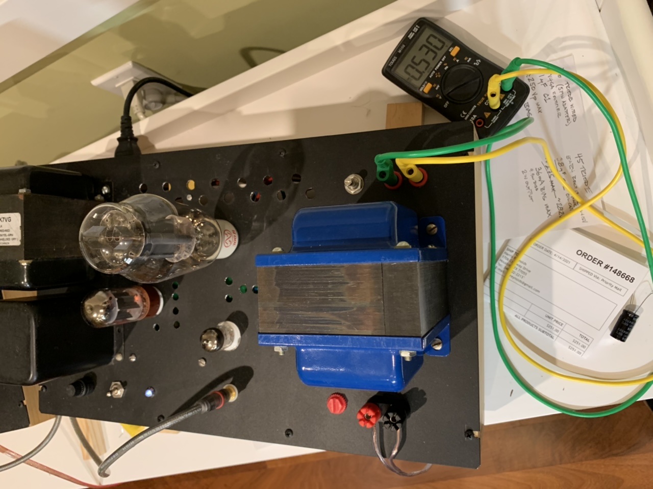

Chassis for the TSE-II is almost ready. Need help with a question.
I would like to add test points on the rear of the chassis for simple testing without opening it up. At a minimum, would the 300b bias be sufficient to keep track of tube life ?
Any other points a better indicator of tube drift /life (B+ | -ve V | 5842 V etc...)
Thanks.
Thanks.
Bias test points
I’ve built three TSE-IIs; two 300B monoblocks and a 45 stereo.
I agree that it’s a good idea to use test ports, at least on the power tube bias, particularly if you roll tubes regularly, as I do with the 45 version.
I put two test receptacles (for banana plugs) at the rear of the chassis for each channel, each testport wired to one side of the 10-ohm bias resistor. Note that I bought a handful of 1% 10 ohm resistors and picked the best, usually about 9.99 ohms on the fancy LCR meter.
I put a Bourns 10-turn pot next to the test jacks and wired it in place of the bias trimmer pot. I did not install a knob so as to discourage random bias twiddling.
Voltage across the test ports x 100 represents bias amps, for those tuning-in late.
Also used an upside-down machine screw at the Star ground (one of the PST feet) so that I could easily double check Vp (as TSE-II is grounded cathode, I remind myself…) by measuring voltage between plate and ground.
Note that I’m running the 300Bs quite cold here. Can’t really notice any difference, which might be related to the big 5K EDCOR OPT…
