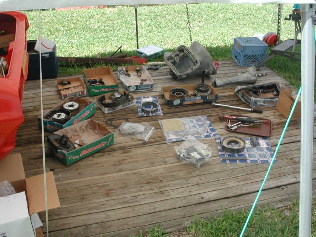

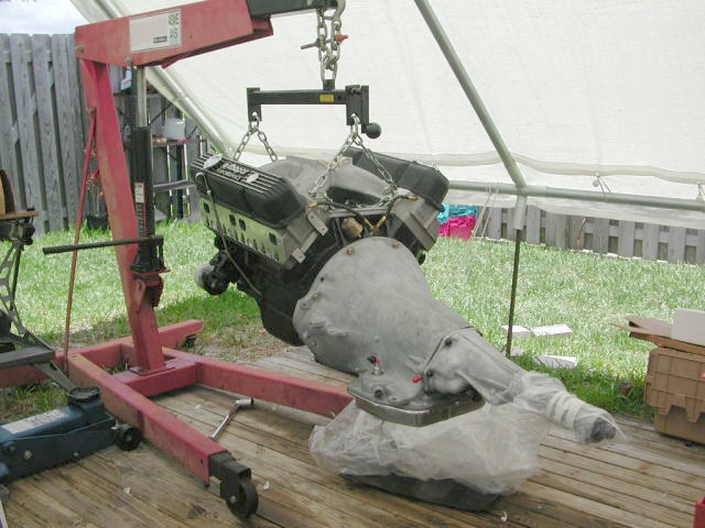

Not sure who you are referring to here, but in my nearly 70 years on the planet the term "tranny" has been associated with three very different meanings, and a transformer is by far the least common. Another has to do with "personal pronouns" and such, and the most common in my past was the association with the mechanical contraption that changes the gear ratio between the engine and the differential in an automobile, AKA the transmission. I blew up several of those in my hot rodding days. Ever wonder what's inside an old school automatic transmission? This one is a mid 70's vintage Chrysler Torqueflite 727 with about 500 HP feeding it. Yes, it went back together and ran just fine.On a very very personal note, I refuse to rely on the advice of anyone who calls transformers "trannys"
