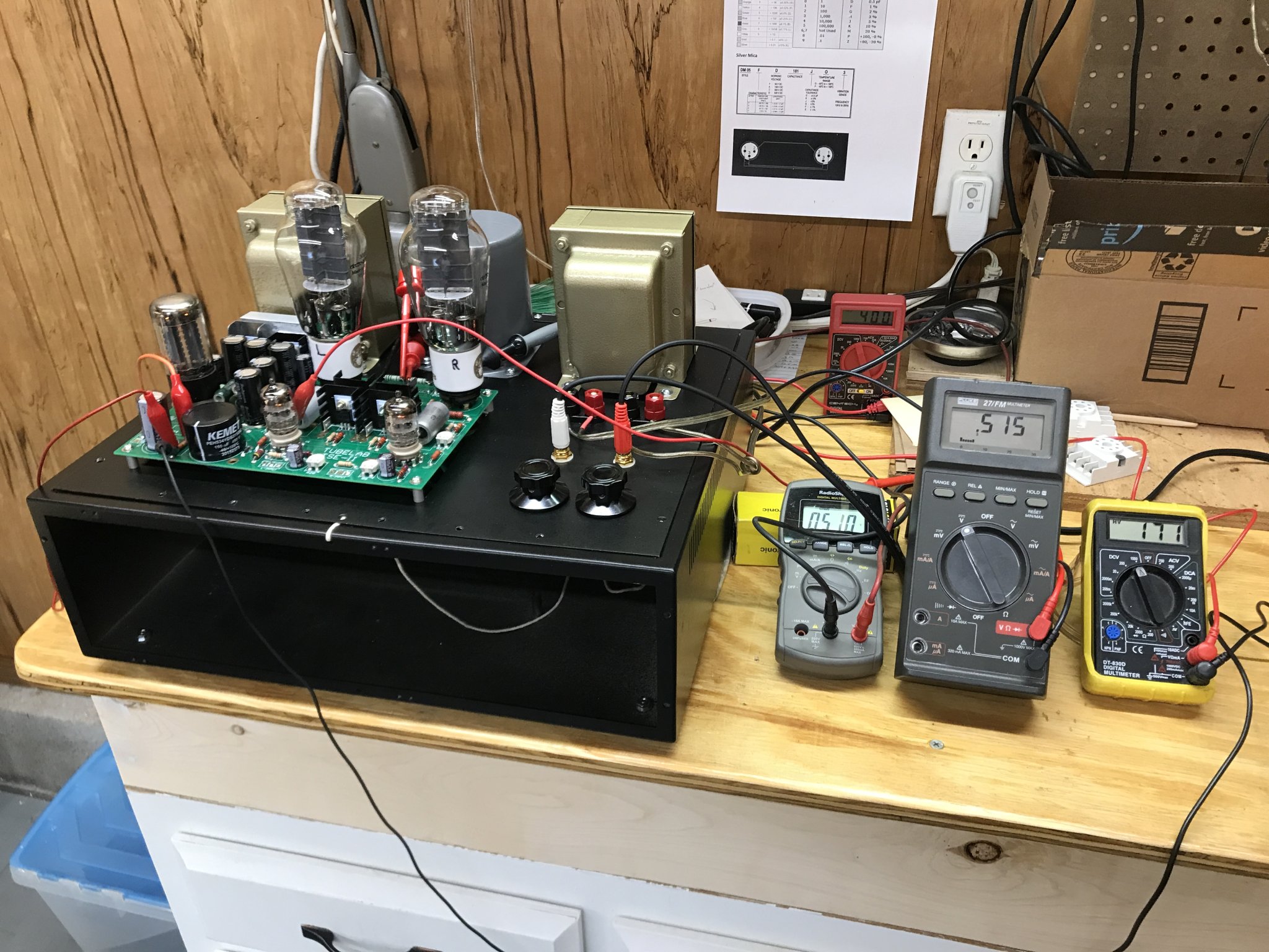

Power transformer questions: I just finished building a TSE and it seems to be working great, in that all my voltages fall in the range they should and the amp sounds good on my small shop speakers. For this build I used a power transformer I had on hand that (per my measurements) could provide appropriate B+ voltage, though I was not sure about its current capabilities. I built the amp using the specified values for all parts except the first cap, which is currently 33uf. I'm using the Edcor 5K OPTs and a nice vintage UTC choke.
After about 1/2 hour burn in time with B+ at 400v and power tube current at about 50ma, I tried cranking the tube current up to 80ma per tube. This caused my B+ to drop to about 368v. While 80ma @368vdc is not a bad operating point, the fact that my B+ dropped so much leads me to believe that my power transformer is a bit undersized in regard to current capacity. I also tried increasing both tube currents up to 90ma (which is probably where I would like to run, though without experimentation I'm not sure yet). This caused B+ to drop to 360vdc. I then reduced the tube currents back to 80ma. After about 1 hour of total run time the PT was quite warm to touch, but not so hot as to be painful to my hand.
Question 1) Is the B+ drop I'm seeing (40vdc between approximately 120ma and 200ma total current draw, which is all 4 tubes with power tubes at 50ma vs 90ma) a big concern, or just typical? And from a sonic perspective, does running the power transformer near or above its current limit cause distortion? This is single ended architecture after all, but I typically over-spec things and try to stay further away from equipment limits.
Question 2) I have the option of upping the first cap to 47uf which will increase my B+ some, but will that help anything? Will that just stress my PT more, but not really address my current limitations? Or does the larger cap actually make the power supply more efficient?
BTW, I'll build a cage to cover the circuit board...
Thanks, G.

What is your choke resistance? If it is roughly 500 ohms, then the drop makes sense. (40/0.08 = 500)
If the PT is just warm then it doesn't seem like it is being too stressed.
Increasing the first cap can reduce the PSU ripple but the difference is likely not significant.
You can play around with PSUD-II to see what impact it may have.
You can use a 100K audio taper volume pot, but since you're using a CD player, better to use something in the 10K-50K.

Thanks for your thoughts itsikhefez. Can't remember for sure what the resistance of the choke is but I think its closer to 100 ohms than to 500. Testing again last night, the transformer gets rather hot, but not too hot to touch. The job of providing the 6.3vac for all the tube filaments has already been offloaded to a seperate transformer, so the heat is all coming from the B+ and 5v windings.
I would use a 50K or smaller audio taper pot on the TSE and TSE-II amps. I have noticed a measurable high frequency roll off at mid volume settings with a 100K pot due to the miller capacitance of the 5842 tube. Audio taper is designed to make the volume increase as the knob is turned up match the sensitivity curves of an average listener's ears.
