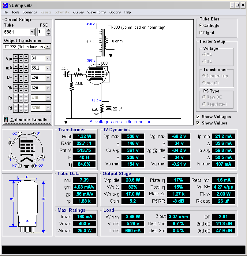

I tend not to be nearly as concerned about power as the average user, but I appreciate your point. Currently, my SSE amp can push about 3.5 W (RMS):The amount of power needed should tell you which tube to use. The 45 will do 0.5W to 1W. 2A3 will do 3-4W. And 300B can do more like 8W. All approximate numbers. You need 100 db/W speakers to really take advantage of a 45.
My speakers are about 91dB 1W/1m, and the 3.5 W is plenty. I can play the system loud enough (clean) that people cannot have a conversation in the room. That is typically much too loud for my needs. I am guessing that I am typically running a couple hundred mW (for BGM), and maybe 1-2 watts for active listening.

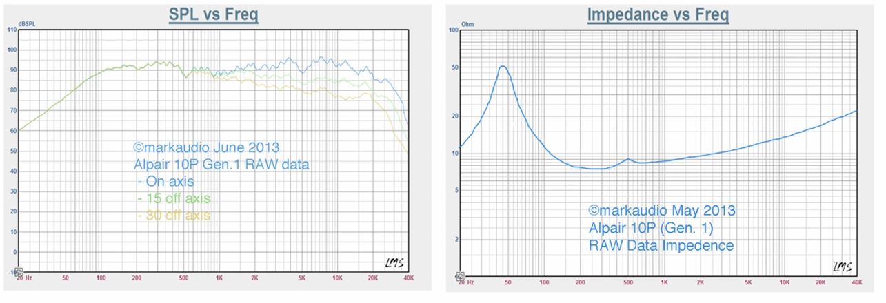

My speakers use Alpair 10p drivers with an 89.6db sensitivity. Knowing that, would this steer you towards any particular opt?

I’m not an expert in the TSE-II since I have not built mine yet. I see your loudspeakers feature relatively high impedance (on the 8 ohm tap) and somewhat low sensitivity. The latter to me indicates the desirability of (slightly) more power and therefore I would choose a transformer with primary impedance around 3k. (5k will give slightly lower power and lower distortion, depending on the operating conditions you end up with.)
I agree with @cogitech that you will be better of with a substantial output transformer, rather than a 2-3 lbs Edcor, such as the 15 watt GXSE15-6-2.5K that weighs 2.75 lbs. Looking at the offering from Primary Windings it weighs 4.3 kg! Really in a different class. If the budget will allow those are the transformers I’ll investigate further.
