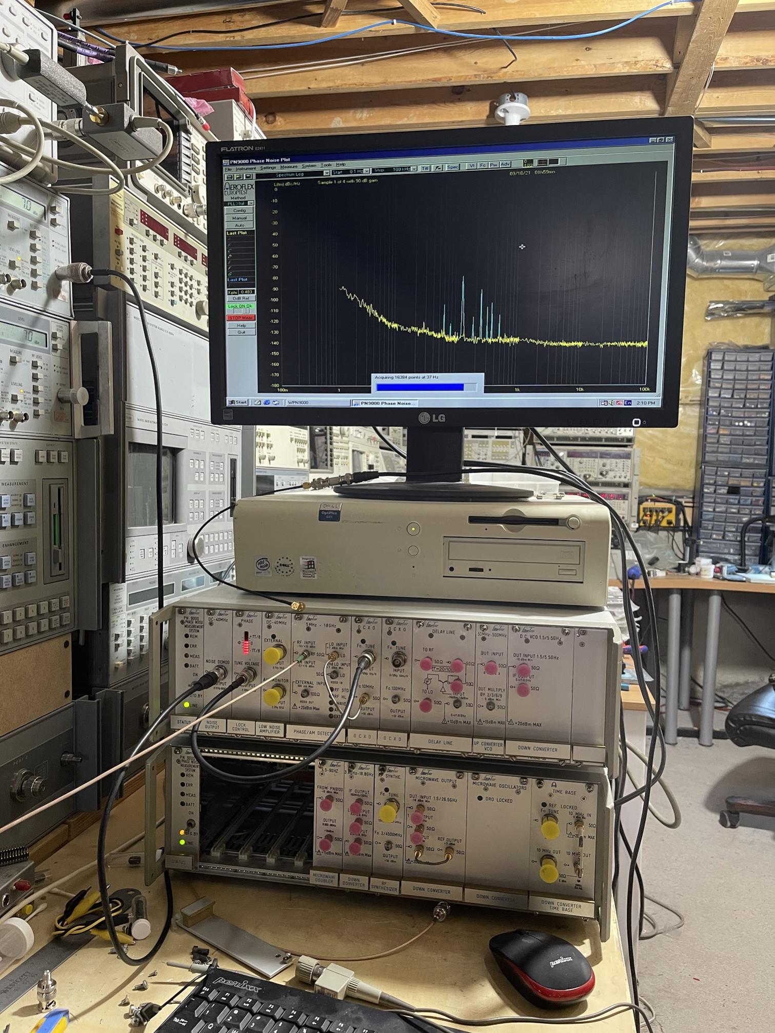

What do you mean by that? The jitter impact on the analog performance? Won't happen, it is likely way under any usual analog instrumentation sensitivity. Otherwise, I just got (almost for free) a PN9000 Phase Noise (and Jitter) analyzer and I am looking forward for some real world use case. I'm bored of calibrating and measuring Wenzel, MTI, Morion, Bliley and PNI oscillators phase noise and jitter 😀.
Mine does everything, from 2MHz to 26GHz, all known PN measurement methods, PLL OCXOs (10 & 100MHz), Synthesizer (2MHz-1.8GHz base band, up to 26GHz with up/down converters), Delay Line, Addded Noise (with autocorrelation), VCO, etc... Two racks and one computer, 160lbs. of equipment.

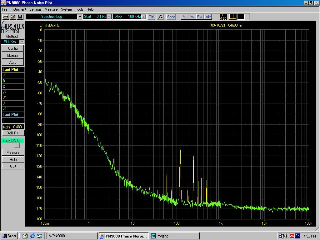

This is my first clock generator measurement. Schematic (there are a few changes)was posted in this thread. Essentially, it's a fractional PLL that generates the audio master clocks for the ADC and DAC starting from a fixed reference of 24 MHz (a 50 cents quartz) which is also used to clock the XMOS CPU. For audio purposes, this is followed by a series of jitter cleaners (also PLLs), based on the Cirrus CS2100 chip.
Attached is the phase noise plot for the worst case of 100MHz output (close enough to the 98.304MHz required for 768K conversion). Reference for the measurement is a Morion MV317 100MHz OCXO. I am sure Andreas will be deeply disappointed on the results 😀.
There are some spurious I cannot identify the source from (they appear always in the same frequency range), also I cannot explain why the noise slope seems to decrease at very low frequencies, but then I am not going to sweat too much over those details.
Also attached is a photo of my new toy in action, while measuring some 10MHz oscillator (nothing to call home about) 😀. Now I have to find a good location for it, in an already overcrowded lab...

Really? and why?
The poor Timepod measures exactly like your PN9000.
Already compared, maybe you have not read carefully

You are right, we are not particularly interested on listening to your devices.
And I well know there is nothing for us here since you still keep measuring THD.
However, now you have a good phase noise analyzer tool so you could build yourself an upconverter in order to measure in audio band (at DAC output).
And maybe if you share the upconverter design you saved us a lot of time.
