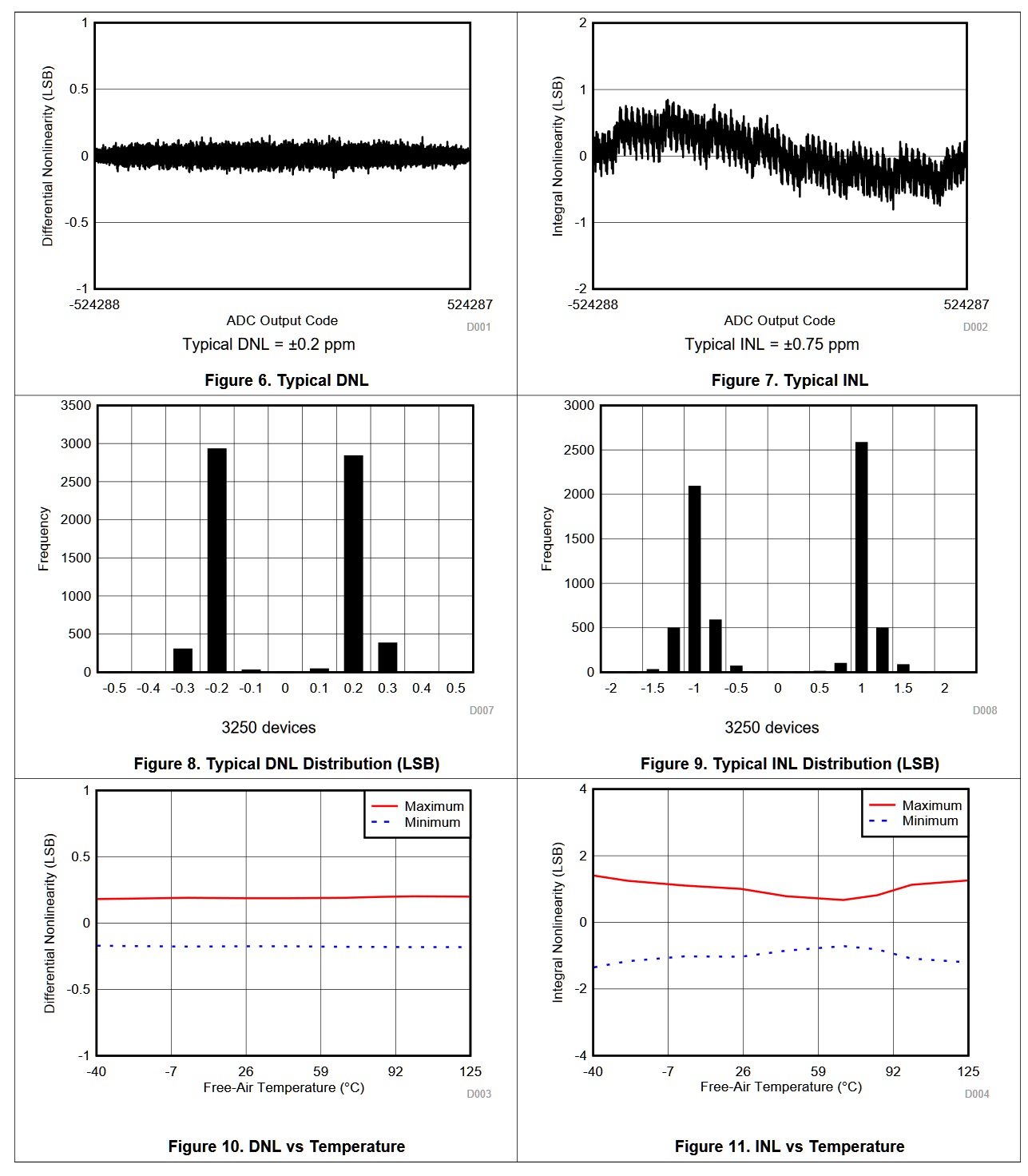

Otherwise, I don't see in audio grade ADCs the DNL and INL (and in general any linearity metric) seriously characterized (other than a chart with a straight line), compare with the datasheet for a 20bit SAR (see attached). SNR and dynamic range in the audio band are related to the number of bits (and there are SARs up to 32bit, sacrificing the distortion performance for SNR and DR, but 20bit seems to be kind of sweet spot today).

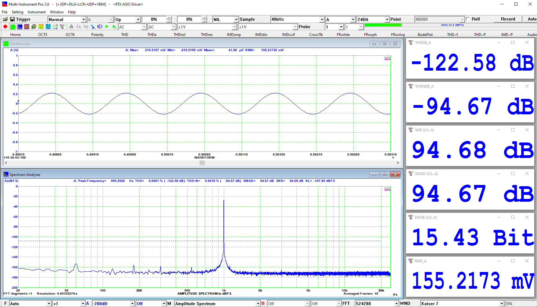

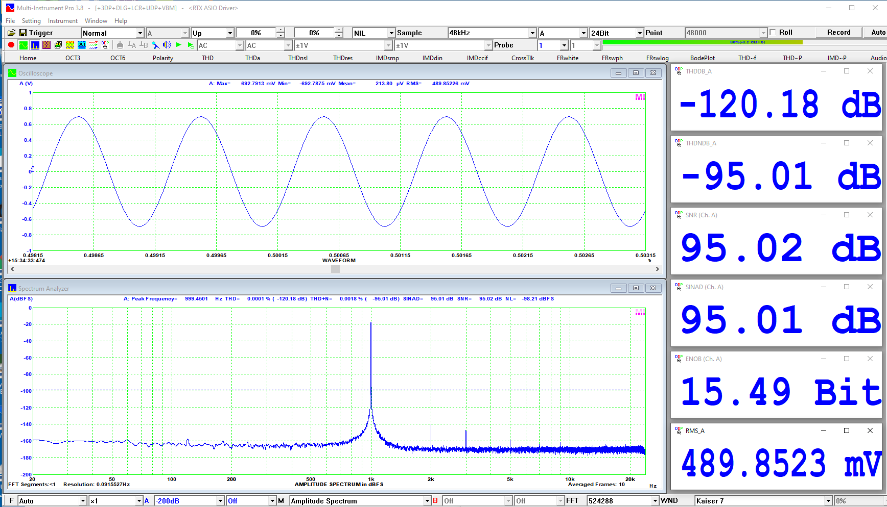

Here are a couple of plots using an external generator (AM70A) @ 1KHz. I'm not sure how to proplery interprest them or if the ENOB is valid. The generator is analog so it will have considerable phase noise compared to a digital source but much lower distortion. The distortion is all AK5394A + analog stuff. And, to be sure, this is not a truly optimum connection.

15.4bit ENOB for a 24 bit ADC is rather low; I've posted earlier the ENOB for a 20 bit SAR (16.45 bit). I would think yours include a good chunk from the generator phase noise.
