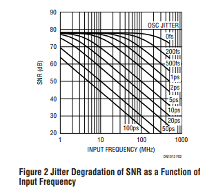

RE =170 dBC When I was discussing getting a crystal oscillator from Wenzel they told me that to get an oscillator with that performance I would need to sign ITAR papers since that performance level was considered munitions grade and controlled. Further I would not be able to sell it outside the US without DOD approval.
However it seems those limits no longer apply.

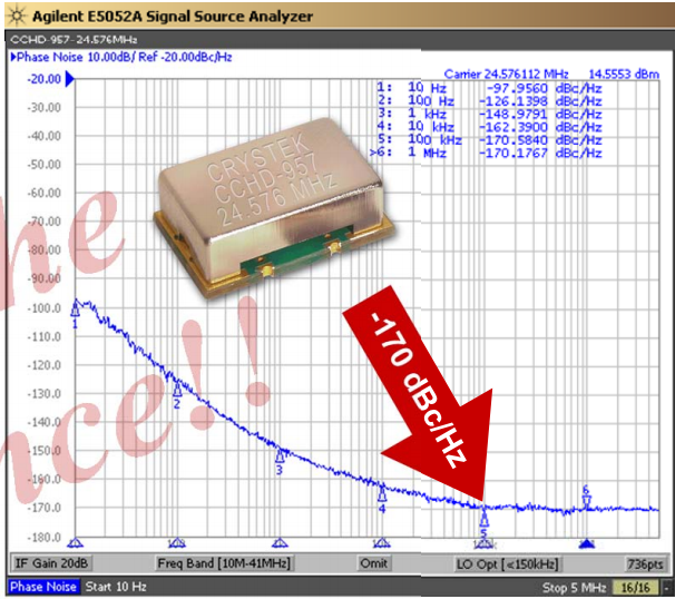

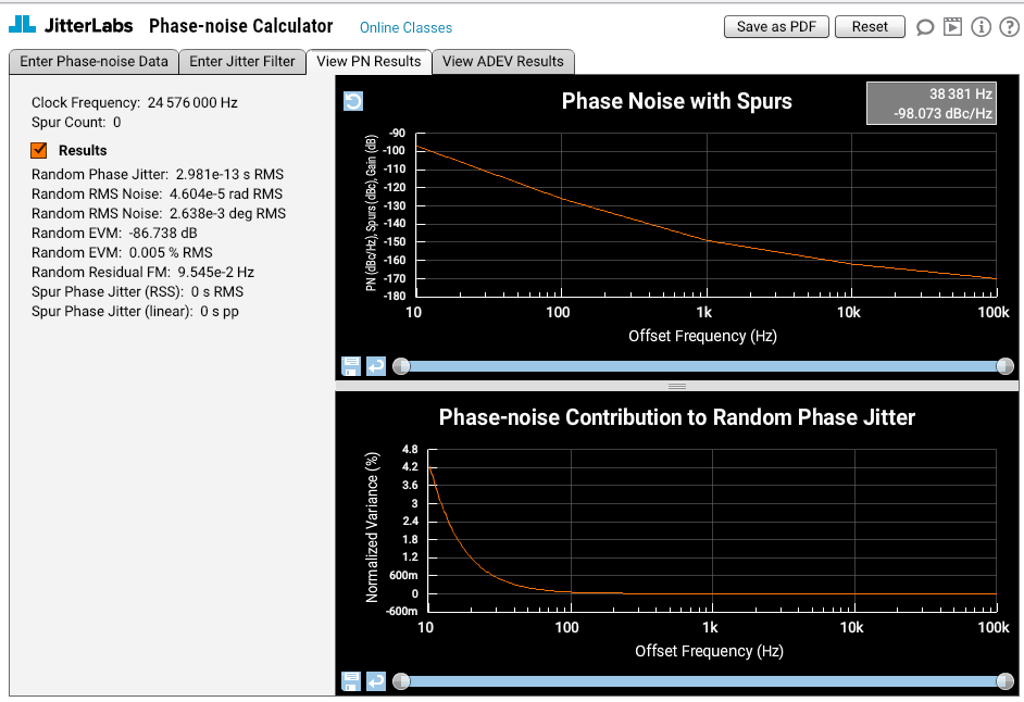

In any case its not quite that simple. first measuring less that 100 fS jitter directly is not really possible with available technology. You can measure the phase noise although measuring at -170 dBC its really difficult. Then you need to be sure what you are measuring it what matters. The chart below is for SAR type converters and shows the relationship between jitter and SNR vs. frequency. Maybe it would be useful to extrapolate the chart to audio frequencies and SNR's.
The other charts show the jitter analysis of the crystek CCHD-957 at 24 MHz. its an RMS jitter of around 300 fS and dominated buy the 10 Hz to 100 Hz block. What I have come to understand is that those lower frequencies have the least influence on SNR and audibility. I may well be simplifying it since the audio stuff is full of controversy and contention but the industrial stuff tends to be pretty clear.
Not sure about audibility, but certainly the LF phase noise doesn’t contribute much to the jitter. That’s because the jitter is proportional to the square root of twice the phase noise integral, from zero to 2*fo. As such, usually the LF part of the phase noise area has a rather small contribution, in particular for frequencies fo in the tens of MHz, since the phase noise gets flat usually in the tens of KHz.

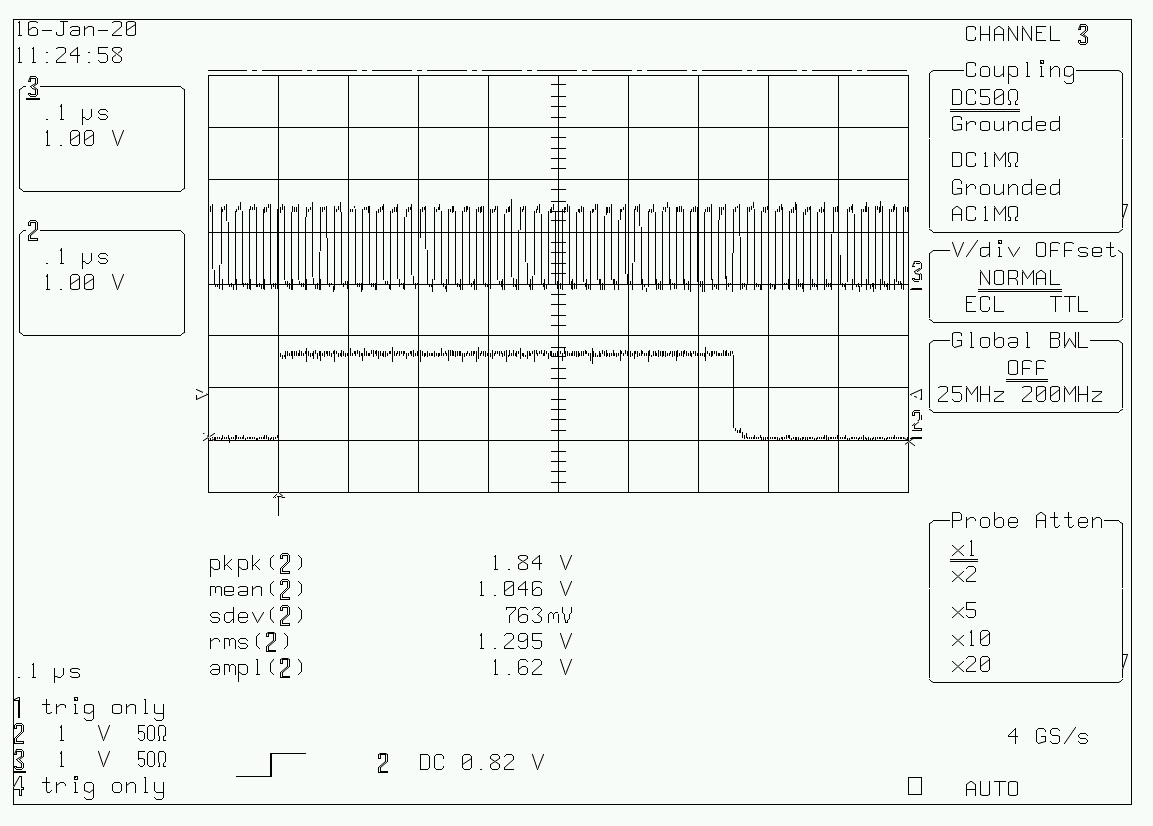

Ok, so the ADC clocking works to my satisfaction, using the CDCE913 clock generator. Feeding from a 24.576MHz ultra low jitter oscillator (Crystek CCHD-957-25-24.576) straight dividing by 32...512 for the LRCK (also the sampling clock), using the internal frac PLL to up the frequency by x8, x6, x5, x4, x2 then divide by 4, 8, 16, 32, 64 for the BCLK. All possible combination of 8, 16, 20, 24, 32 bit and 48, 96, 192, 384, 768 KHz sampling are available. A simple logic with a 74LVC04 hex inverter and a 74LVC02 quad NOR creates the CNV pulses (>20nS) on both LRCK edges (for two channels), so that the LTC2378-20 acquires the input and starts the conversion (completes in less than 675nS).
Clocks are clean and nicely synced, see below (32bit@768KHz sampling, 49.152MHz BCLK, I may eventually try a 32bit SAR, not a priority since I'm not expecting anything better compared to the 20bit LTC2378). The LRCK has a phase noise/jitter below what I can quickly and reliable measure and is certainly under 1pS.
Feeding the LTC2378-20 with these signals (CNV, BCLK) renders the target performance (THD<-125dB, SNR>103dB) expected from this SAR ADC.
