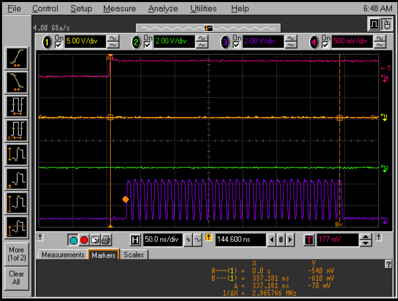

That describes perfectly how my LTC2500-32 ADC works. Sample clock at 1 MHz,
2/3 of the period for the conversion. The last 1/3 of the period is exactly long enough
to get the 32 Bit result at the 100 MHz fastest allowed SPI rate. The SPI clock is off
during conversion.
I don't know if they have a real clock for the conversion. It might be just a tapped
delay line fed from the conversion rate.
< https://www.analog.com/media/en/technical-documentation/data-sheets/250032fb.pdf >
Gerhard

In the LT2500, encode and SPI clock are completely independent.
That can't be proved better than by the fact that during conversion there is no SPI clock at all. And all digital I/O during conversion is avoided. Produces only unwanted noise.
SPI clock is started only when /conversion_busy goes away, for exactly the 32 clocks needed.

The picture of the board is ~3 pages back. I have a 100 MHz crystal osc that goes into the Coolrunner2-CPLD. That divides down to 1 MHz for the sample clock and it also gates
the 100 MHz with a state machine in VHDL for use as a SPI clock.
This is not a LTC2378. The LTC2500-32 can filter and decimate itself for lower effective
sample rates and provides the original 1MSPS data on a different data pin if one thinks one
could do that better. With lower effective sample rates comes higher resolution.
The Coolrunner also reads the SPI data and hands it over to the Beaglebone as 4 Bytes,
which is easier to handle for its PRU coprocessor. I could not make the Beaglebones
SPI interface make work under Linux, it is limited to 48 MBit/sec anyway.
