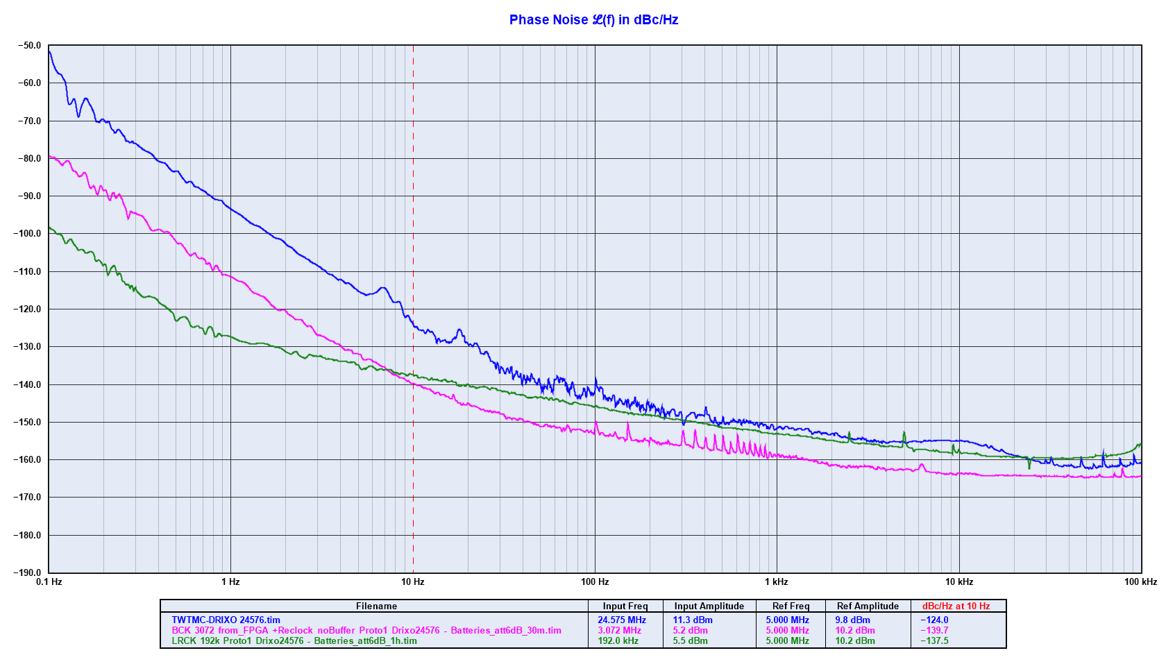

In cases where I2S signal jitter may be a concern, if the master clock is on the dac side of the isolators then the master clock can be used to 'reclock' or 're-synchronize' the I2S signals through a D-Flip Flop buffer. For that to work correctly the master clock frequency needs to be at least twice that of the highest I2S clock frequency (otherwise the flip-flops can act as frequency dividers).

I2S reclocked with master clock after optocouplers and phase noise plot:
- blue line, masterclock
- pink line, reclocked BCK
- green line, reclocked LRCK
