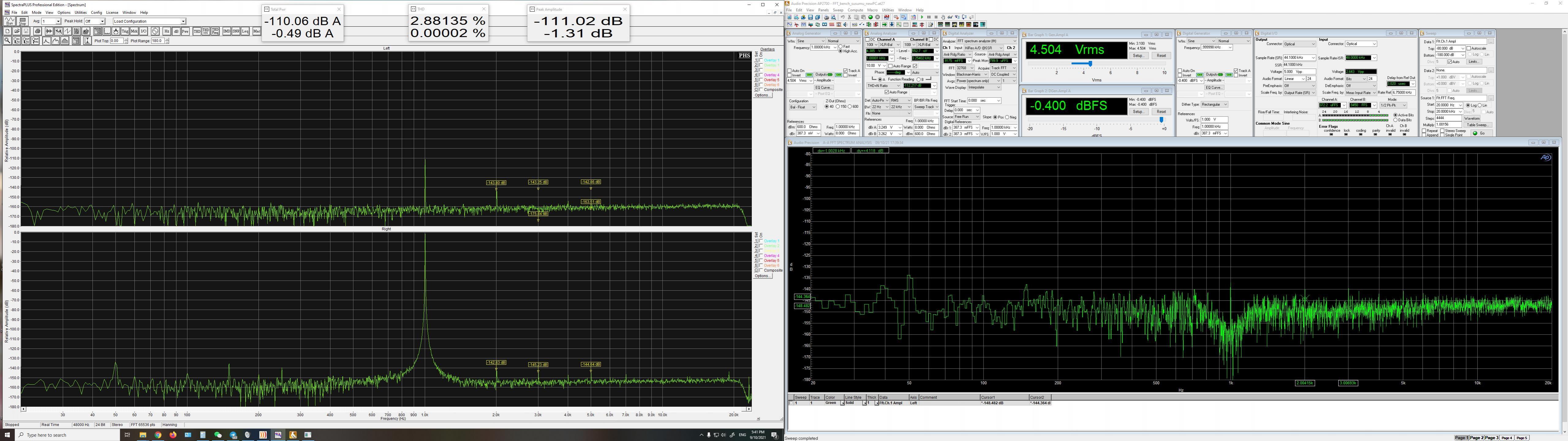

IVX can I ask you what level of performance you get with the ES9822 without any THD compensation? In terms of THD?
@-.5dbfs 3rd at -120-125db, 2nd not sure close to -135db I think because the compensation-K2 usually within +/-2, when 3rd compensation-K3 +/-20 to get -132-138db level. Samples with low compensated 3rd, like -136-138db, has that level floats, hence better to calibrate that when sample for sure warmed up and settled.
Thanks IVX that gives me an idea of what to shoot for.

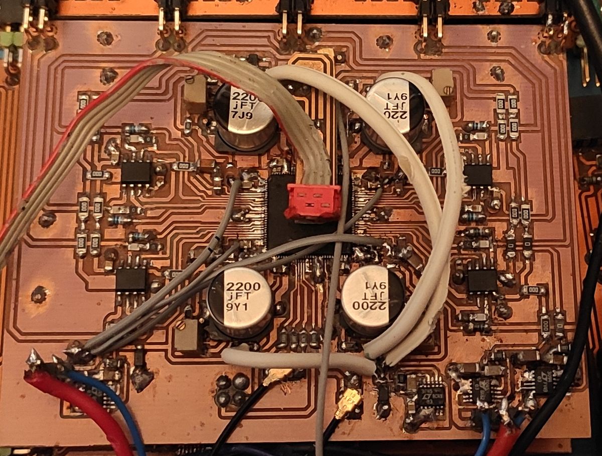

So I figured it would make sense to have a play with my AK4499s to get them performing up to spec. My distortion was slightly higher than other measurements (over on audiosciencereview) had shown the chip to be capable of. Whether or not these were golden samples I don't know but I wanted to try to improve things.
The AK4499 datasheet does indeed show that the distortion rises a little as you approach 0dBfs, and I was seeing such a degradation, but a little more than you'd expect. I was still getting all distortion products below -120dB but I wanted to do better.
I already knew that the power supplies to the chip were important. The obvious thing to do would be to use something like 4x LT3042/45 for the Vref supplies and then 4x some other device for the secondary 5V supplies. But that's expensive and occupies a lot of board space. So I went for 2x LT3045 per chip. One for the left channels and one for the right channels. I figured the recommended RC filters on Vref would keep the power there clean and the other supplies wouldn't care much. So one LT3045 powered 2x Vref and 2x the secondary supplies.
Using a two layer board and having the LT3045s located on one side of the PCB meant a long PCB trace, meandering around the I/V stages, to get to one of the channels, whilst the regulator sat next to the other channel.
Measuring this produced -120dB+ at the channel the regulator was close to but this degraded down to -106dB for the other one. Still not bad but not good either. The solution to this was to bypass the meandering trace and solder a thick piece of wire from the regulator directly to the channel on the far side. Once done all channels performed identically. While a wire isn't pretty it's certainly effective and far cheaper than another LT3045 and saves on board space.
At the time I was happy with this performance as it was only slightly inferior to the eval board for the AK4499. They were using a 4 layer PCB and I only 2 so I figured a small concession was reasonable. Then I saw how other manufacturers had got significantly better performance than the eval board. As I working with the ES9822 and had some free time I figured it would be worthwhile trying to squeeze some additional performance out of my AK4499s. Why? To make it easier to assess the ES9822 and because it's nice.
I started playing around with other regulators, still on the same PCB mind you, but splitting off the supplies from the LT3045s, and isolating them, to see what made any kind of difference. Adding in an ADP7118 to power the secondary supplies, and leaving the LT3045 on the Vrefs, gave me the kind of improvement I wanted. So even though the Vref supplies have a big RC filter, with a very low corner frequency, they still benefit from having the secondary supplies split from them. I wasn't particularly thrilled at the idea of having some 7118s on wires so I thought why not try something else. Use one LT3045 for all the secondary supplies and one LT3045 for all the Vrefs. Lots of wires to hook things up to the right places but only wires and no new silicon and no new PCB. This also worked. So basically keep the two power domains separate and you're home dry. You don't appear to need separate regulators for each pin which my frugal nature definitely appreciates.
This is how it ended up looking.
Not pretty but effective.

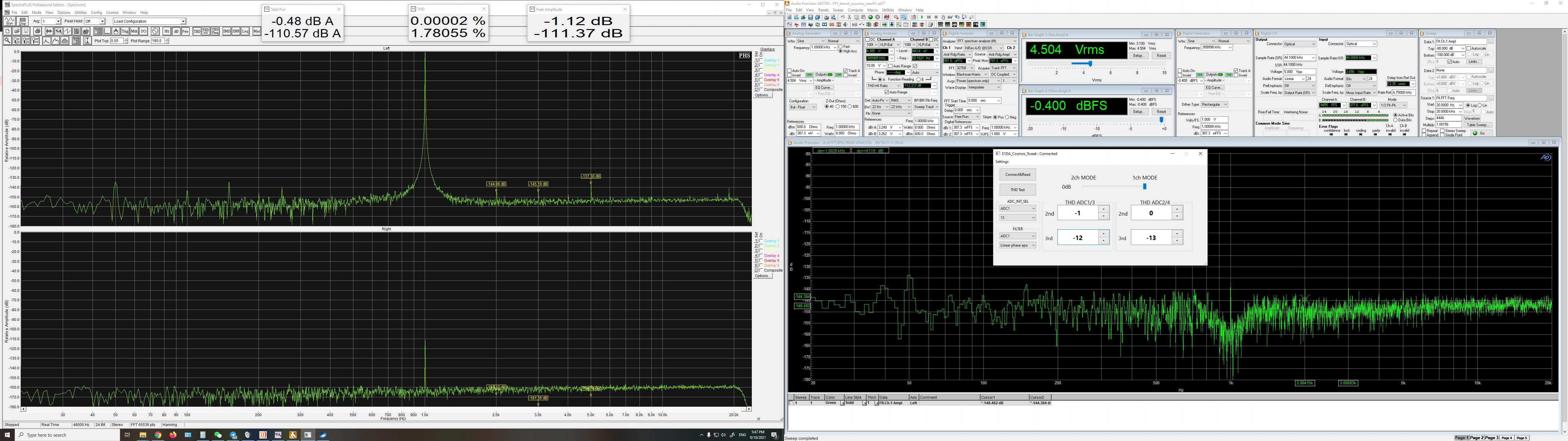

Dropping the output to -2dBfs lowers the distortion even further to around 0.000025%. Which is much better than I had before. Before I had to wind it back to -3dB just to see 0.00006%.
I have two AK4499 boards, one on top of the other, for dual mono. The measurement above is for mono-mode of one chip. After the I/V and RC filtering I have an OPA1622, in inverting configuration, as an output buffer and attenuator cutting the large signal swing of the I/V stage down to 4VRMS balanced. This is per channel of the AK4499 with the mono mode channel summation occurring after the OPA1622s. The measurement was taken after the OPA1622s.
Obviously I'm using an active Twin-T to make any kind of sense of the measurements at distortion levels this low. Using ARTAs frequency response compensation to apply a reverse of the notch to the FFT analysis and calculate the THD/THD+N figures correctly. Obviously I took great care to measure the depth of the notch otherwise the compensated THD/THD+N figures would be wildly inaccurate. No doubt there is some error involved as tuning two notches, for the balanced connection, isn't easy. But as the amount of attenuation the notch applies, to the 2nd and 3rd harmonics, is extremely small I'm fairly confident that the results are within a dB or two of where they should be. The ES9822 was the ADC used.

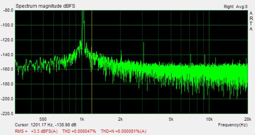

5th element, do not forget to limit BW for the Arta's FFT(I make it with a fake mic freq. response) to make THD+N equal AP reading. A-waiting is not a good idea for THD+N.
BTW, OPA1656 is better as I/U in 10kHz vs AOP1612 + 100mA output, but a bit noisy.
PS: diyaudio.com believes that the .mic file is invalid and doesn't let me upload that. So I put here the txt which you can save as a BW20_20k.mic to use in Arta:

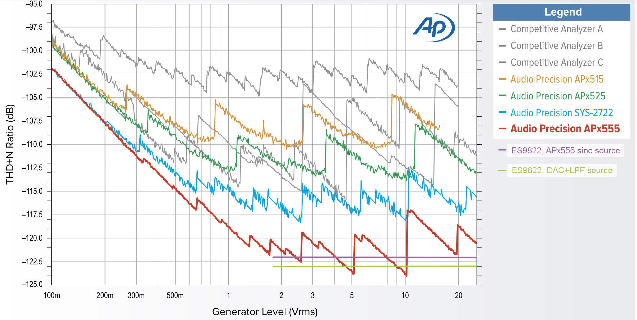

We did measure ES9822 ADC with the APx555 output and got THD+N -122db@1k, that's actually quite close to what APx555 loopback shows. AP's gen always too noisy, for instance, DAC+LPF 1kHz as a sine source makes ADC reading THD+N -123db and less.

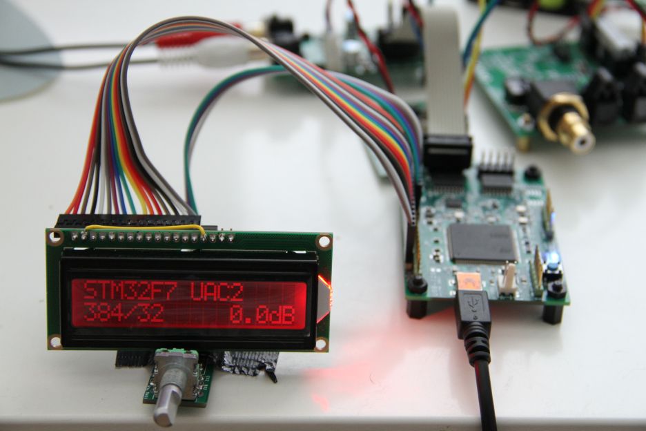

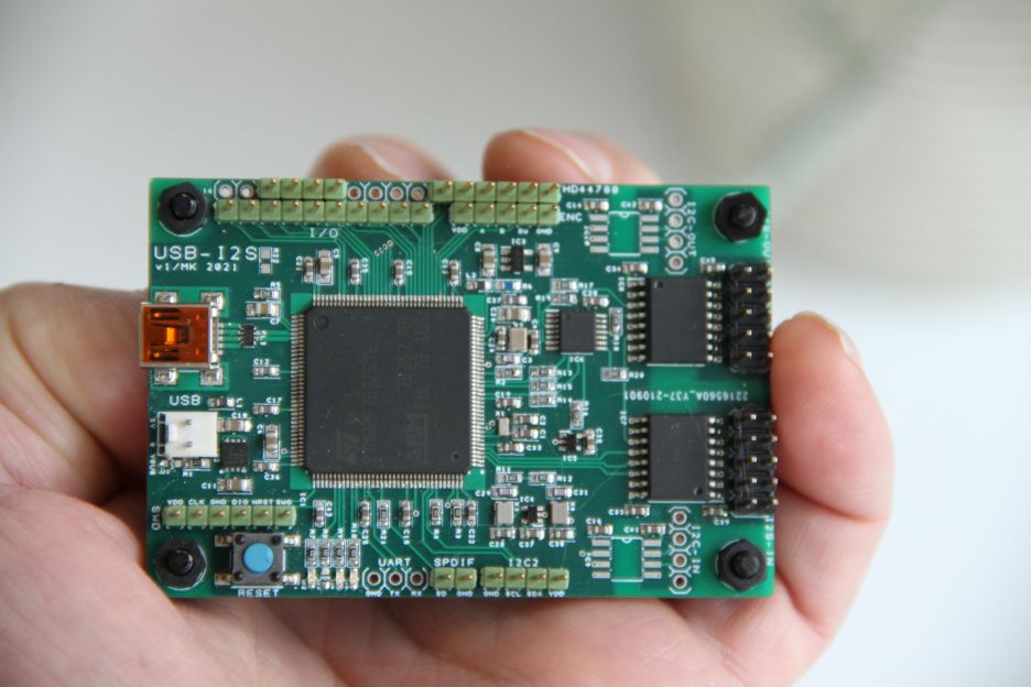

Sneak preview
Does this support I/O I2C ?? And about external clock masters of 44.1/48kHz??
Hp
It has 2 isolated I2S ports (in & out) and 2 isolated I2C ports. 2 crystals (e.g. 49.152MHz & 45.1584MHz). Currently it has 49.152MHz and 98.304MHz crystals. Unfortunately as is very common these days the I2C isolator chips got backordered from Mouser.
