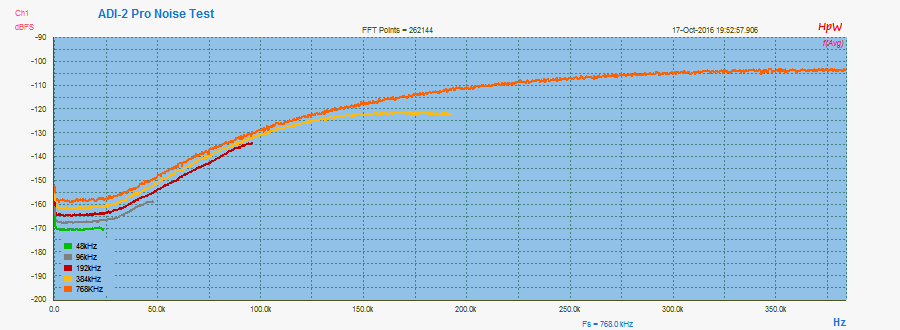

AKM 5574 & AKM 4490 44.1...768kHz (ADI-2 Pro Fs Loopback)
Some asked about UAC2 & WASAPI exclusive mode using 768kHz...
so see attached... 😀 😱
for measurements up to 100kHz OK, while DSP based optimized for 384kHz SR

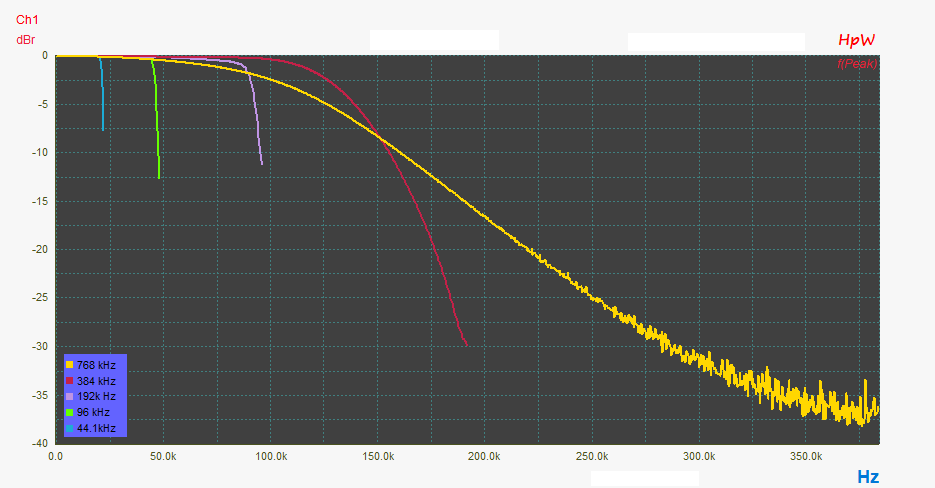

Other than the stinking’ noise shaping in 2 and 3, which makes most of the audio ADCs improper for measurements, what’s special here? I guess 1 shows the frequency responses at SR up to 784k?
Yes, as file names should tell...
in other words above 192khz, AKM has not that yellow on the egg 😱

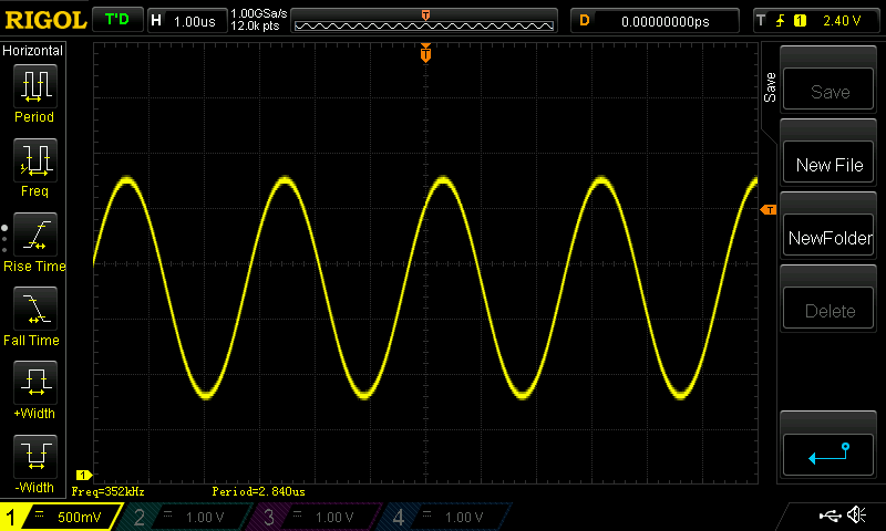

IMO the "newer" AKM chips AK4490/93 with official 768kHz support are just the old 192kHz convertors with newer digital input capable of 768kHz framerate/49MHz bitrate. The results at octo/hexa are... what they are.

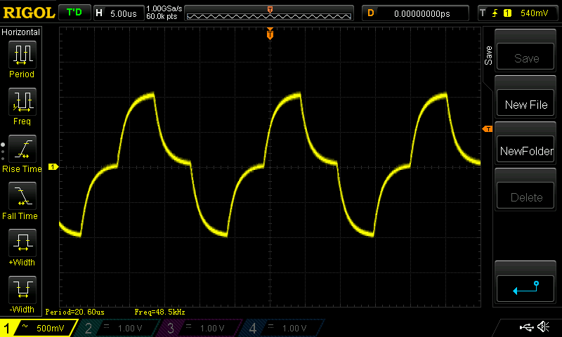

50kHz directly behind AK4493@768kHz
vs. 350kHz directly behind ES9038Q2M@768kHz

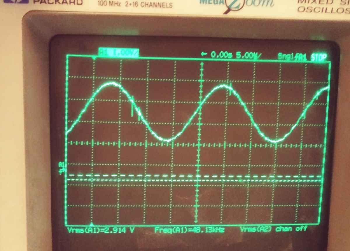

"directly" mean at DAC's pin before LPF?
Sorry for the bad picture from old HP, newer scope is at another room.
This is AK4490@768 at pin 25:
Sorry, I messed up that picture, already forgot what I tested in my post https://www.diyaudio.com/forums/equ...-oversampling-filter-issue-4.html#post6659154 . That was 48kHz@192kHz with oversampling disabled - as one would expect it.
The result of that thread was that AK4490/3 do no oversampling at oct/hex modes.
Please try 96kHz @384 samplerate at oct mode (e.g. MCLK x128 IIRC). Then e.g. 88kHz@ 192kHz and @384kHz - like I did in https://www.diyaudio.com/forums/equ...-oversampling-filter-issue-5.html#post6659176 . The measurements in that thread were by three independent posters.
The 88kHz sample is better viewed with single-run time base.
50kHz is non-integer samples per period and thus moving. Please try integer divider (e.g. 48kHz) or single-shot. IMO you will not see any oversampled points (only the original 16 points per period), unlike 48kHz at samplerate <=192kHz.
Please can you read that thread AK4493 at oct/hex sampling speeds - oversampling filter issue? and post there your results? They are fundamentally different from scope shots of mine, KSRT and bohrok2610 - we all got identical results. There must be something different. Thanks.

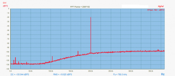

Finally I got to the duplex test, using Henrik's Rust WASAPI loopback example wasapi-rs/loopback.rs at master * HEnquist/wasapi-rs * GitHub modified for exclusive access.
Attached is clean spectrum of 350kHz signal generated on RPi at 768kHz/2ch/32bits, captured through MS UAC2 driver on Win10 by the loopback application in Wasapi exclusive and played back to the RPi via the same UAC2 driver again in WASAPI exclusive, to be captured and "spectrogrammed" on the RPi. Duplex operation at close to maximum UAC2 bitrate is bitperfect too.
