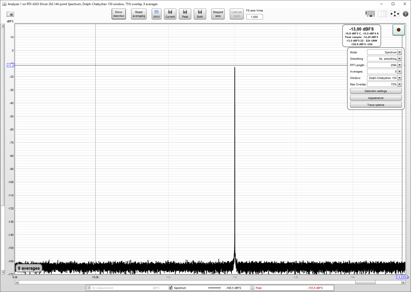

So far I don't see any problems with my design. The jtest measurements are fine.

As I wrote, I don't have the jitter measurements on the isolators available right now.Maybe you can enlighten us with the jitter measurements of you RTX stuff. We can then compare how much better results you have obtained.
I just made a jtest in REW on the RTX6001, with a loop back connection. I used settings very similar to yours to make it easier to compare (FFT lenght, window, averaging etc.). The result is attached.
I was merely trying to give my advice on what I think is the best clock concept for a USB interface. Feel free to disagree and design it the way you want.I'm not sure how to interprete this. Anyhow if you (or anybody else) have some suggestions on how to improve the audio clock distribution of STM32F7 SAI based implementation I'm more than happy to discuss further.
