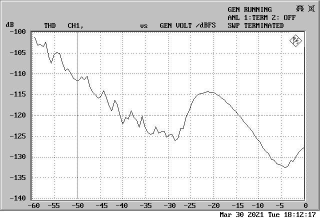

Well, i'm not sure if the famous ESS IMD hump is still present on the 9038PRO? but with your 20Vpp, your resistor/filter values should be more ideal loading. IIRC that was one of the fixes, keeping the first stage gain higher and then reducing the output in the second stage, vs lowering the IV resistor.
Well, here's another example about how much we can trust reports from various sources. And that nothing can replace your own measurements (if you can do them).
In despite of multiple reports that the THD/IMD hump in the ESS DACs exists only in the low(er) end DACs (ES9038QM2) and the ES9038PRO is unaffected (including on ASR, ESS THD ‘Hump’ Investigation | Page 6 | Audio Science Review (ASR) Forum and the following), this is not true. The ES9038PRO has the hump as big and fat as the other ESS DACs, see attached, this is THD, IMD is the same only, scaled higher.
X axis is in dBFS.
Now, let's see if the same method of hump elimination works for the PRO chip, I would think it will. Do I need to say again "**** ESS"?

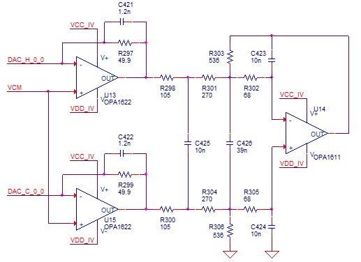

P.S. Simplified schematic (decouplings, etc... removed) for half the current IV stage is also attached.

The hump may be an artifact or interaction with the following analog stages, but I wonder why we don’t see this with AK4499.
I was curious to see if you would experience it with OPA1622 as I/V converter. I understand your rationale for choosing it here but it’s a bit slow to deal with some of the trash that comes out of the DAC linearly perhaps.
The hump seems like a result of noise out of the dac modulator on the analog outputs driving the opamps into some nonlinearity. Maybe RF demodulation in the input stages, or else slewing elsewhere. Adjusting component values may ease the strain on the opamps a little and allow them back into linearity. Just my two cents 🙂
Did a bit of surgery on the board and replaced the OPA1622 with an OPA1612 (which is a dual OPA1611) in dead bug position, also tried an OPA1642 and then an OPA1656 (I guess I now qualify as an "op amp roller"). These are much faster (3x) than the OPA1622. Absolutely no change in the THD hump with any of these. The hump has nothing to do with the op amp(s).
Also doesn't depend on the input signal frequency, clock frequency (from 100MHz to 12.5MHz) or sampling frequency (from 48KHz to 384KHz).

I don't think so. In fact, somebody on ASR pointed me to a bunch of ES9038PRO commercial products that do have the hump.
It is what it is, will try the counter-hump (I would not bet a dime that any solution doesn't come without some trade-offs), otherwise CS43198 is probably my next best bet. AK4499 is for 2022 (if that).
