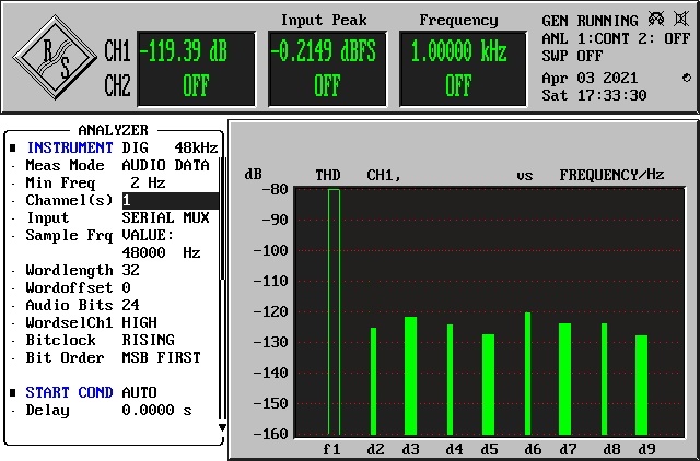

Forgot to add the digital loop results...
TNT,
The 'golden ear' comment was about hearing/not_hearing the hump.
My comment was about how clearly the datasheet explains putting the dac into synchronous mode. One setting turns off DPLL (jitter eliminator), another setting, 128_fs mode, allows the dac to run synchronously if DPLL is turned off. Also, synchronous mode works with MCLK at integer multiples of the 128_fs condition, even though they don't say so. :rofl:
Ok, this is the analog loop results; DAC output was attenuated using the ES9038PRO volume registers, to bring it in the ADC input range.
It happened I got slightly better result (see the attached screen shot), compared to the digital loop; but it is fair to assume both digital and analog loops are rendering about the same THD result -118dB or 0.00012%, and that without any extra filters like A-weighting, etc... Remember though, this is not at all digital and analog signal levels. Once again, runing the ADC and the DAC synchronously didn't make much of a difference in the measured results.
THD+N will be of course slightly worse, due to the ADC noise, I suppose around -113dB, not wasting time to redo all measurements for THD+N.
Everything would look fine, and I could go design the complete board and look into the analog part (attenuators, input protections, balanced/single ended conversion, auto scaling, etc..., which would be on a separate board) but... the ESS hump is there watching and killing the whole engineering fun. Not going anywhere until I'll sort out the hump, or decide to move to another DAC (I would not mind extra 2-3dB in THD at all levels, if it comes to that).
Just for the heck of it, I checked the results at the DAC input level matching the peak hump (see previous posts about); results are consistent, THD is -96dB, which is 22dB under the peak/optimum performance. This is a non starter for instrumentation 🙁.
My (another) conclusion: for digital audio reproduction, ES9038PRO is an amazing chip, the best one can get today, at least until AKM will resume the AK4499 and/or Rohm will finally start delivering the much praised BM94803 through the common distribution channels (not holding my breath for both, unfortunately). Since I have the ES9038PRO chips, I may eventually decide to design a DAC "for music" around them, and make the design available to the community, hopefully replacing those chines abominations, but that's not gonna happen anytime soon...

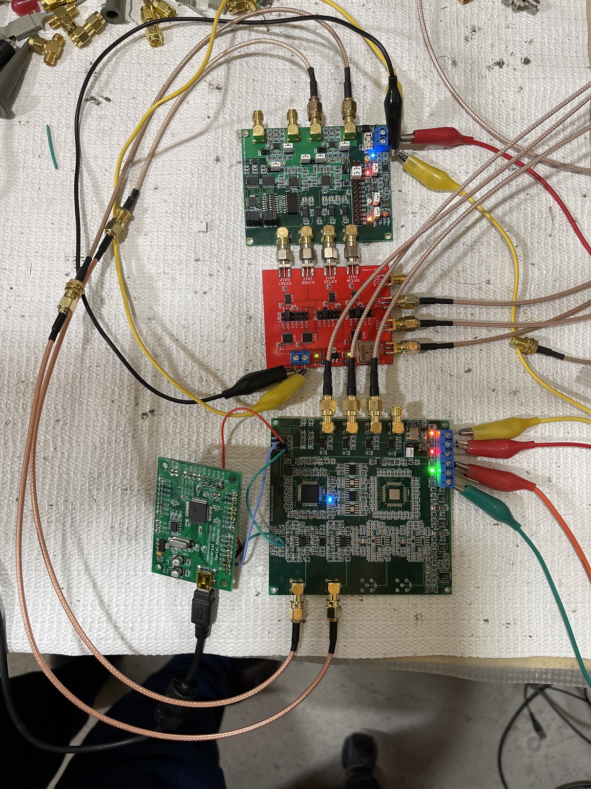

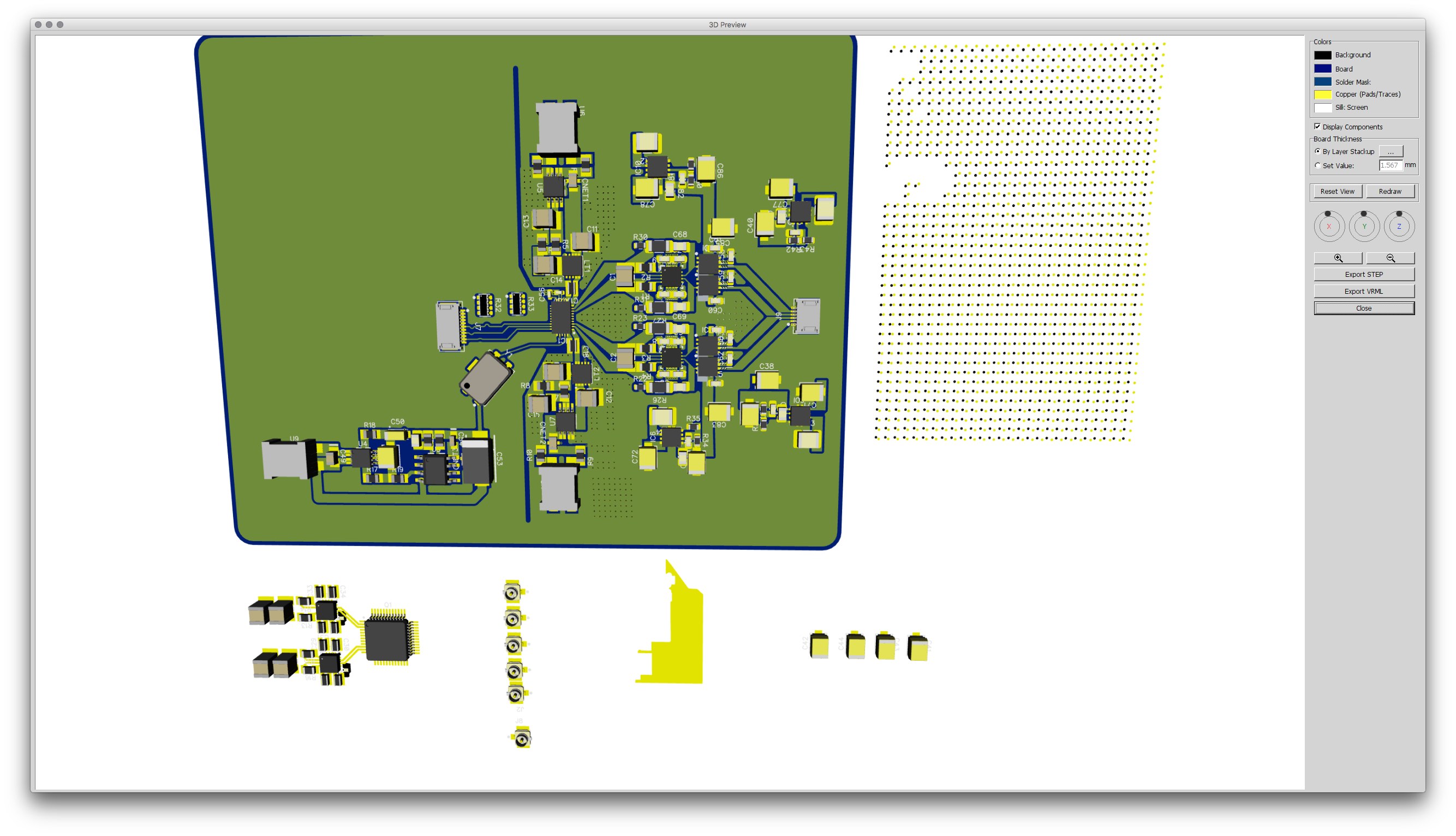

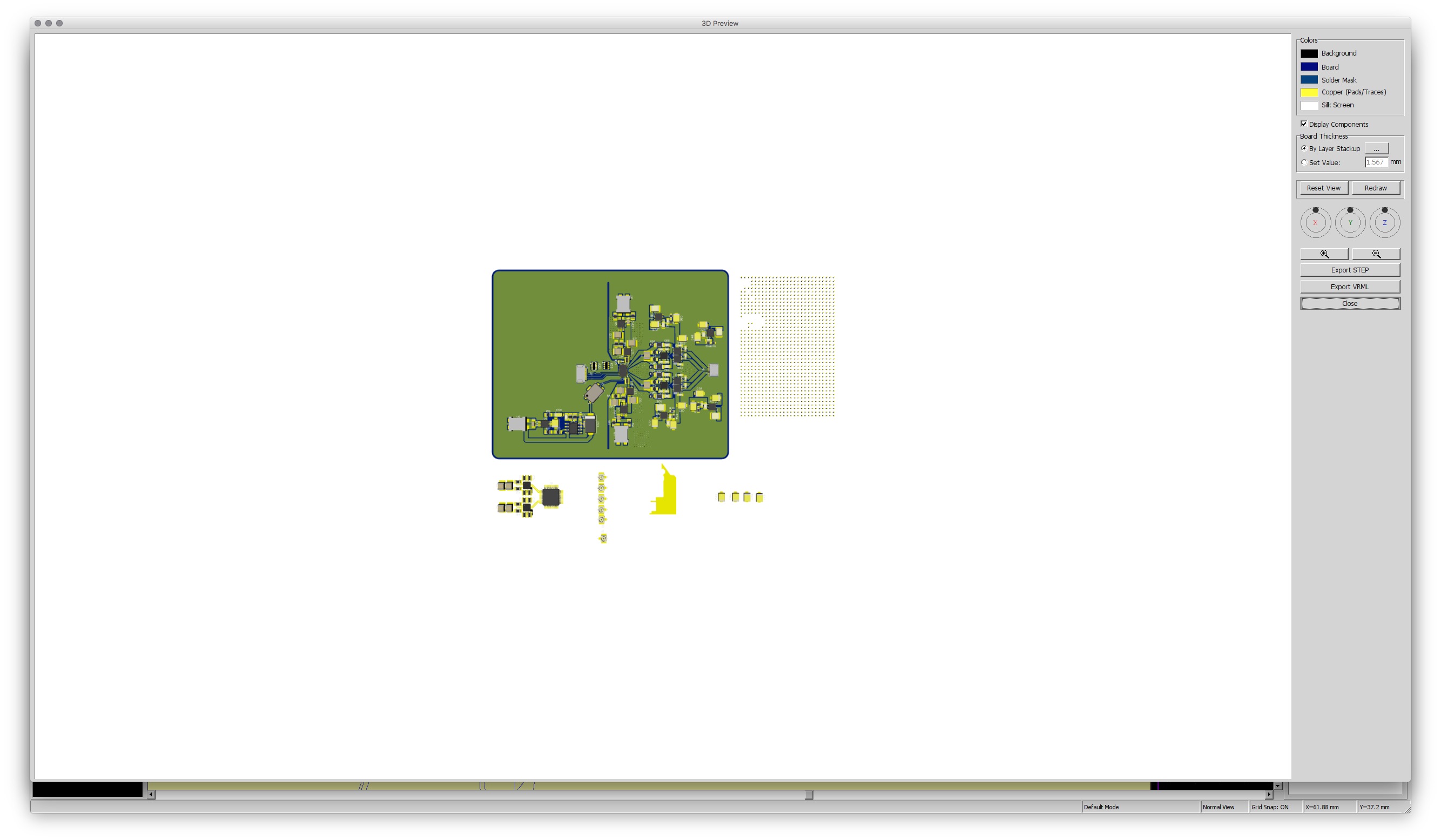

Well, lets see if I can do some parallel testing on 9038q2m, but with a 'faster' opamp in the IV position ... lol. I figured i'd play with this and look into the IMD hump on the way to the full multi channel design and perhaps the dac availability landscape will change along the way. I'm using the superbly specced THS series. with open loop buf634 buffers (also doing a spin with the loop closed) DC is trimmed (input common mode voltage) at the input with resistors to VEE-, with output CM level shifted to match the BUF634 VCC/2 if required, using VCOM. Should make a very nice little balanced headphone amp as well.
Let the opamp 'rolling' begin!! on that note, you might notice its not exactly a DIY/mod friendly board and as a result, i'm afraid I wont be supplying PCBs and a build thread/support 🙂 Ignore the digital (left) side, it's still in sketching phase and the power plane routing is not finalised. I will route a mux and clock, along with its regulator, but i'm doing a separate board with the clocks, logic and raspberry pi, with some isolation.
Anyway this is OT, just thought i'd chip in re IV stage 'speed' sending off for PCBs next week. it'll be a good test for my reflow oven jig. We'll see if I can get good results, or just hotplate and hotair.
the ugly grey chunks ar the XO and AVCC regs are common mode chokes. the STEP file ididnt come through properly into diptrace. regs are heavily filtered LTC6655 driven LT3042. clock reg is a fairly bog standard opa1611 buffered series reference (although I believe its defaulted to an LT1028 pattern, so its decomp pin is populated, that reminds me) and the output stage regs are LDO's from Ti. i'm interested to see how the THS perform compared to my old favorite, opa1632 FDA. They are well priced, so if they do well i'm going to buy a bunch, as datasheet specs are superb. There is also one of the ES9311 dual regs on the back (for VCAA_L/R). this will also be an interesting aspect of the process. I havent seen much talk of it, or its use on here.

I might have a couple spare pcbs though, we'll see how it goes. If someone feels confident with very tight smd layout doesn't to 0402 size (but primarily 0603 and 0805) but needs hot air or reflow of some sort, due to lead-less packages on everything.(down to 0.5mm lead pitch).

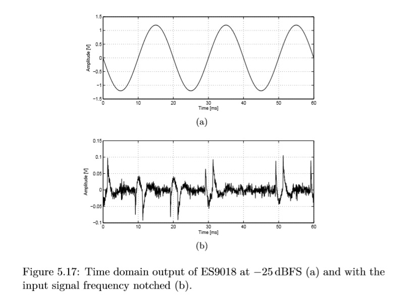

Scott Wurcer posted a notched-out view of what he said was hump distortion in an earlier ESS dac. Might be interesting to try that with the dac chip in voltage mode, as well as after each of the opamp stages.

While for the ES9038Q2M there's a clear solution to "eliminate" the hump in the IV stage, I've seen none for the ES9038PRO, in particular in mono mode (8 channels in parallel). The IV resistors are already 50ohm, lowering those doesn't seem to be a good idea, and anyway not sure if the same strategy would apply. Plenty of room for experimenting, but a solution is not obvious.
The cleanest ES9038PRO (2 x Mono mode) I've seen is the Gustard X26. Expensive product, but doesn't have a trace of IMD hump, and no trade off that I can tell.
Nobody cared to reverse engineer the IV stages, but based on some photos I've seen there's nothing outstanding there. Gustard had obviously support from ESS, I've heard rumors about the X26 using an external ASRC, the digital part of the X26 looks more complex than it should normally be, XMOS + CPLD + DSP chip + ARM CPU + plenty of memory, even with the Blue Tooth part implemented.
It would be very interesting to reverse engineer the X26, I may take that route if everything else will fail.
One thing was that reported a ASR to fix the hump was to change the reference voltage at the I/V opamps non-inverting inputs to something less than AVCC/2. IIRC, the info was shared with permission of ESS. Don't know if anyone had any success with it. However, sometimes dacs have been seen with with a reference voltage of AVCC/3 or so (again IIRC, original 2-layer diyinhk ES9038PRO dac, and iancanada dual ES9038Q2M dac come to mind).
Yes, I will be playing with input common mode voltage (its tunable on my board) and external digital filter, ASRC with local sync reclocking. I will expend some effort, because I do actually really like a well set up ESS dac, they are very capable parts, in spite of this annoyance. It is what it is; but it would be good to get to the bottom of it.
