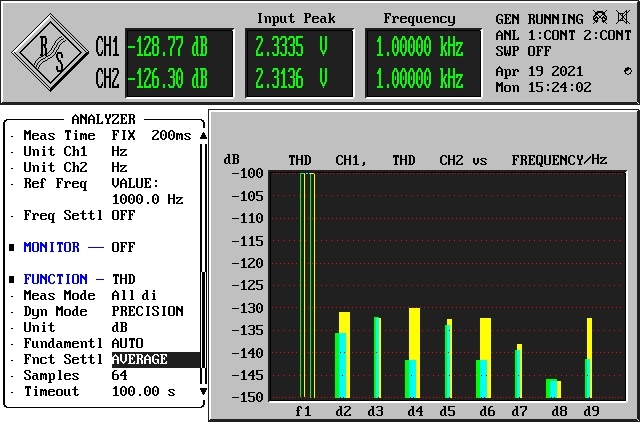

Thanks, it's a bit confusing, the author is showing only the 2nd and the 3rd, and doesn't seem to be able to drop the 3rd much under -120dB, which is rather surprising, could be he's using another ESS DAC, not the ES9038PRO in mono mode.
Otherwise, yes, I can drop the 2nd from -115dB at under -135dB (>20dB) as well. For whatever reason, my 3rd starts at -118dB with the registers set to 0, and from there it's not dropping as much as the 2nd, certainly not under -130dB (12dB).
Anyway, at the optimum point, of THD -128dB, 90% are upper harmonics, which are not affected by the correction.
BTW, the involved 16 bit register pairs are in little endian, of course the datasheet is mum about.

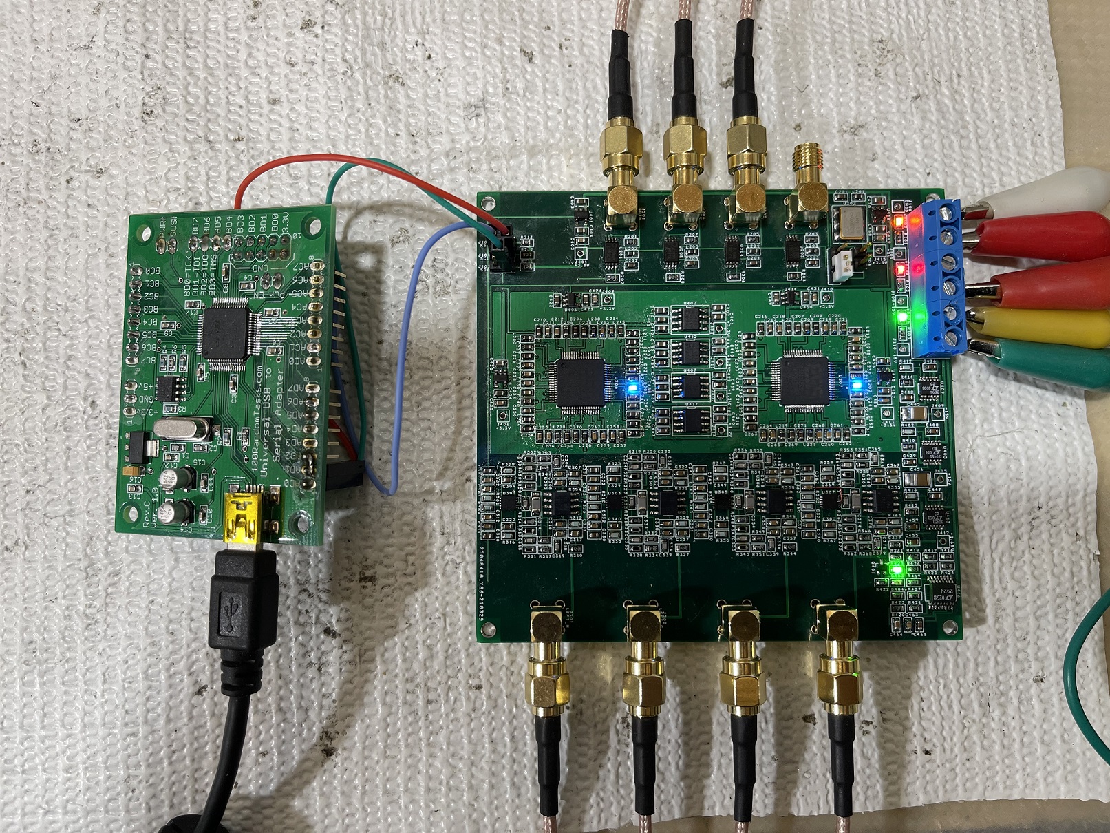

Revised board is up, with both channels running, results are good 😀 although I did not bother yet to get the absolute minimum from the 2nd and 3rd harmonic cancellation. To answer a previous question yes, the 2nd and 3rd harmonics are chip dependent, by using two different chips the THD went from -128dB to -118 db, then needed re-adjusting to some +/- 30 LSBs of the registers to bring the distortions back to -128dB or the whereabouts. However, the settings are less chip dependent than I was expecting, clearly the major compensation is targeted toward the I/V circuitry aberrations.
I think I found a bug in the OPA1622 data sheet (or possible I did not read the data sheet close enough). The EN pin is claimed to be logical driven (TTL, according to the level values). This proved to be incorrect; the EN level needs to be TTL high, but on top of the common mode voltage level; better to tie the EN pin to Vcc if one doesn't use the EN functionality.

I wish I could do that... Unfortunately my Rohde UPD has worse than -108dB THD residuals @20KHz, using the 100KHz analog analyzer. The Rohde UPD is pretty much the equivalent of a AP System Two but no match for an APx555 (having -122dB THD residuals @20KHz).
