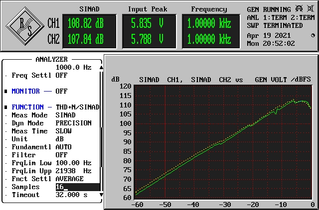

Power dissipation is huge... Two channels running @100MHz, at 0dBFS eat up around 8W. On +5V (used for generating all 3.3V 1.2V using linear regulators) it takes about 1A (100mA is the Si570 oscillator, 80mA the digital buffers, the rest are the ES9038PRO plus it's regulators) while the I/V stages (4 double OPA1622 plus 4 OPA1611) take some 3W. Can be lowered using some switchers as pre-regulators, but I could hardly justify the complexity... After adding top and bottom cooling ground planes, this thing doesn't exceed 60-70 degrees centigrade temperature.
This is the SINAD. Peak is 113dB at about -6dBFS, from there it's the UPD which gives up at very high input levels (confirmed independently). Extrapolating the straight line gives a SINAD @0dBFS of about 122dB, which is IMO a great value. And no hump!
I wish I could do that... Unfortunately my Rohde UPD has worse than -108dB THD residuals @20KHz, using the 100KHz analog analyzer.
